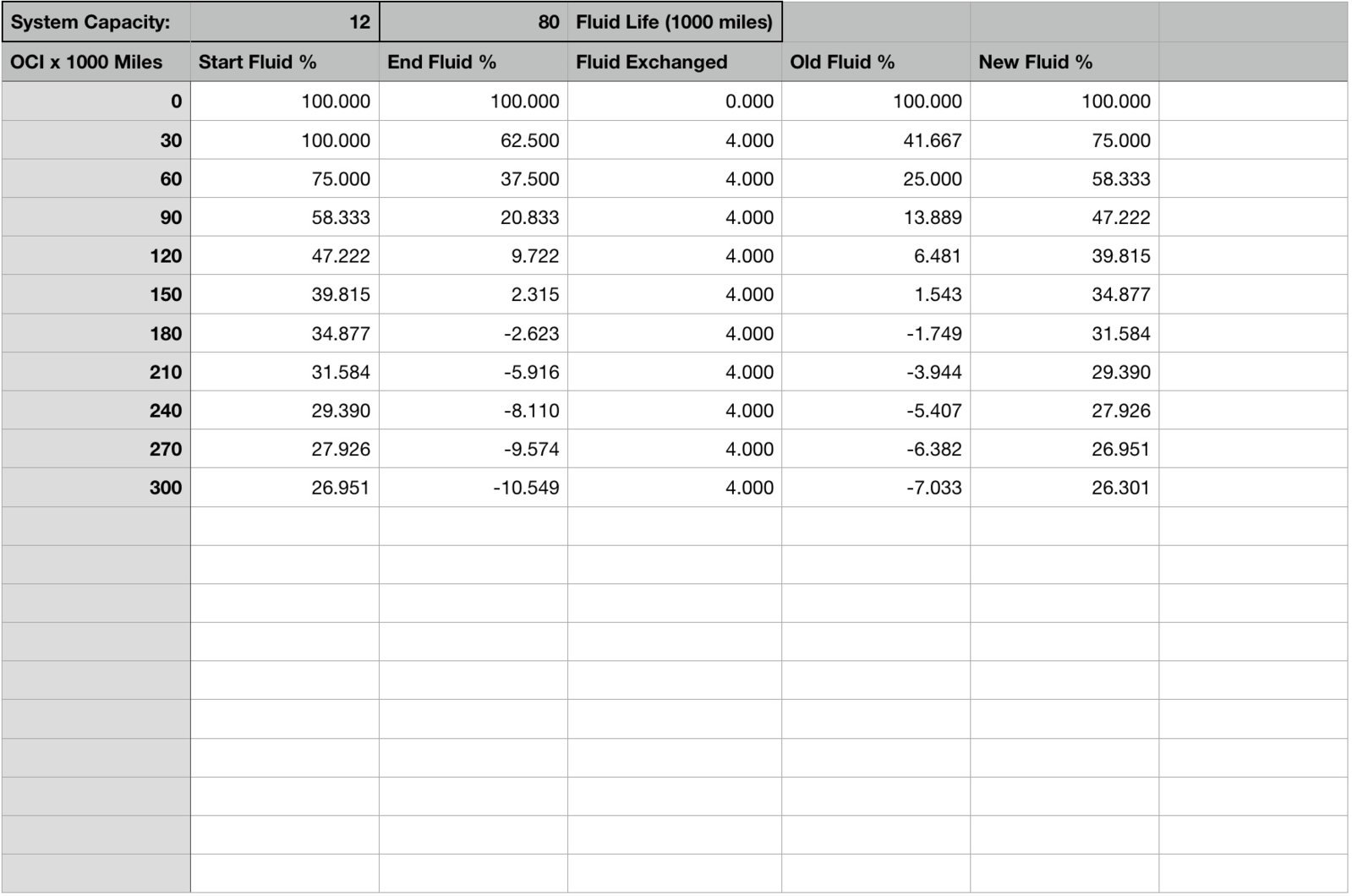

    Overkill?? Nope, not in my opinion. The parts guy at the dealership looked at me like I was crazy the first time I asked him for four quarts of ATF when I was around 30k miles on my truck. He almost didn't want to sell it to me, like I was asking him to leave in on the back step and look the other way while I threw in the truck in the middle of the night and ran. Now they are more than happy to sell me four quarts, no questions asked.
    Remember that you are only replenishing 25% of the fluid and additive package. If you consider 150k miles the life of the transmission fluid (I don't recall where I got that number, but it's in the cobwebs somewhere competing with 120k miles), at 30k, the fluid in the transmission has 80% life left. Drop four out of 12 quarts and you are left with eight quarts @ 80% = 6.4 quarts worth of additive. Add the four new quarts are you are 10.4 /12 quarts new fluid, or 86.6% "new" fluid. If you use the 120k mile figure, that puts you at 83% after the fluid drain and fill.
    As a reference, I had Blackstone run a UOA on my transmission fluid around 180k miles after six or so drain and fills over the life of the transmission. They recommended a drain and fill with every engine oil change for the next few changes. The additive pack was still good and oil viscosity in range, but the suspended wear metals were high (as expected in a high mile transmission, not necessarily indicating a transmission issue). So as much as we want to keep the ad-pack healthy, we also need to clean out the wear material that doesn't get filtered out like motor oil does. The only way to do this is with a fluid exchange. I had planned on doing as much and had a dozen quarts of WS ATF on the shelf.
    As an aside, I considered adding an external spin-on type filter to the transmission as well.
    As a second aside, I build a fluid life calculator spreadsheet real quick like. At 30k mile intervals, the fluid life has to be assumed 90k miles or more or else the fluid life will drop below 0% at 180k miles. So if towing, I would certainly do a drain and fill every 30k or earlier, and several in a row when getting up in miles.

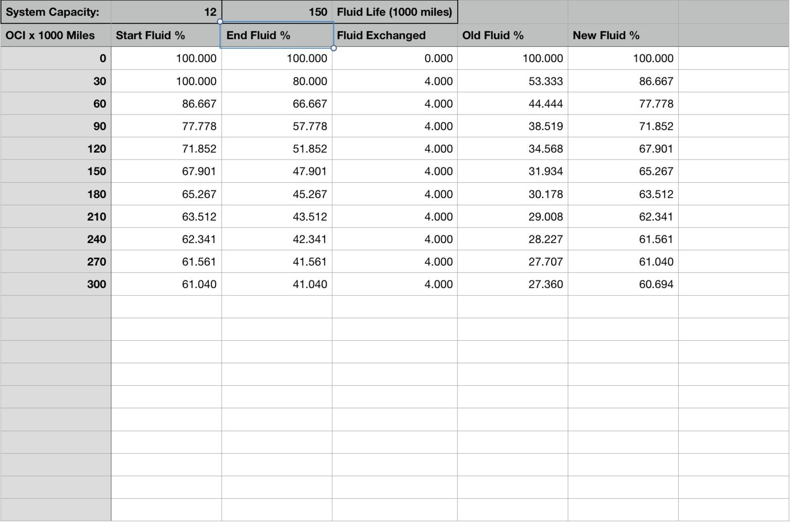

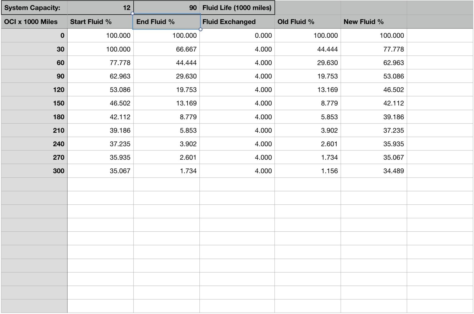

    If I am not mistaken, that 90k service is a full fluid replacement, not a drain a fill as is being discussed here. Most of us go by the Severe Duty Maintenance Schedule, which calls out an ATF service, whereas the standard duty service recommends simply checking the fluid at 100k. It is actually fairly difficult to qualify for the standard duty service (i.e. - you NEVER tow or drive down a dusty road or use 4x4 or drive it hot weather..).
    I tow weekly, BTW, and always have 400-1000 lbs in the bed.
    Agreed. That's why I was making an assumption about fluid life as that number changes due to vehicle usage. I'm 100% on the same page with the new oils relying heavily on the additive package instead of just being a hydraulic fluid to transmit fluid force.
    Here are a couple of quick fluid life calculations based off of 80k, 90k, 120k, and 150k fluid life assumptions. Or, in other words, transmissions that get worked hard vs those that live the easy life.
