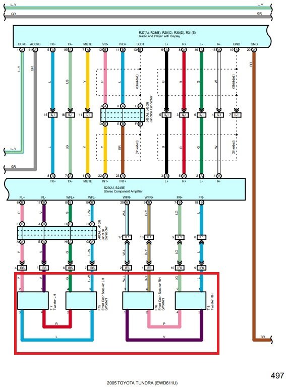

    Just to make sure….your rears still work ?
    As for your fronts, speaking of both left and right….did you put wire that came off + post of speaker to + of new speaker and other wire to neg. If one speaker is wired correctly and one not, there will be a noticeable problem...Bass hits harder when polarity is correct. It can distort when reversed.
    Proper speaker wiring hookup from 2005 EWD if it helps....

    Throw in new Android headunit and kicker dsc670 4 ohm speakers....ditch the back wall amp

    Well, your dead give away is this: If your front door mids weren't working before and after your install, then chances are the factory amp isn't seeing output in the front channels for those speakers. I don't remember if the double cab amp has that tweeter + mid wire separately or together (in series or parallel to create the right load)
    You say you installed an aftermarket head unit. I've seen a jillion stories of people losing the ability to fade/balance their speakers or not get them all working because they didn't install an amp bypass cable on their JBL sound system, or they tried to reverse-engineer the factory amp wiring, or they cut factory harnesses and cables trying to save money.
    Easiest way to diagnose whether you can test wiring? If your front tweets are working but not the front mids, get a small 3-4' run of cheap speaker wire and split it in half. To avoid causing too high a load on the factory amp, you'd run a series circuit to your new Kicker coaxial from the nearest front tweet.
    In plain English, run a single wire from the negative (-) terminal of your door tweeter to the positive (+) terminal of the mid. Then run from the negative of the mid (-) back to the positive (+) of the tweeter. Do you get sound?
    If it works, it may sound sound funny because of how your coax mids are cap'd off, but if you're getting sound that way one channel is getting sound, the other isn't. Or you did something stupid, like cutting the wrong thing in the door because you didn't realize the tweeter and mid are actually part of the same wiring circuit.
