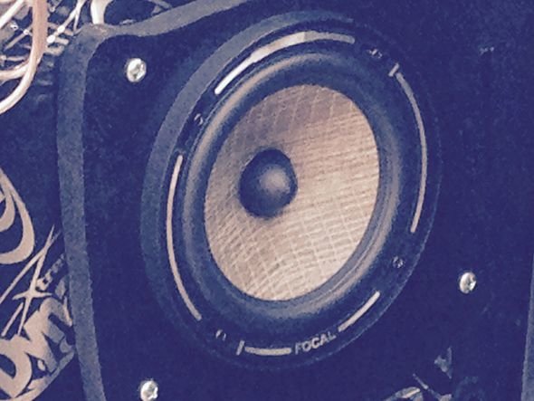

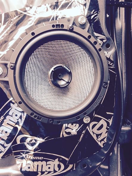

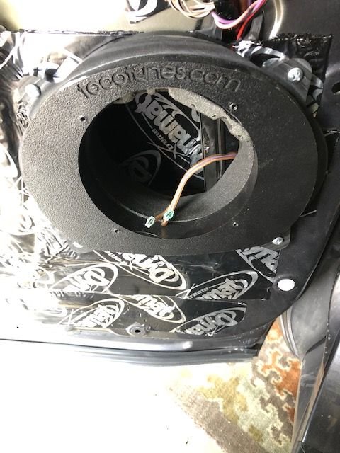

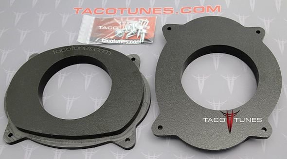

    The right adapter and they will fit.
    It's the only thing I would buy from Taco-Tunes, but they make really nice thick adapters..
    You'll have to google to find them, TT links can't be posted here.
    Toyota-Tundra-6_5-6.75-Speaker-Adapter-H_7f1df10eedd519b2bbc9772295d83009202c7587.jpg

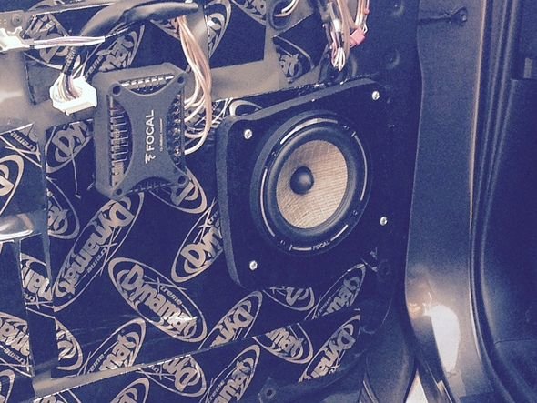

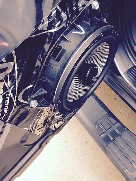

    For my rears I ripped out the stock speaker and used the OEM bracket.
    Probably should have bought an adapter..
    D470B1E9-862B-45C9-AD11-BC86D3147A51_zps_9d6ad8b6dc9c5d01fe7051eefd6c47752184139a.jpgC69F30A1-305D-4183-AAAF-7C8763CEDAAB_zps_3efd59ef0d570c045e28a527c1fe39b2a2987eef.jpgDBC6ABDD-3326-4B38-9BD4-21DCA4A06E84_zps_6298f513a699655a5ca4f4e9b1d6687e8451ad1b.jpg

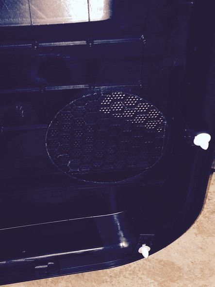

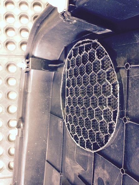

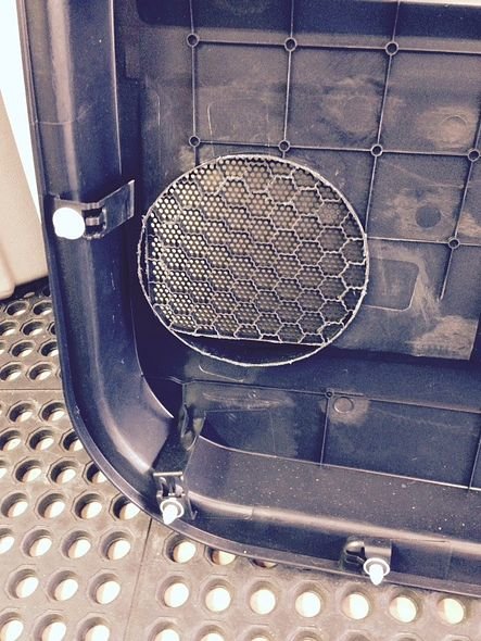

    You might need to trim the door panel a little if they won't clear the new speakers..
    6F4ADDA1-A2C0-4399-AC23-E0C91A22CB34_zps_34599a3ab31fad20e30521dec378b9df2bd7d395.jpg88DEA43C-D7A4-4B94-831E-DC3791710664_zps_caa1341ebf16be4f6d5280e086f21d7ad41fdadd.jpg62FB5BE0-4A05-4F42-BE9E-AA50E269F7A9_zps_9ec91d3c1259a5cc4912f07b20dde003aa78cb93.jpg

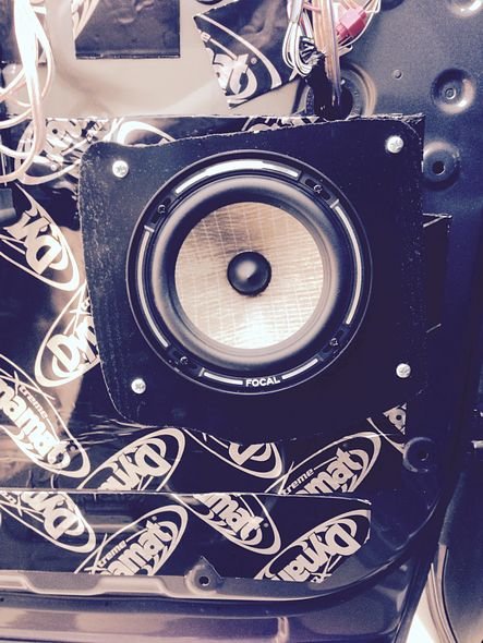

    For the rears yes, I think.
    For the front no.

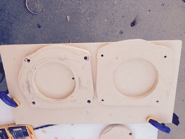

    I could have with the TT adapters, but I had previously made my own adapters out 1' MDF and used bigger screws.
    Even being painted the MDF started to absorb moisture and and flaking apart.
    I then bought the TT adapters.
    C68B9DC8-2E83-400B-B170-D8D98D32D3FF_zps_74a239c7e66c5e656e7c4427f42333ec755372bd.jpg
    43A85727-0BAB-4627-9E77-856E38144C8A_zps_45425bdb1f63d0b852f240913ef5ce408cd32705.jpg
    57AC564D-139F-4845-B88F-D8D78BB7884E_zps_e56adccca2884f85f9989cbc8f750e21cf194239.jpg
    If I had it to do over again;
    I would have run the extra wiring and put the crossovers next to the amp under the passenger's seat.
    43A85727-0BAB-4627-9E77-856E38144C8A_zps_e9209874d27112cb72e8d29ed70cb6aa38525590.jpg r7df2zr7_zpscoegh5fw_5b9ee9ff3dda2a7e9288e8d1deeba961b11f2612.png
