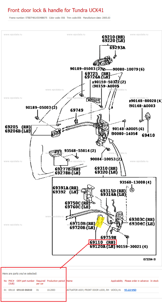

    I pulled a random 2005 V8 DC Limited VIN from the internet to find exploded parts for your truck. I came up with the image below, and I see the door lock actuator - the actual electronic plunger that fires off to pull the lock lever - is sold separately. The part for the RH (right hand/passenger) side is: 69110-06010 and the diagram makes it look like there's only one bolt holding it in, and I'm sure it's wired with either a 2-wire or 3-wire snap on/off harness.

    PS - I would personally go OEM on this one, general rule of thumb with electronics; get OEM, it'll last another 20, get aftermarket, you may get a couple years out of it. This has been the experience with others on door locks and window motors.
