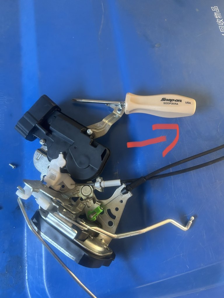

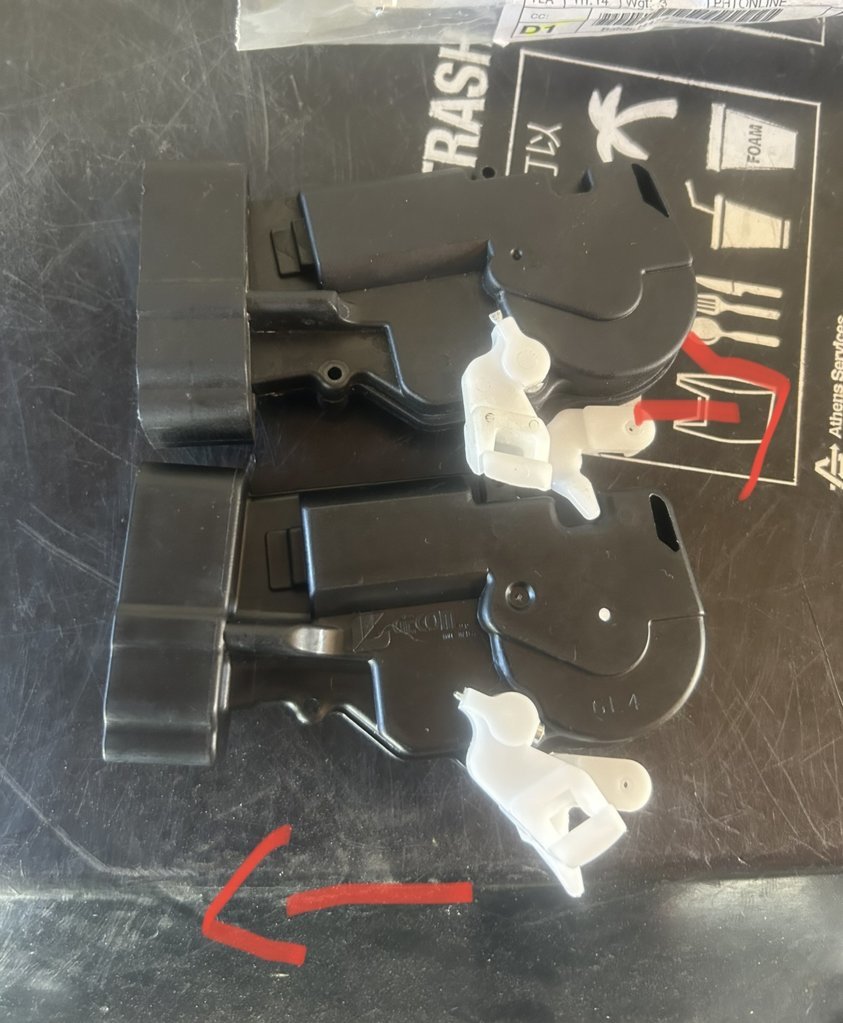

    I’m am now faced with a new issue on my Sequoia. My power door lock actuator decided to kick the bucket. Ordered a new one, and it’s not working correctly out of the box. Let the dealers parts guy know, he got me another one, same thing. Now I’m on my third, gotta unwrap it, it’s been weeks now. What happens is, when I press unlock to actuate it, it locks it instead while all the other doors unlock as usual. I ruled out that I assembled it incorrectly. The FACTORY motor “kicks out” to the RIGHT to unlock, I’ve never had an issue with it until it gave up. The NEW one “kicks out” to the LEFT when I press unlock, this is what causes it to lock instead. Dealer parts guy was apologetic at first, but now shop foreman is getting involved and now I’m getting the blame for installing it wrong. I even got the one for the passenger side, but that one doesn’t fit at all on the drivers side, so I ruled out the possibility of it being for the wrong side. ATP I am thinking of just going aftermarket, but I feel even that’s gonna be a crapshoot. Any ideas?

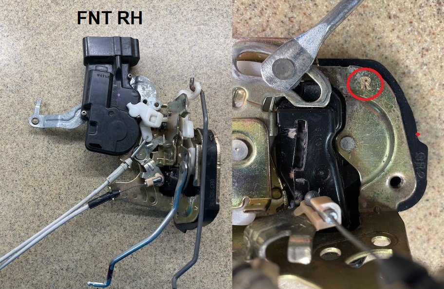

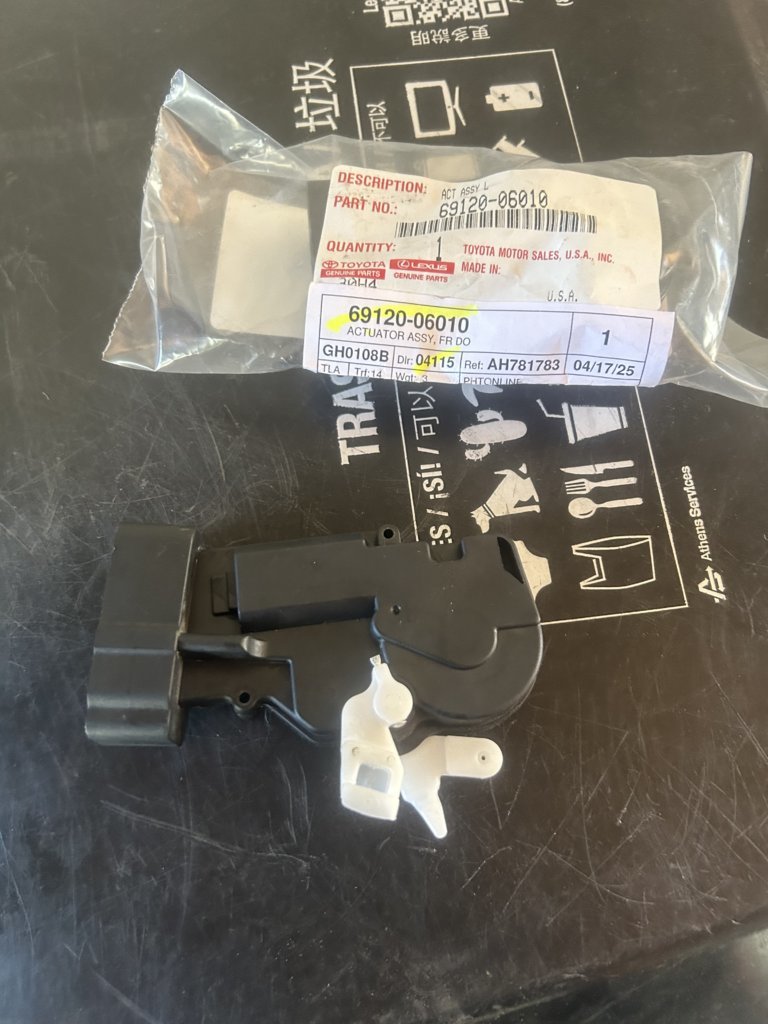

    RH can not fit on LH nor vice versa. The part # 69120-06010 on the bag is indeed part for FNT LH for various year Tundra/Sequoia according to Ourisman Toyota..
    The below is my spare FNT RH from few years back showing R for right hand. Should be an L on @literallyme actuator.

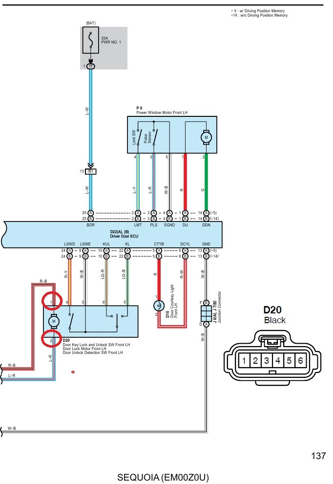

    Wire drawing in case you need it @literallyme
