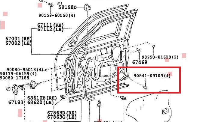

    Tailgate bumpers are p/n 9054111015 with the older part number having a dash like 90541-11015
    The door bumper, assuming it's the same on all four and you agree it's the one shown in the pic shown below, is 9054109103 or historic p/n 90541-09103.
    You should be able to order these parts at a discount through https://parts.toyota.com for pickup at the same local dealership who said they couldn't get them. I suspect they were just to f'n lazy to look it up or didn't know how. If you need to have them shipped, you can order online with no tax from Serra Toyota of Decatur's parts site. If you order more than $75 worth, shipping is free - so you may want to include oil filters, pan washers, or anything else you like for maintenance. OEM air and oil filters stomp the shit out of aftermarket brands.
    Here's that pic of the bumper with p/n 9054109103, confirm it's the right part based on the location in the pic.

    Shifty thank you, I have looked for these for weeks now thank you very much, and yes, my dealership here in Morristown TN is lazy and will only talk to you when you have your checkbook out. Thank You Randy
