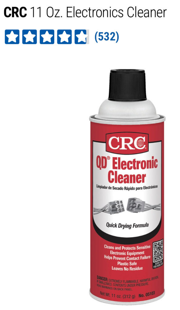

    I took both fobs apart and just pressed the actual button. I also squirt penetrating fluid around all button switches. Maybe module is going out. Thanks for your help.

    I’m not sure what you mean by penetrating fluid but sensitive electronics should be cleaned with something like this.
