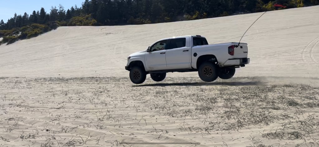

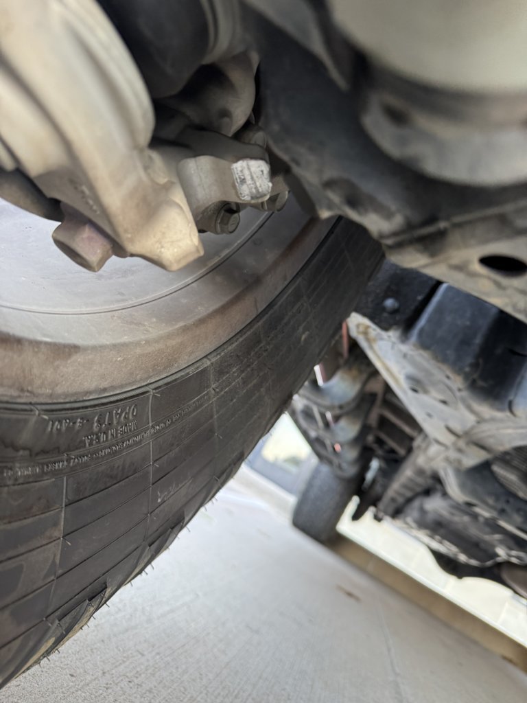

    I have stage 7 Icon coilover setup with 37in tires. I jump the truck going 40-45mph and bottomed out and it cause front steering knuckle damage.
    what can i do to prevent this happening again??? Any suggestions???

    First, doesn't look like anything is wrong. Looks like your steering stops have some marks like they all do.
    Second, get better/larger shocks and good bump stops like hydraulic ones and it'll be able to jump without issue.

    That doesn’t look bad, mine are worn similar from daily driving. I want to see the video of the jump.

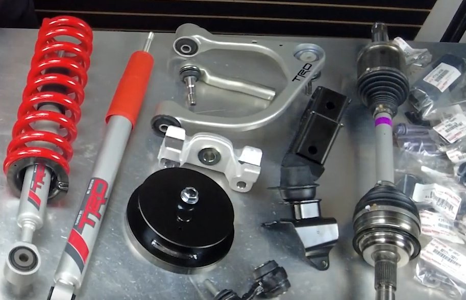

  12. Jan 4, 2025 at 10:00 AM
    Ryuu
    Ryuu Hwat!?
    Apr 23, 2018
    #14693
    881
    Oscar
    SouthEast, TX
    2017 TRD PRO Barcelona Red
    a few
    Looks like regular marring of the steering stops from daily use. Seen it on quite a few new gen tundras that get 2"-3" lifts.
    Icon does state in their install notes that either a diff drop or the TRD extended axles are a requirement but that probably more just to prevent damage to the CVs.

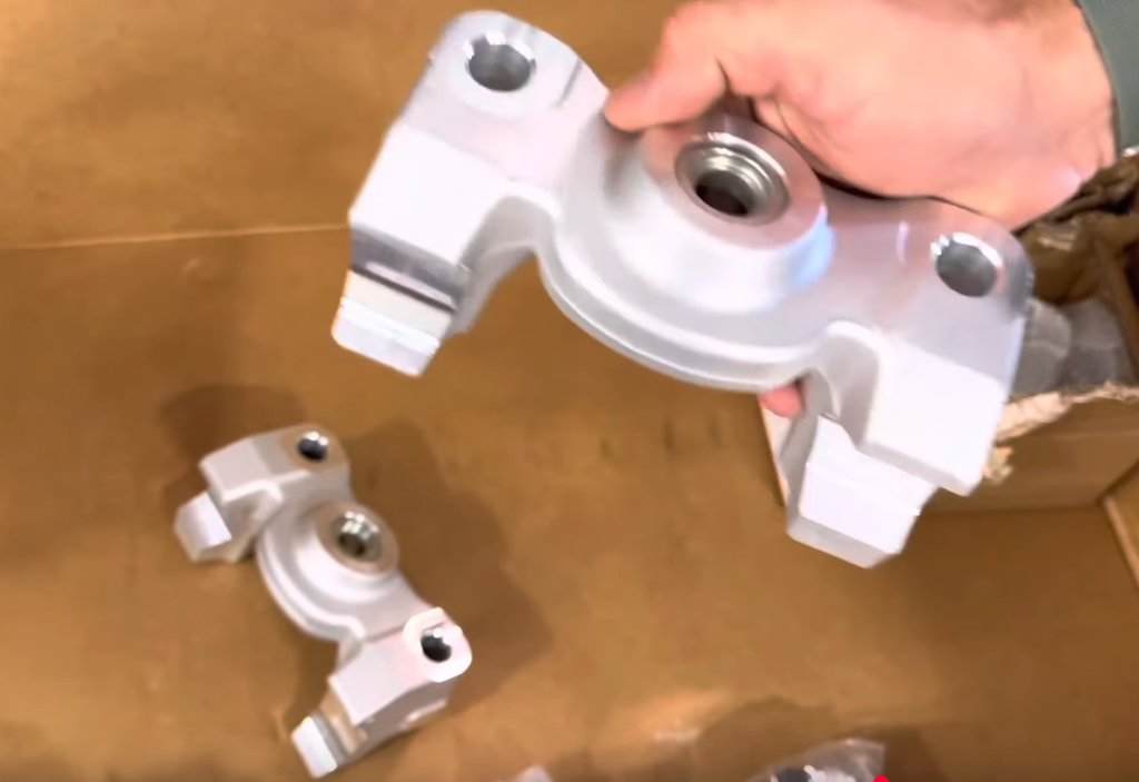

    More than likely why Toyota includes new turn stops/balljoint brackets for the steering knuckle in their TRD lift to account for changes in angle and geometry, but that's more of an assumption. Heck, the steering stops on my 17 have marring too from daily use.

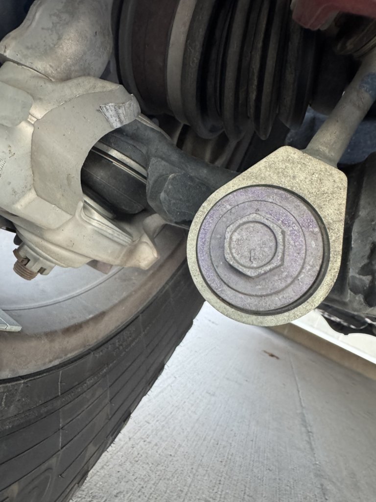

    This has been discussed before and it is not from "jumping" your truck.
    Its is because the lift changed the suspension geometry causing the swaybar links to hit your knuckles at a different angle when fully turning the steering wheel. Some people have cut those off.
