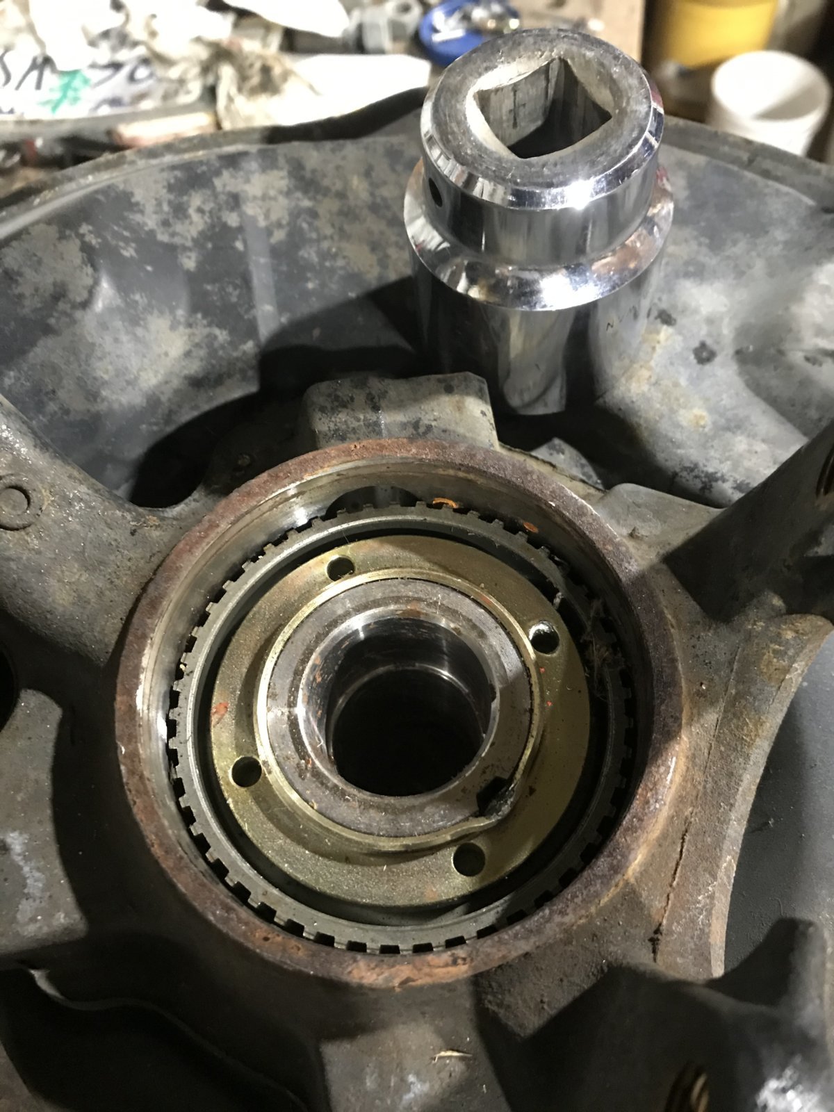

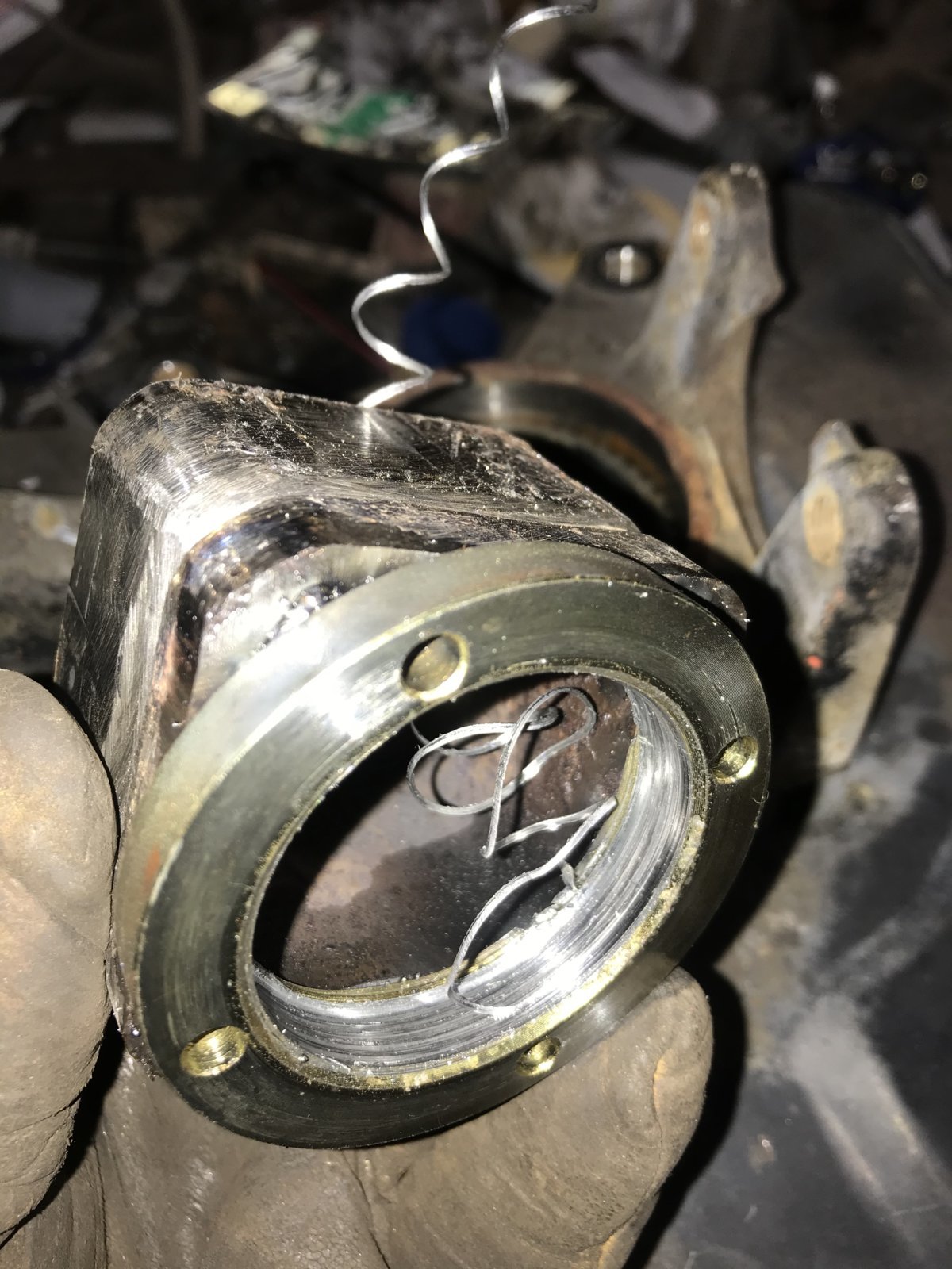

    I read a bunch of reviews on the OTC 4 pin tool, and the reviews were not good. Many, many, many reports of the pins on the tool sheering off. I wasn’t planning on reusing my 2wd spanner nuts, so it didn’t make sense to spend close to $100 on a socket (that would break anyhow). My advice to the OP is to spend the extra $$$ on a high quality socket!
    Just to give everyone an idea of what it looks like, here’s a pic of the 2wd hub nut when it is torqued down properly.

    Yep. Can confirm. Spent $20 for it on scAmazon. Sheared right off. Lololol. Ended up having a local shop remove and install the bearings into my knuckles for me instead.
