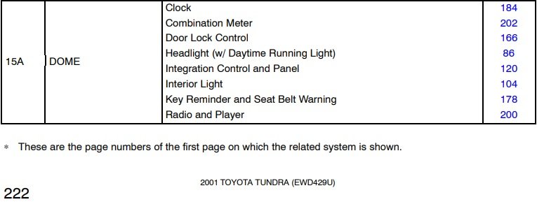

    On his 2001, quite a few things according to the 01 EWD !

    Dome fuse is misleading if it's all that stuff. Should be called light and accessory fuse. I'm willing to be an aftermarket alarm would be tied into that circuit as well.

    Thanks for the documentation check, @BubbaW!
    Yup, this would be common. If @Beagledogxxx really wanted to know if it was the dome light causing issues, just removing the bulb would break the circuit and kill the draw. If not, going through the list of items in Bubba's post would help. But before I went through the trouble, I'd start rooting around under the dash looking for an alarm brain, because this stinks of the kind of draw an alarm would cause.

    Great to hear of the other accessories covered by that circuit. Huge help there...thank you. Zero alarm system, draw exists with bulb in or out and we're talking in the neighborhood of .24 or 240 milliamps. Way over the .030 normal threshold. Thanks again folks. I'll get to checking the other items
