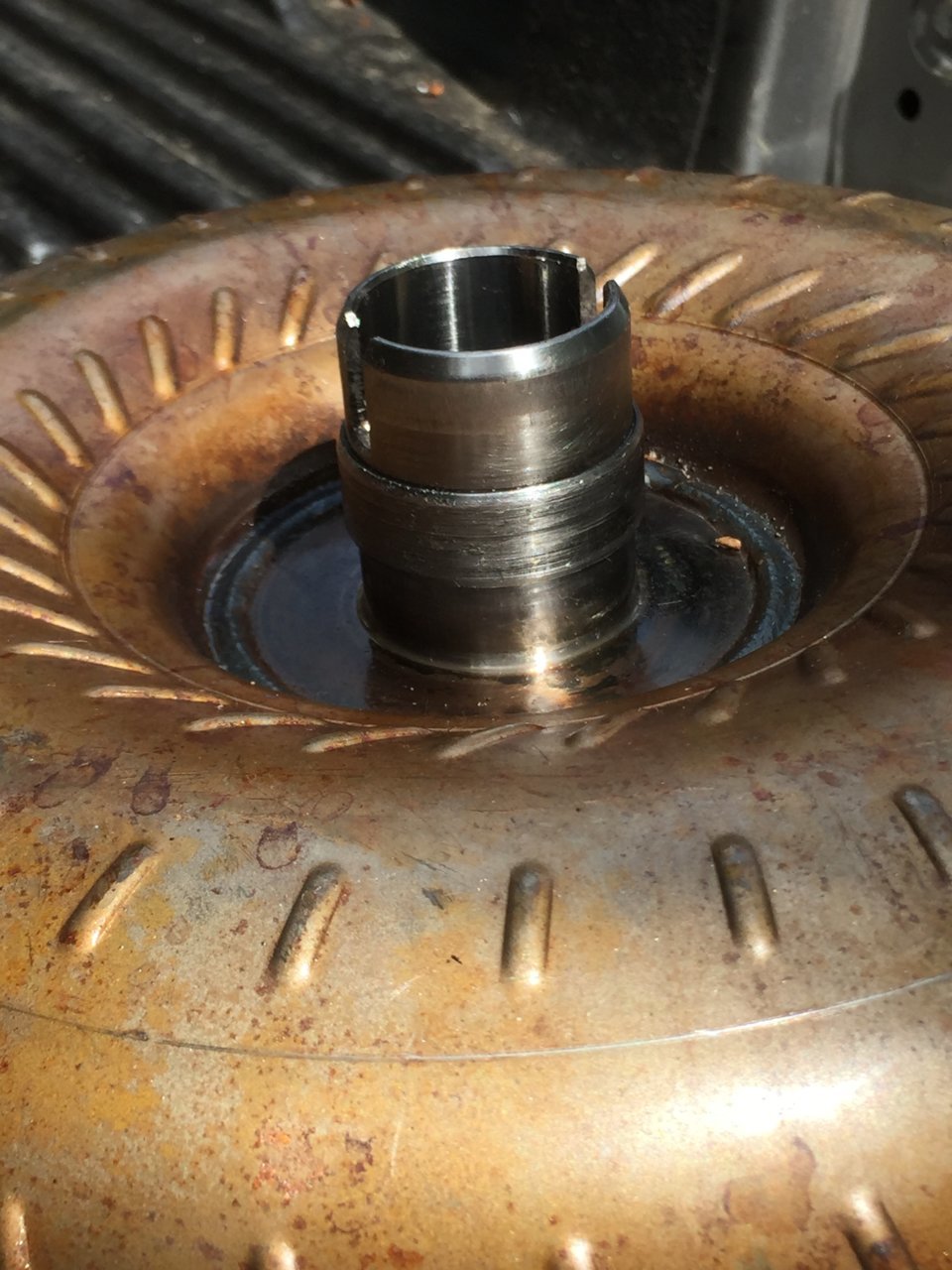

    Newbie from MD asking for your opinion.
    2003 Tundra 2WD Automatic 3.4L
    Transmission input shaft seal leaking like crazy. After taking down the transmission and pulling out the torque converter and stubbled upon this.
    The ring around the torque converter shaft. Is this normal? Feels like it’s been rubbing.

    Update : turns out the answer is no.
    Bad torque converter and also bad trans pump. The ring around the converter - belongs to the pump. Problem solved. Smh

    Some.
    Glad you figured out that it is not normal.
    It is the input bushing.

    Yea that ring is the Pump Bushing so your pump seal and maybe even the pump body could be bad that happens cause it over heated definitely inspect transmission internals before putting a pump and torque converter in it sucks to do the job twice
