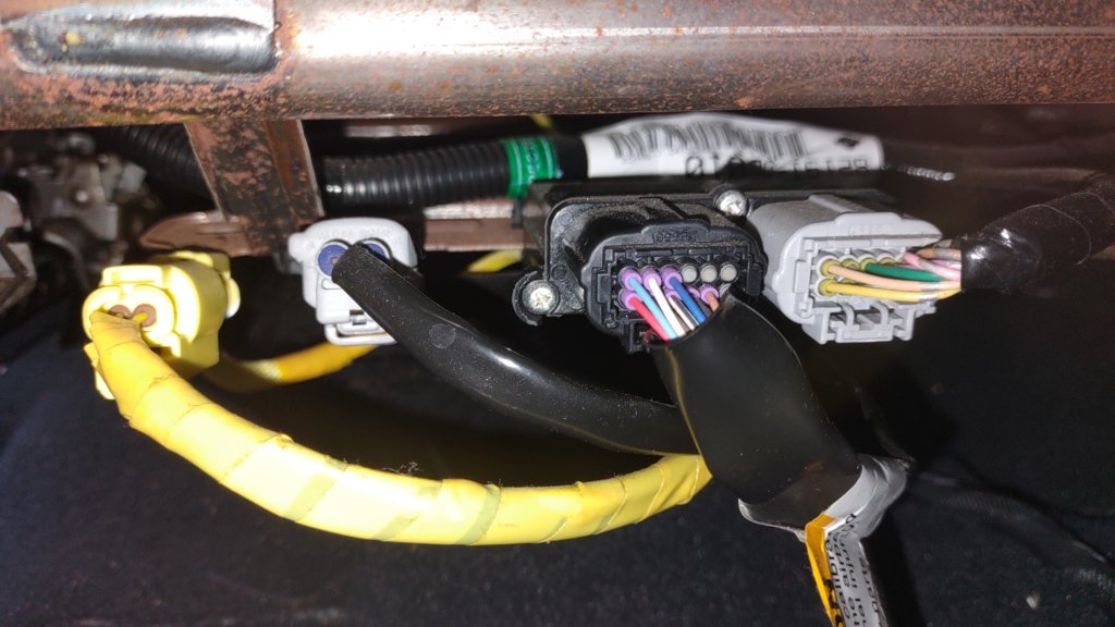

    I also have a base level 2012 Tundra (with the Texas package added). It seems like the wiring under the passenger seat is for potential power seats in the future (heatingcooling as well). Not sure if any of the wiring under that seat has anything to do with the amp leads. I installed an android head unit that I thought would resolve the speakers not working right. Same thing after install. I got full sound from passenger door and a little from the dash, and no back door sound at all....... I am guessing I will just be adding new speakers with new wiring to ensure everything works.
    I am hoping that someone who has gone through this already will share their wisdom. I snapped a picture of the wiring from under the passenger seat.
    I will most likely buy the Kenwood set which fits well based on some youtube videos.
    https://www.amazon.com/dp/B07R8WV1YD/?coliid=I66TA7ZGSTZQB&colid=2IA68C7OVMVS1
    Anyone used this set?

    I installed the Kenwood set from Amazon. After installing new wiring from the new head unit, everything was good. I didn't do the back doors, so in the future I may need to rearrange things.
    I should have tried to trace the wiring and look for a short. The way this stock wiring works, is the head unit sends signal to the dash speaker, then from there another line goes from the dash speaker to the front door speaker. So if any part of that series has an issue, then neither speaker will work. There also could be a small amp hiding somewhere, but I kind of doubt Toyota would spend more money for that.
