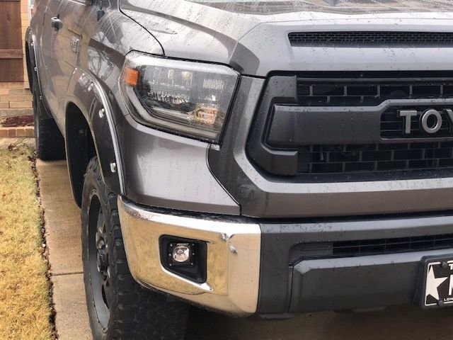

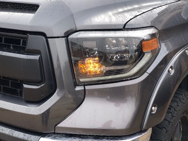

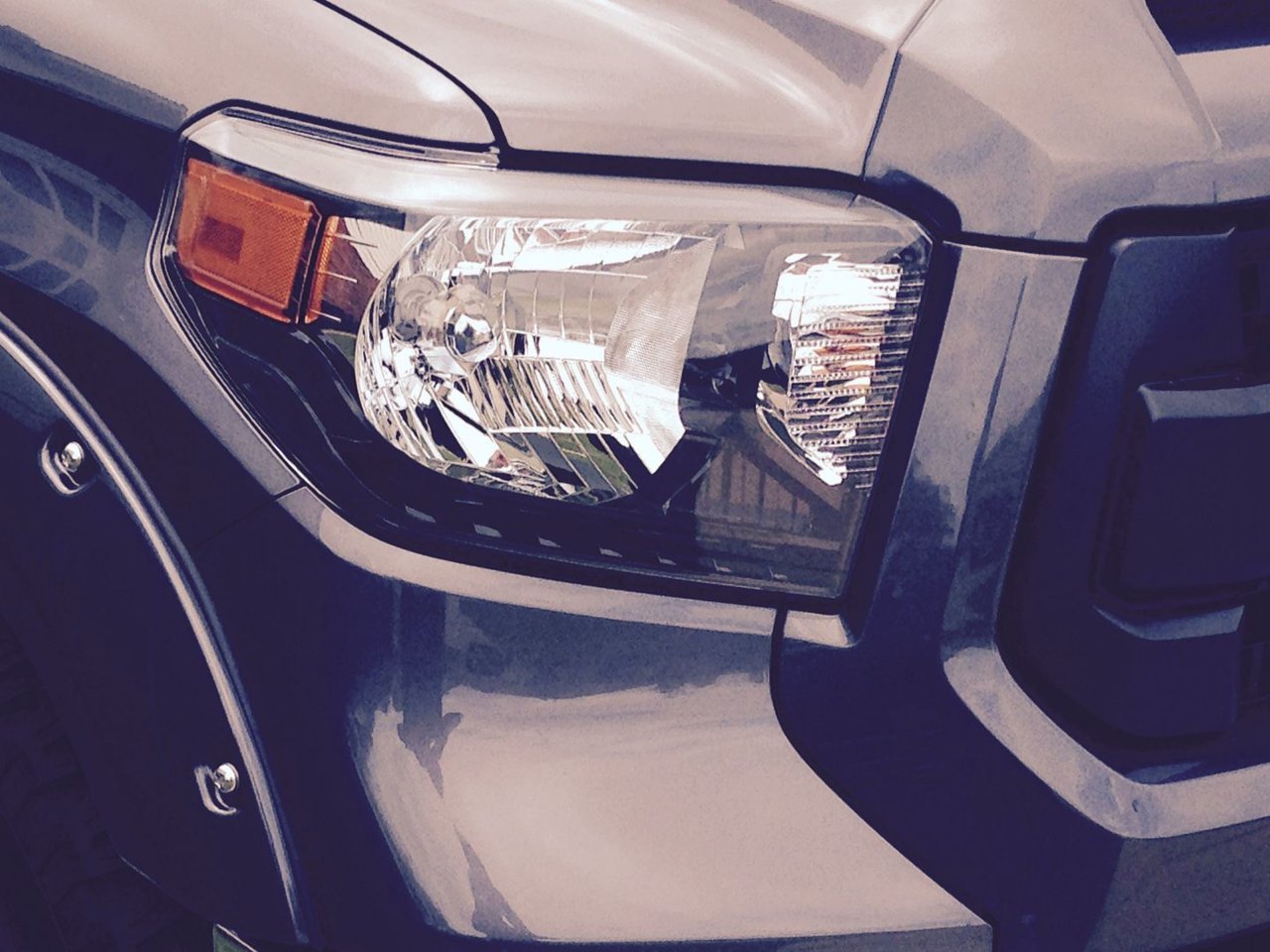

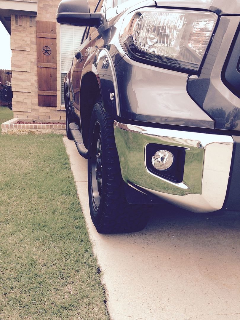

    I got the blacked out TRD Pro headlights from Sparks.
    Search Results | Sparks Parts
    I think the @iHacker harness I used was a little over $100..
    Well worth whatever I paid for them.
    Difference over the halogen bulbs is literally night and day..
    All depends how much it is worth to you.
    I wish I'd done it 2018..
    Not only do they work better, they look better..
    I also had the TRD Pro halogens..
