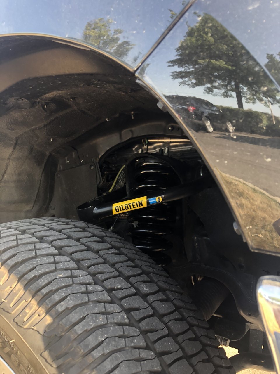

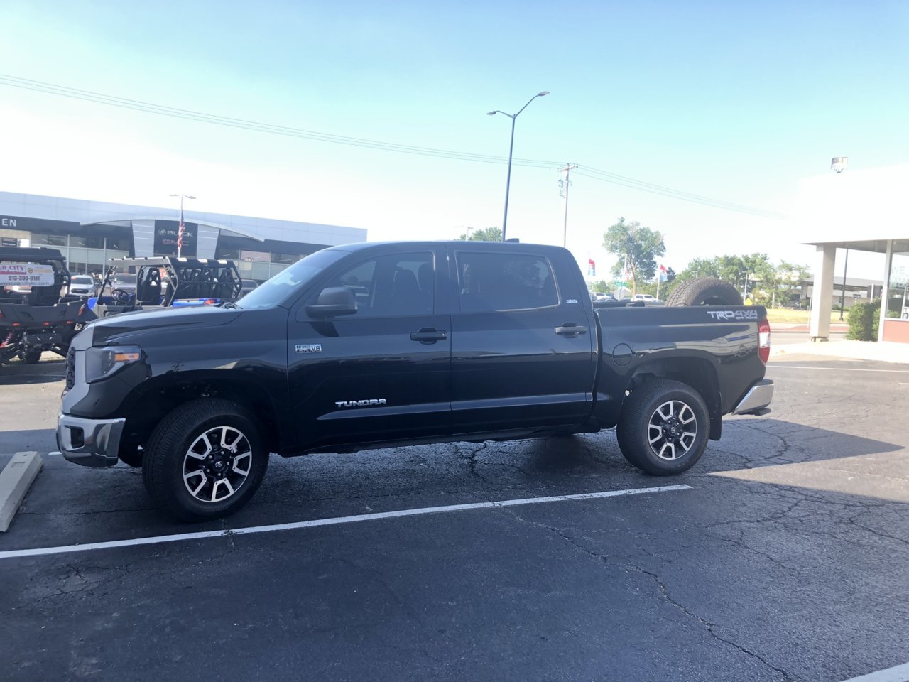

    Old thread but I have pix for others that may search this topic.
    I don’t recommend this combination of Bilstein and OME. I ran it for 10 days and replaced it with Icon. First, it was advertised at 2.5 inch in front. It was over 4 inches. That is too much. The UCAs were at terrible angles as were the CV joints even with a diff drop. It drove terrible even when the alignment numbers were all green.
