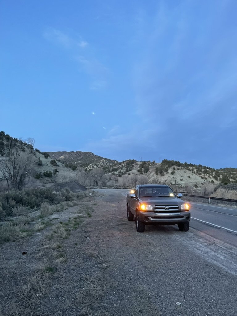

    Well I should preface this by saying that I'm not positive it's the alternator, but that's my diagnosis. Lost power out in the boonies going up a hill. Was quite the adventure getting back to civilization.
    Everyone loves photos:
    Got me thinking, should I have just replaced this after a certain number of years or miles?

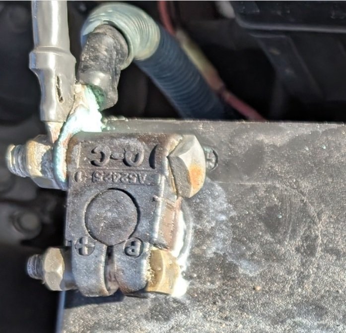

    Neither time nor miles for me personally, even going back to my younger years of maintaining all my other vehicles. Speaking of 1st Gen only, they just keep going and going and going.
    Due to age of my 04, I have bought both starter and alternator because of the NLA factor. I also bought kit for starter, mainly for my grandson to have when my time is up so he can re-build original if he wishes.
    Where many folks fail is lack of maintenance especially to batt cables like below. Corrosion and especially that much can eat it's way further and further into conductor, which can definitely affect longevity of starter or generator/alternator.

    When I bought it, there was significant corrosion. I cleaned up the terminals and bought new connectors and put some grease on the terminals too to slow down the corrosion.

    Felt washers. Felt washers with dielectric grease on them and on the terminals will stop 90%+ of battery emissions that typically cause corrosion. They cost virtually nothing and will save tons of grief.
