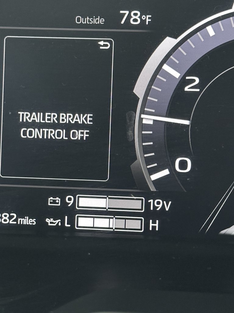

Does anyone have any idea how to fix the “trailer brake control off” problem? No one seems to know.

    It is my first tow. It won’t let me add a trailer because the TBC is off. I’m stumped. I just took it up to Toyota and they couldn’t figure it out. So I have a appointment to take it in on Monday.

    Yeah, there is no TBC option under settings. It’s all under trailer settings “add a trailer” and there it just says TBC turned off and won’t let me add a trailer.

    Yes. Have tried it with and without the 7 pin hooked up.

    Yep. All the trailer lights work normal.
