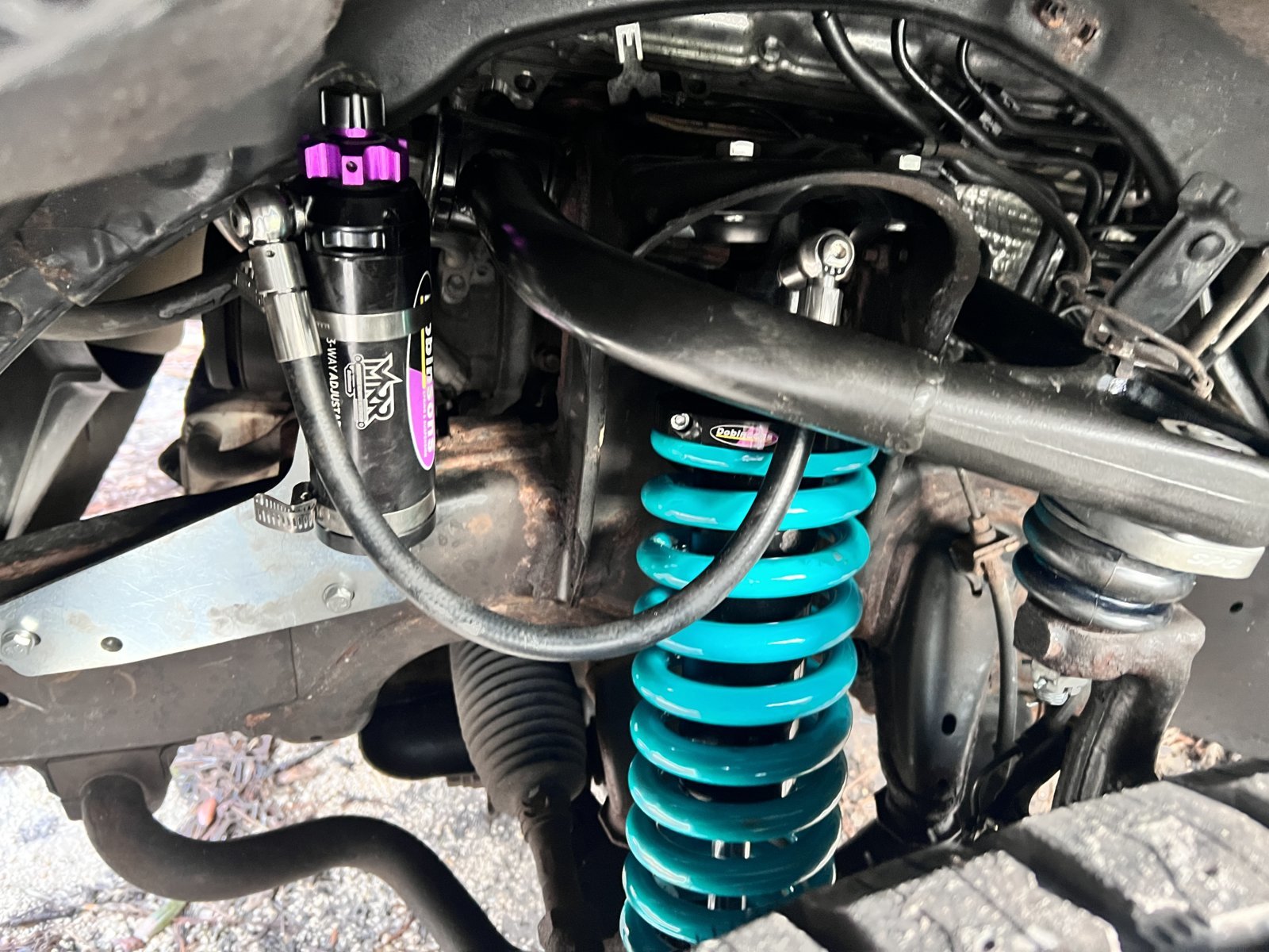

    Hey folks just finished my install of the complete Dobinsons MRR kit. I’ll post some more pictures and let you guys know what setting I’m running after I dial it in.

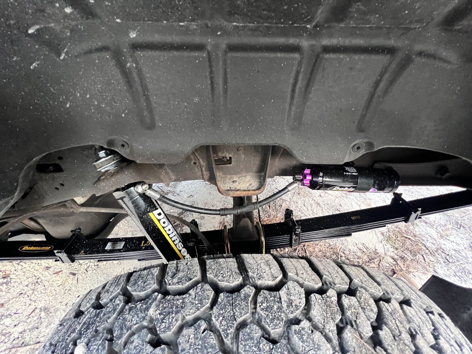

    Is that hose routed right above the bumpstop for the rear?

    No it’s in front of the bump stop bracket, bad picture on my behalf.

    @Dew the setup looks sick. Are those aftermarket leaf springs too?

    Those are in fact Dobinson's spring packs.

    You'll be very happy with the 38 gallon tank. I lucked out when I got my truck and out of the 3 tundras on the lot at the time, the one I was most interested in happened to have the 38 gal tank. I didn't know how much I would appreciate it at the time, but it's been amazing.
    Did you have any wheel fitment issues with the reservoirs?
    This kit is on my short list for upgrading my current setup, but the website says that +18 or less offset is necessary to clear the reservoirs. I'm curious what your experience is?
  18. May 30, 2024 at 12:45 PM
    blenton
    blenton New Member
    Jul 15, 2022
    #80740
    2,857
    I had no issues clearing stock +60mm wheels.
    EDIT: I forgot to note that I needed to relocate the front reservoirs and clock them for clearance.

    I have no wheel or tire fitment issues. My wheels are 18” with a +15 backspacing. My tires are 275/70R18. I have lots of room to run larger tires but I average 14.4L/100km when not towing and around 18.2L/100kms towing.
