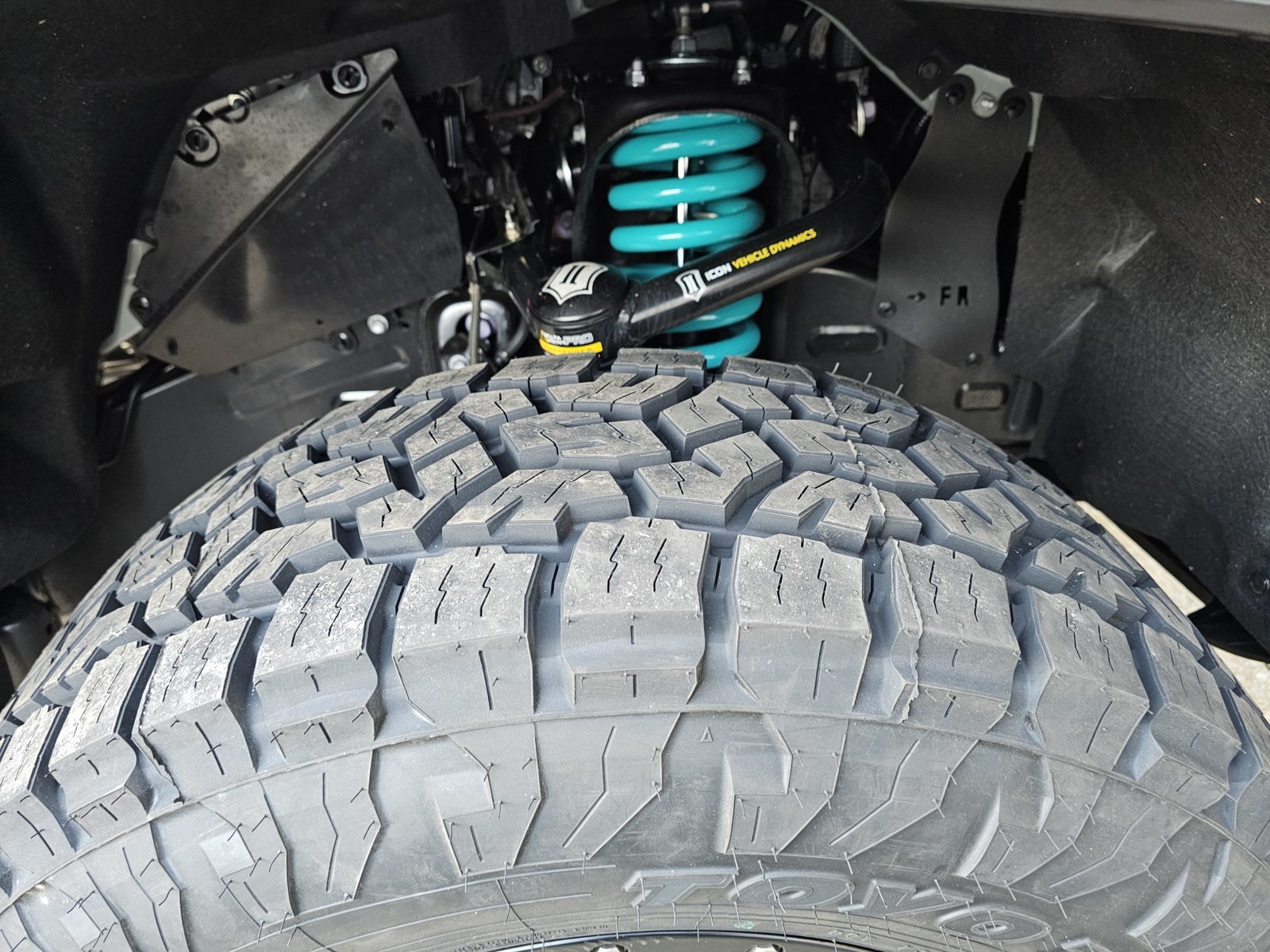

    Get the IMS Dobinsons. Worth the few hundred bucks if you are lifting with their springs. 8k on them and no complaints. 20231221_160330.jpg
    CORam[OP] and Black widow TRD like this.
