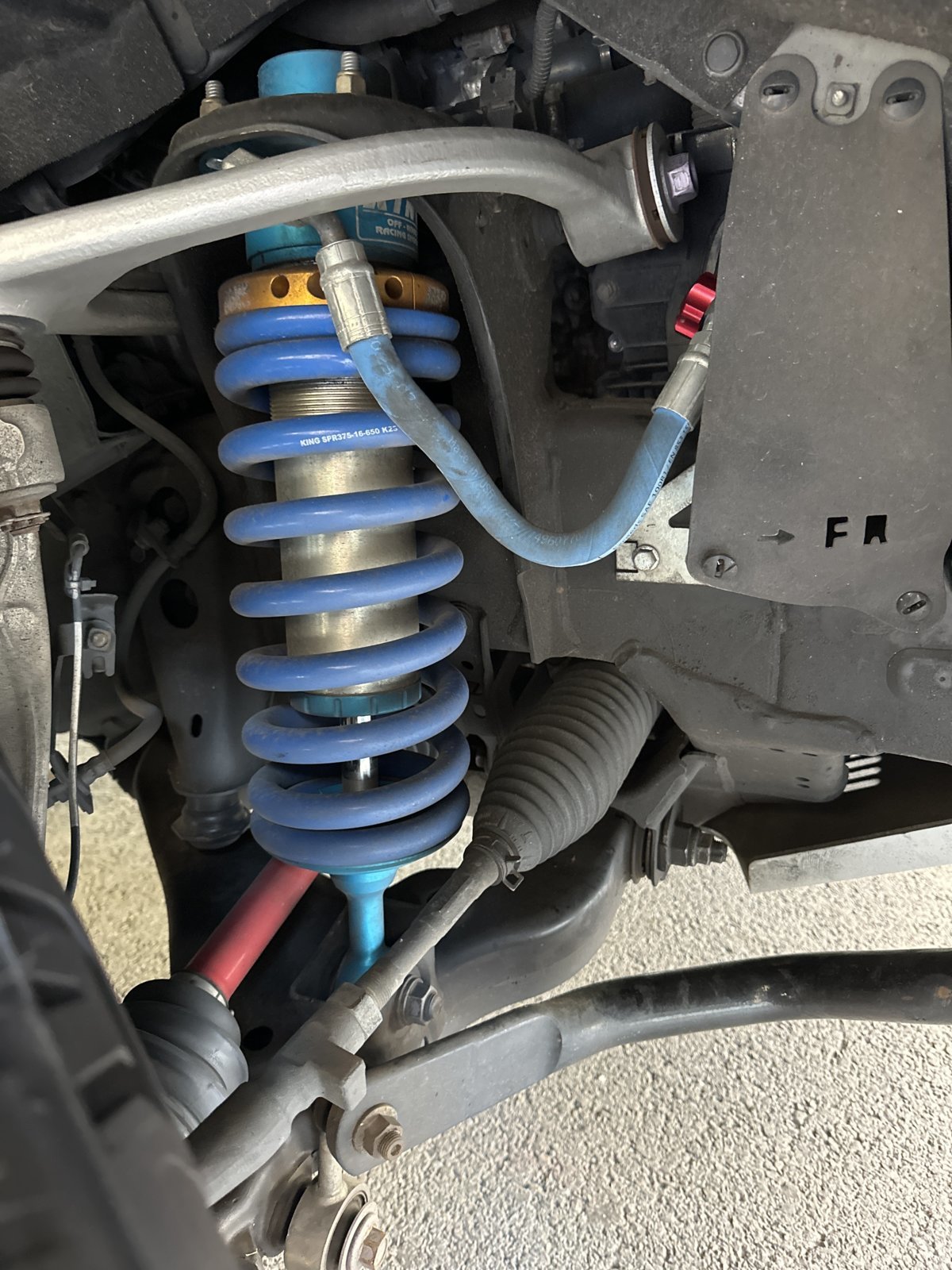

    I have Kings 3.0 on the Tundra and Dobinsons Mrr on my son GX
    They are both good shocks and as long you keep them clean they should last 80 K s if street is your main riding
    Tundra hybrid with a RCI covert bumper I adjusted the Kings to the minimum and I got 1.1/2” lift image.jpg
