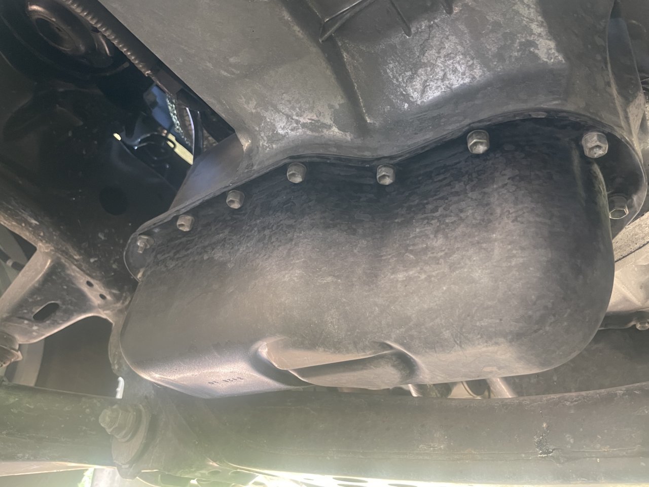

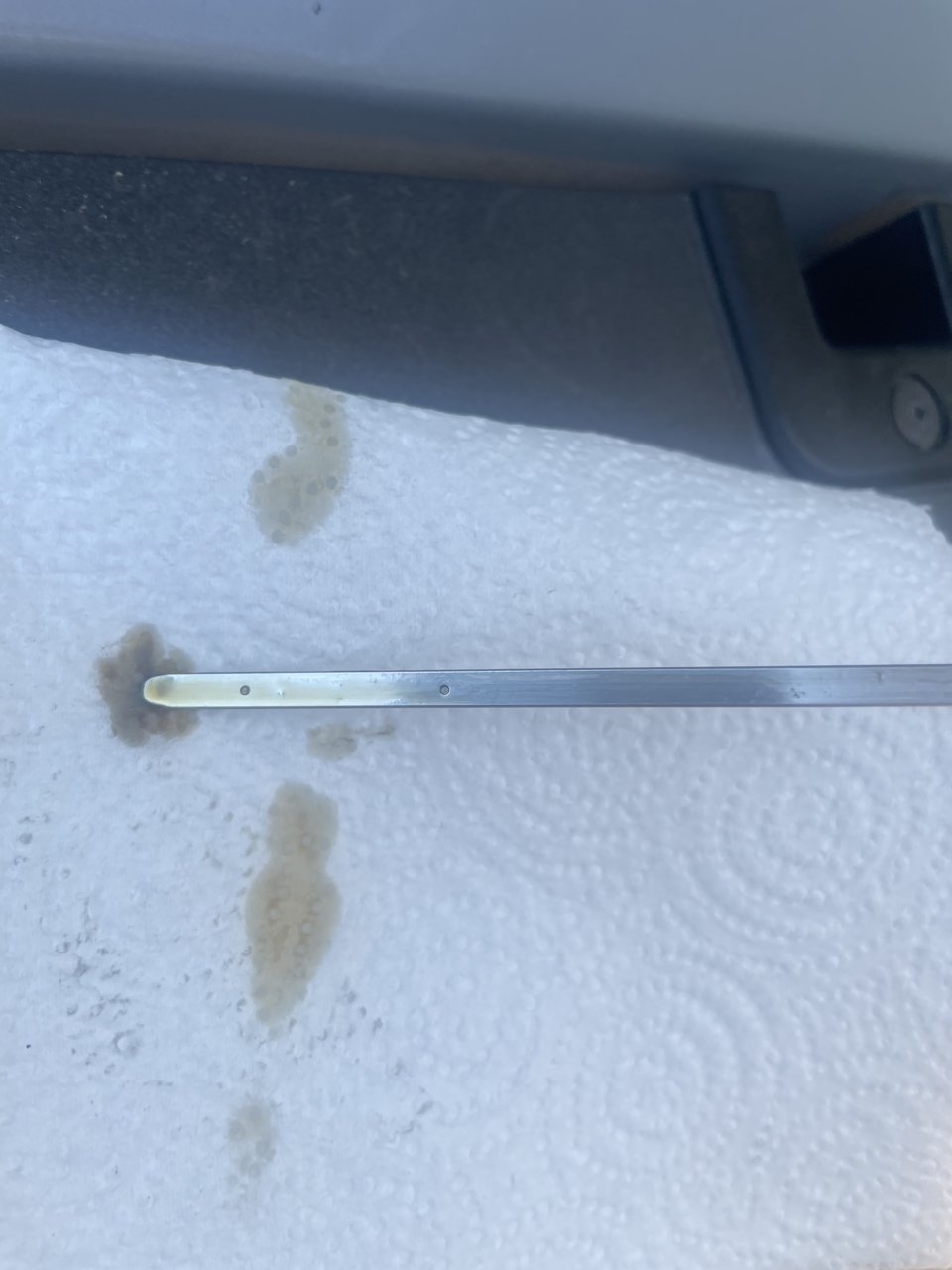

    Hi everyone, I just purchased a 2021 Tundra SR5 with 27,000 miles from Carmax. The engine cover and bottom skid plate are missing. I added the VIN to the Toyota app and here is the service history:
    1/13/2021 - 189 miles - Sanitation
    02/02/2021 - 1641 miles - Sanitation
    4/30/2021 - 3198 miles - Sanitation
    06/23/2021 - 5504 miles - Rotate Tires
    08/04/2021 - 8979 miles - Sanitation
    09/10/2021 - 15430 - Rotate Tires
    10/18/2021 - 20885 miles - 8Cyl Oil Change, Rotate Tires
    Autocheck says this was leased in FL, sold at auction in FL on 2/15/2022, and at another auction in GA on 2/22.
    So, I'm wondering if they really went 20,000 miles before the first oil change and the engine sludged. The missing engine cover and skid plate, makes me think that someone removed the valve covers and oil pan. On the other hand, it has gone another 7000 miles since then and the oil was recently changed again, because it is very clean and slightly overfilled.
    Thoughts?

    Look at the underside of the oil filler cap. If its cruddy then the 10K oil change might've been skipped.

    Post some pics of the engine compartment, inside of oil fill cap and look down the filler. Also some underside and interior shots. I suspect you'll be just fine. I change my oil religiously and don't let the dealer touch it since his monkeys used an impact wrench on the canister so my truck will appear unserviced as well.

    The sr5 skid plate wouldn’t cover up the oil pan just the filter housing

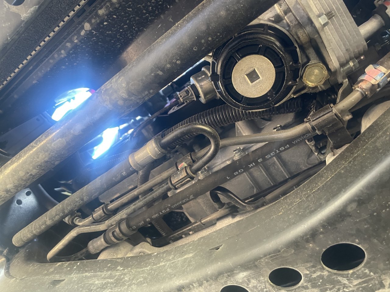

    I’m going to make some calls tomorrow after work. Here are some pictures and I will try to add a video as well.

    Some SR5 have no plate. Nothing is covered.

    I think I’m doubting my own capabilities. The truck sounds fine and has plenty of power. I’m going to change the oil and filter, so I know exactly what’s in it and maybe have a look at the spark plugs. If that’s okay, I will take a short road trip.

    Drive it. The cover is just plastic and some don't have a skid plate. You can also add a better skid plate. Is it 2WD. Looks clean.

    I don’t see anything concerning. Yup do an oil change with full synthetic and new Toyota filter. I’d also recommend AGM battery or at least clean the terminals and posts. Use those red/green felt pads and light coat of grease on posts.

    A little late here but I would get a $30 Blackstone Labs oil analysis on that oil change and maybe a future one or two. They can give you a rundown of the oil condition and what's found in the oil - different wear metals indicating how certain parts of the engine have worn/are wearing with oil changes.
