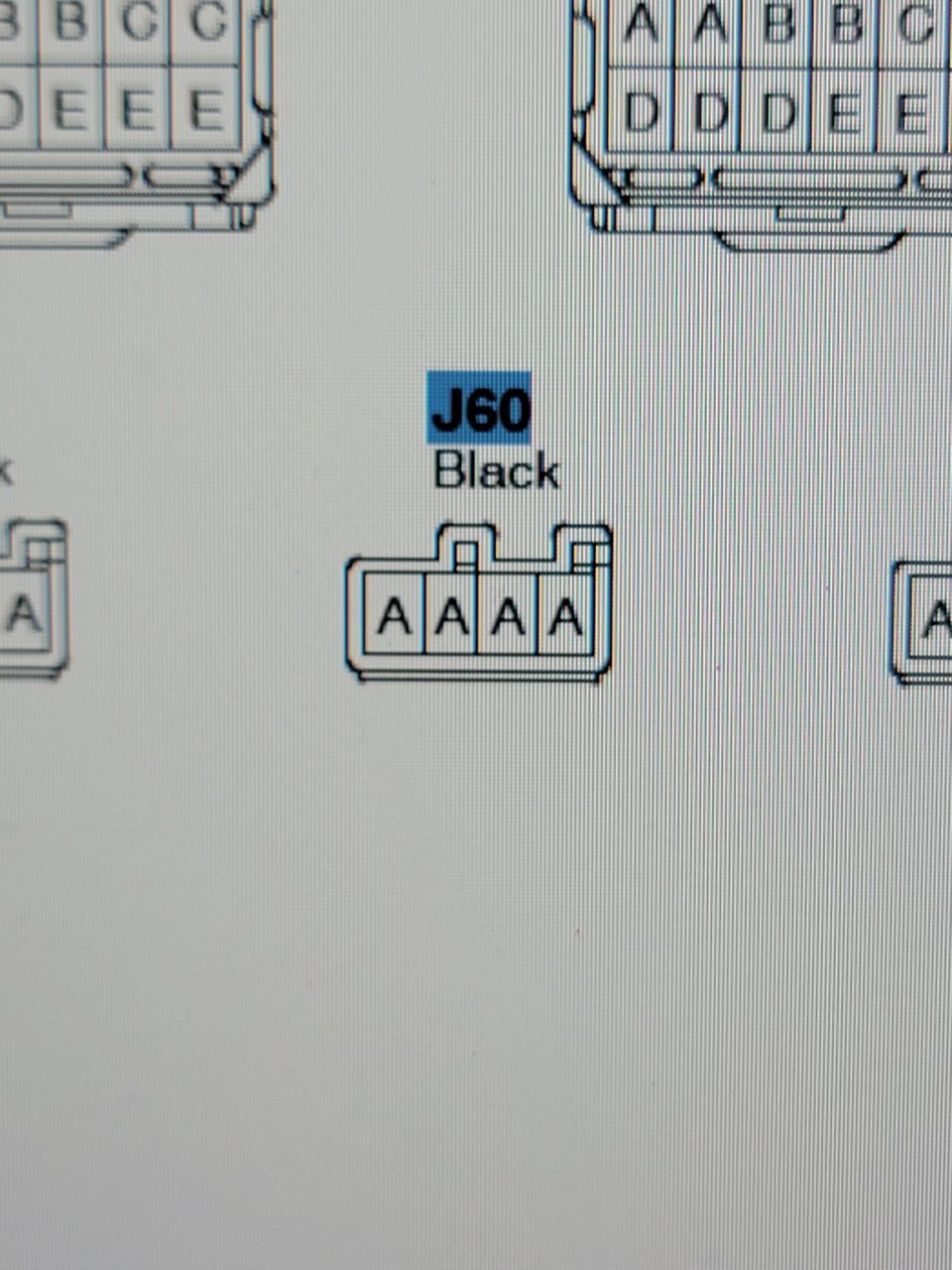

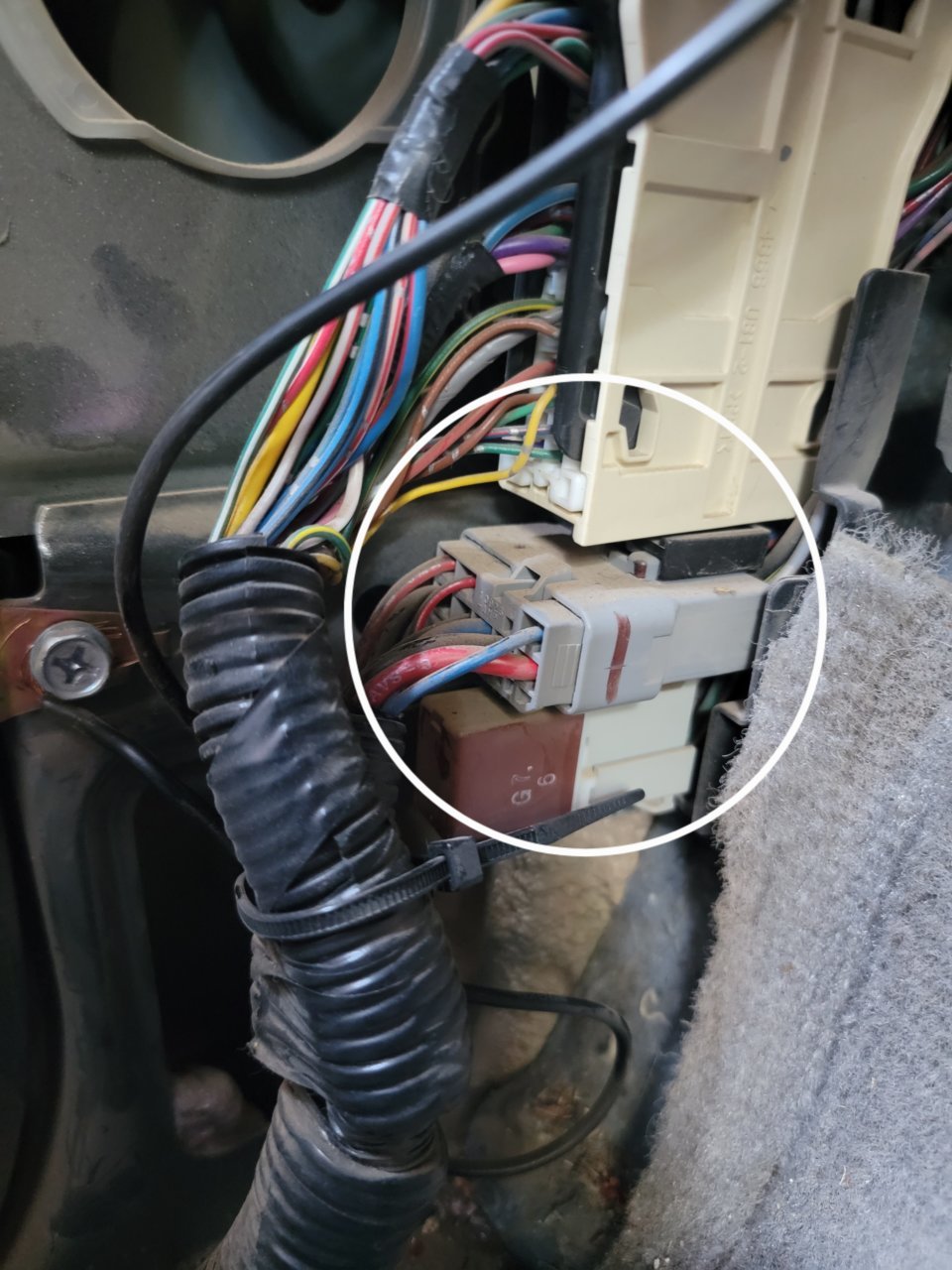

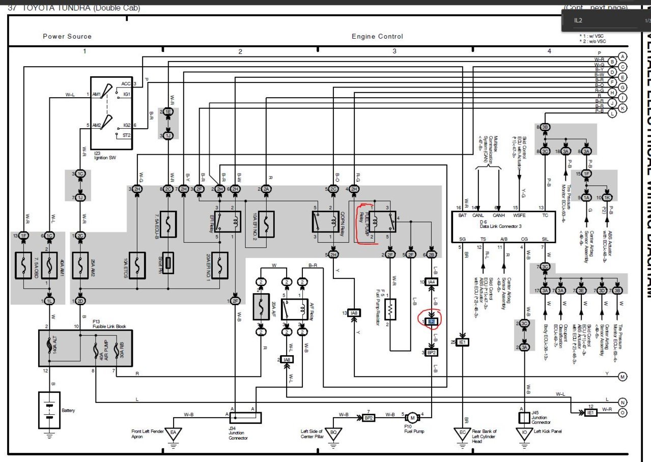

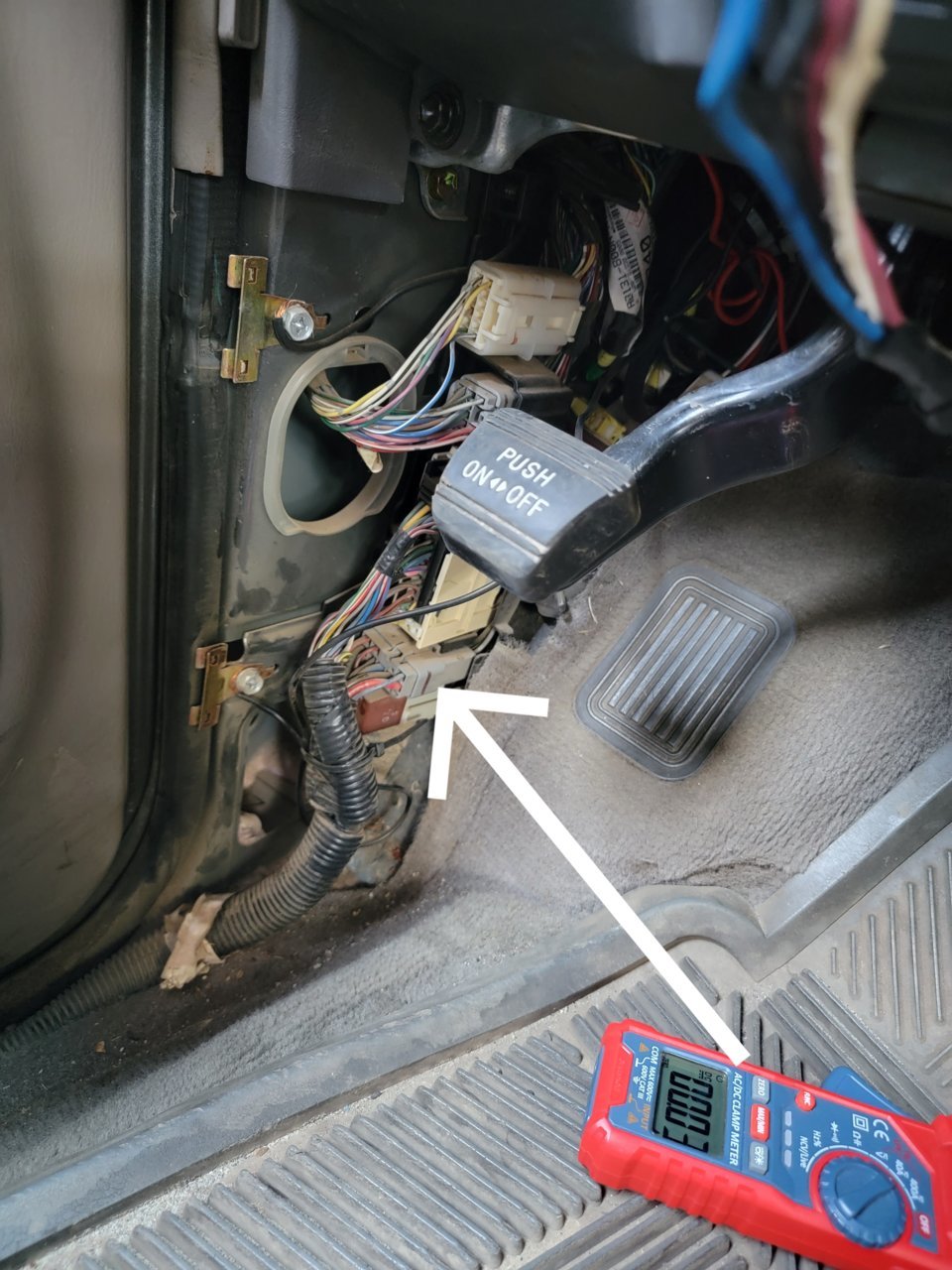

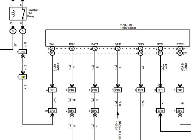

    Under the dashboard on driver side, I have a 1.2 amp parasitic draw.
    The draw stops when I unplug Rad No. 3 fuse. I also found the draw present around this connector. Removing rad no 3 fuse stops the draw at the connector so well, but here's the weird part: when I unplug it my engine slowly dies!!20230902_104448.jpg 20230902_104452.jpg
    Seems so dang weird.
    Just wondering what is everything that this connector is connecting??

    Did your truck come equipped with two package, i.e. OEM trailer hitch and a 7-wire (not 4/5 wire) plug out back?
    Because that looks to me like it's related to OEM trailer wiring.
    One way to confirm is to take your DMM and confirm power to the rear lights/trailer receptacle. Then unplug it and repeat the test.

    It did come with that, I'll check that out thanks

    All stock now, but the issue happened after I put some new speakers in, figured it was the speakers so swapped OEM back in, still bad lol.
    Hmm yeah, weird too cuz the only junction connector listed down the line from rad no3 is that j60, but this doesn't look like the j60.
    I'm trying to find what that connector is so I can trace it back now.
    I also found that the upper-left most wire (red w black line) is hot, so that's the issue. Looks like that's the one going to the amp?

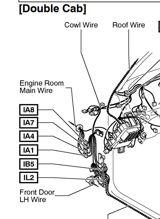

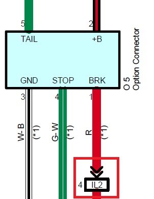

    Seems that connector is IL2
    Let me dig around and see what I can find.

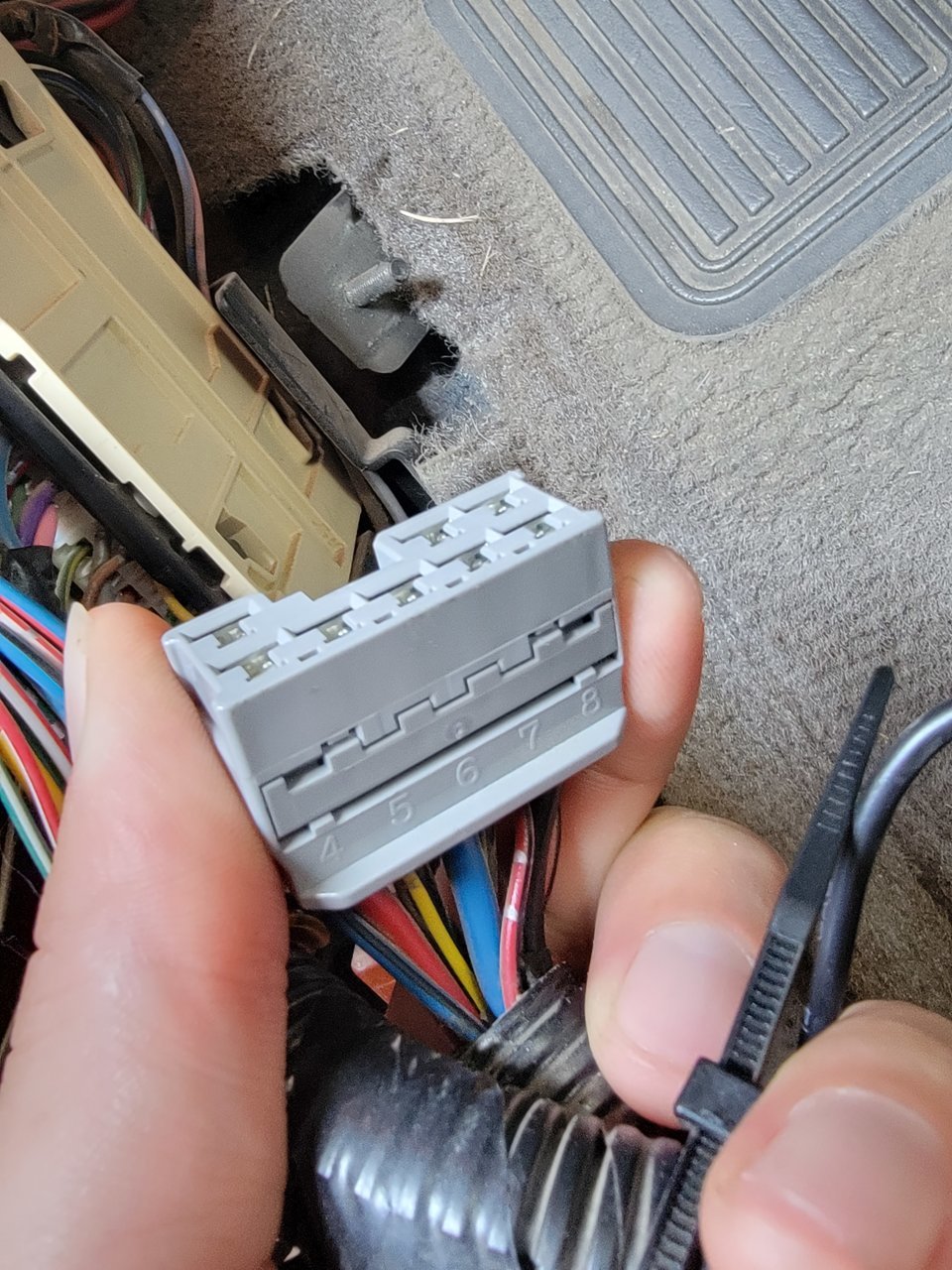

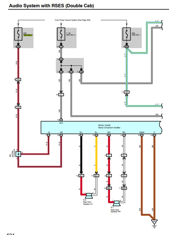

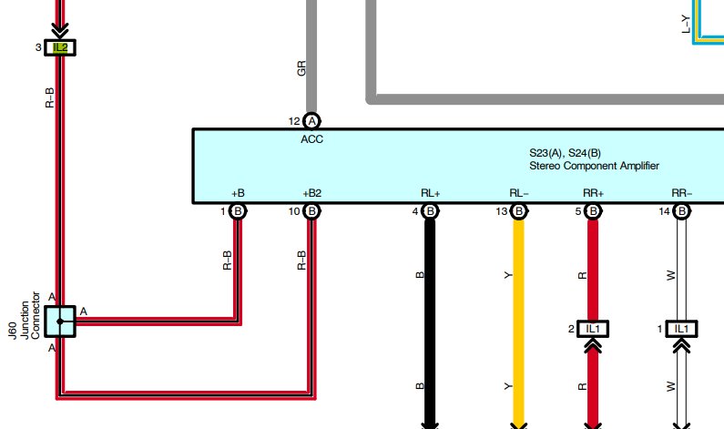

    Ah yes, thanks! so number 3 of IL2 is my issue. That going to the amp?
    Now I'm just trying find other stuff that is engine related to see why it dies out on me out of curiosity lol

    Ah okay I think I got all I need now. Red/Black coming from that is hot, going to my amp, that's my draw.
    Engine dying is probably this: my fuel pump relay is grounded at the L side of the center column. Weird, but would explain it.
    Thanks for the help!

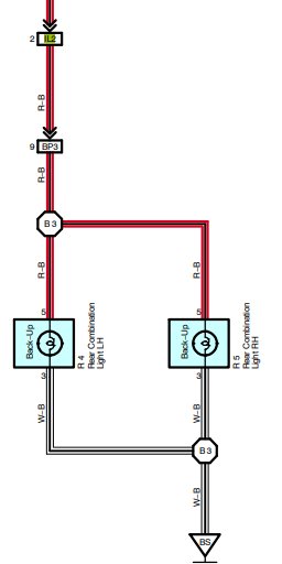

    Pin 1 fuel pump
    That explains why the engine dies when you unplug it.
    Pin 2 red/black - trailer socket and truck backup lights
    You're right
    Pin 3 to the amp, not the HU
    Pin 4 :confused:
    Pin 5 tail light illumination (parking lights) trailer socket
    Pin 6 blue - trailer socket battery
    Pin 7 cargo light
    Pin 8 rear window defogger
    I can't find what the big thick red wire on the 4 pin is...
    BubbaW likes this.

    Glad to see you got it figured out..
    I wonder why the amp is drawing power.
    Weird it happened after the speaker change..

    Yeah, only thing I could think is that The speakers I put in had a different impedance, and I just cut the wires to the mid-range so no mid-range speakers. I'm thinking it just fried something in there? Idk, now that the amp is bad I'm pretty sure I'm just going to go through the whole system and replace everything haha

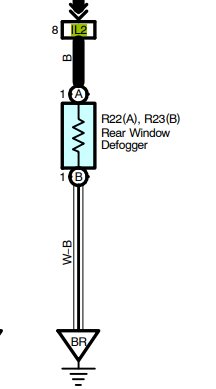

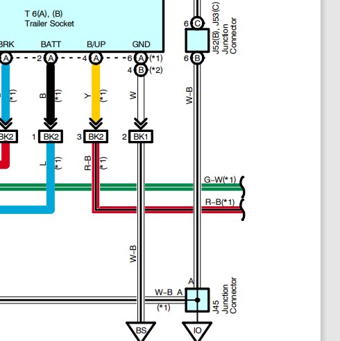

    Big red wire is pin 8, since it’s rear window defogger, draws lots of current!
    Wrong, looked at wrong picture, take my ass back to watching football :eek:
    Pin four is for towing/trailer brakes.

    Just an update if anyone's curious. Narrowed it down to the amp, definitely something shorting in there. There's continuity between the top power pins to every other pin on there for the outgoing signals to the speakers.

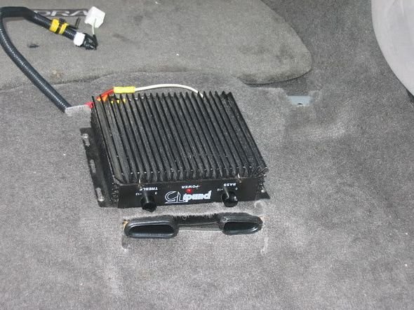

    Personal opinion, but the amp bypass wiring is a pain in the butt. I think it'd be easier to just rewire new speakers. Get good components up front, decent coaxial in rear and new head unit and it will sound a million times better than the factory system.
    I got all of the speaker brackets from crutchfield and it was easy to install the new speakers.

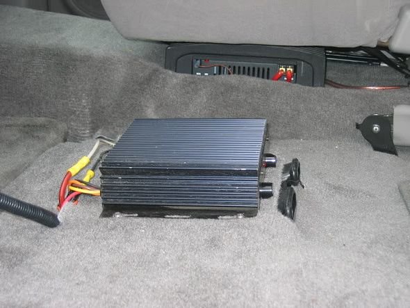

    I just unplugged the negative battery cable, unplugged my seat, took 4 seat bolts out, popped off a sill plate, lifted the carpet and slid the wires into place before plugging in everything behind the head unit. It took 30, maybe 45 minutes start to finish.
    I know you guys with DC may need to pop off the rear panel to access the amp, but ... running new wires from the head unit, through each side of the dash, fishing through the door grommet, popping off both front door cards/panels, tying off and routing to each speaker, then running wires under the carpet to the B-pillar to run through the rear door grommets, popping off the rear door cards/panels, routing to each speaker ... that's like at least 2hrs labor, even for a professional. And lots of plastic snaps to break on the door cards, which you need to replace later if you don't have on-hand. And no clean route to run the wires under the dash.
    Honestly, with the bypass kit, you could probably just fish the between the OEM amp plug and the head unit using a rod or bendy plastic without removing anything, but I wanted to tuck my stuff away neatly, so I popped the seat out to trace along the OEM cable tray at the base of the center console.

    The DC amp is in the back of the cab behind the back seat so you have to run the wires from the back of the cab to behind the dash, and the door cards have to come off anyway to replace the speakers. I just remember with all the wire fishing I had to do I wished I had just run new wire and not messed with the bypass kit.

    Mine was under the passenger seat, so similar path for me. I've installed my fair share of systems for customers. I prefer easy, plug-and-play. Main reason I went with the kit. OEM wire is ample if you're not intending to compete in IASCA.
