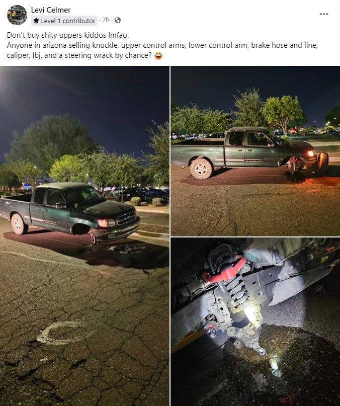

    I think we'll start seeing the same with cheap UCA soon, given all these mainland China re-pop uppers coming out, look to be the same Freedom was using but are being sold under KSP brand and half a dozen other names now. Pretty sure these are the same @VR6T installed but his are black?

    I knew you were gonna post this. LOL I saw this am while in bed
    Me AND @VR6T have them. But he ran his without grease for a little while and he tows more shit than I do. So he maybe in line for some new uppers before me.

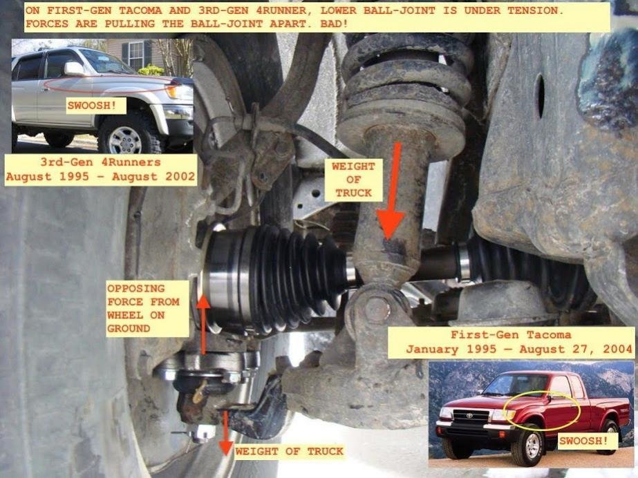

    And all first gen Tacomas. I don't know how 4Runner gens break down but Tacoma had the failure-prone LBJs from 95-2005, entire run of the first gen.

    4runners 96-2002 had the issue

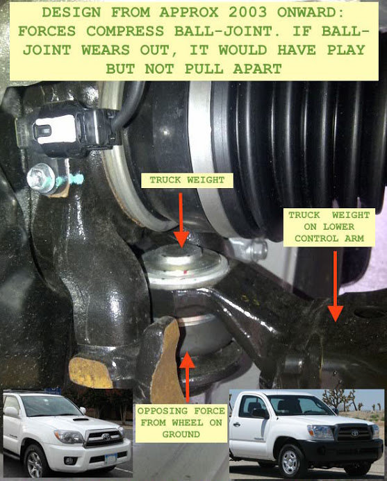

    Yep, looks like you're right (give or take a few months). I've posted it before, but this shows the breakdown. Unfortunately it doesn't include the Tundra.

    I wonder if you could replace FGT UCA, Knuckle and LCA with 2003+ 4R parts to solve this?
