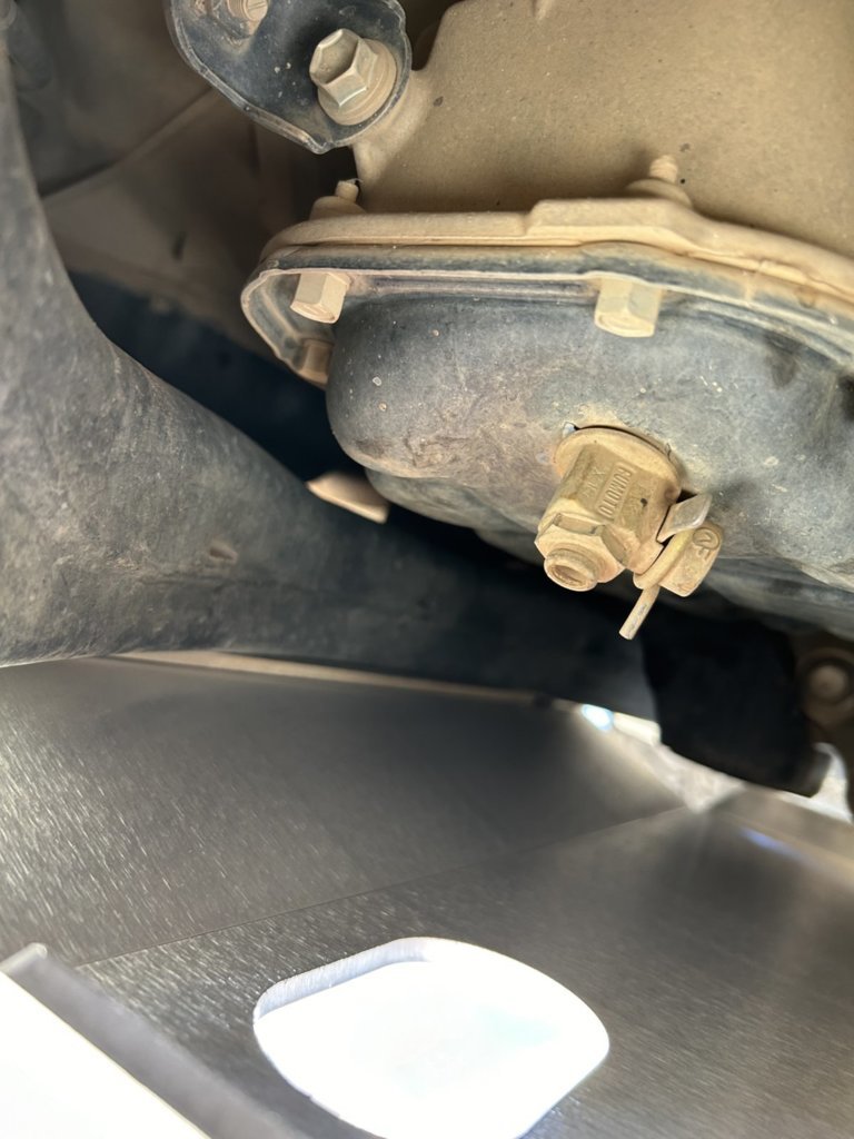

    How much room is there between the skid plate and the Fumoto valve? Are there any clearance issues? thanks

    Plenty and none. I have the OEM TRD skid plate.

    The F133N is the model# and the one I have. Both model#'s listed in that thread will work, however the other one is bulkier, and has an o-ring seal for the rotational feature that I didn't care for.
