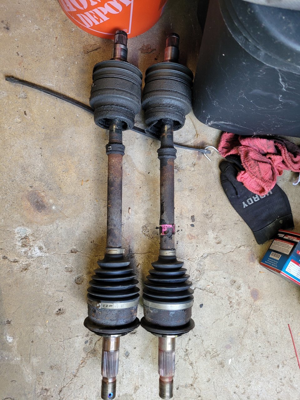

    2004 DC
    I'll keep em to send out to rebuild if so.

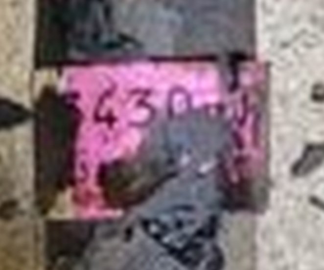

    Only tag is a pink one on one of them with writing I can't make out.

    They look OEM to me, the pink sticker is a for sure indicator. Toyota does sell remans for $80ish + $75 core charge depending on the dealer.

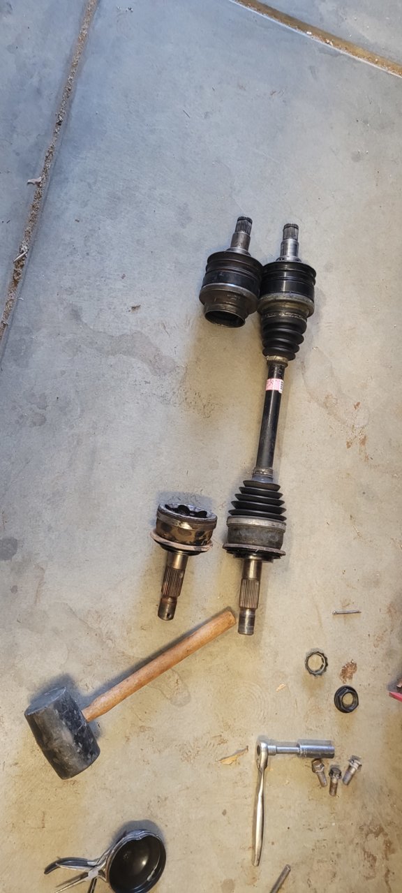

    Here's some of my miscellaneous axle parts for reference.
    Top one in the first picture is an aftermarket Import Direct. The bottom two are OEM.

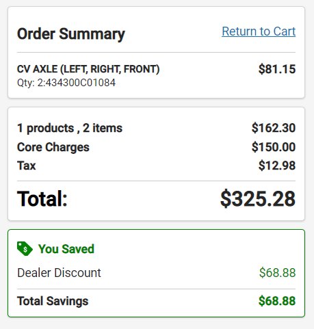

    Slightly related, but I ended up ordering a re-manufactured OEM CV from my local dealer for $83 and plan to return my core when I pick it up so there's no shipping costs. I'll post a picture of it when it arrives. The re-manufactured part number is 43430-0C010-84.

    It's not a bad deal. This is on local pickup from my nearest dealership.

    If you're sending back the core, it may be a bit more economical to buy locally since they won't pay for the return shipping.
    If you're buying an axle and not returning the core though, say if you want a spare, this is a great price ($155ish shipped). If you did the same thing through CVJ, it would be $387 plus shipping.
