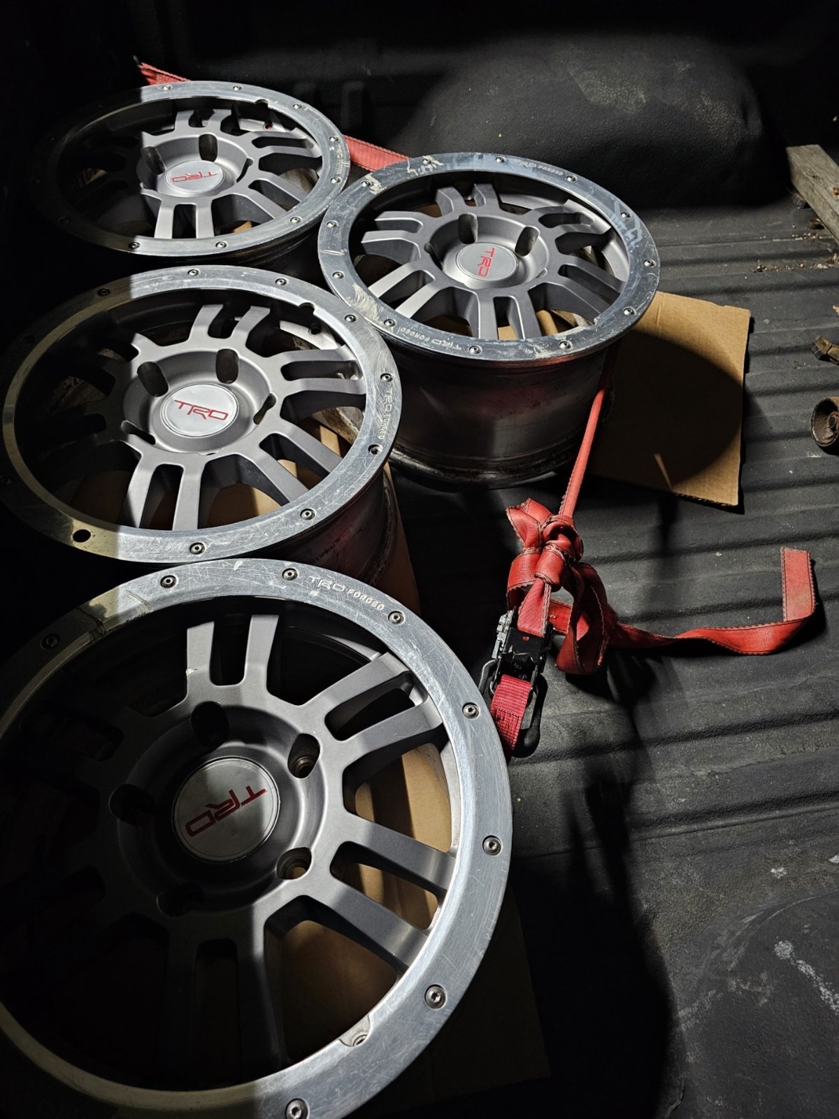

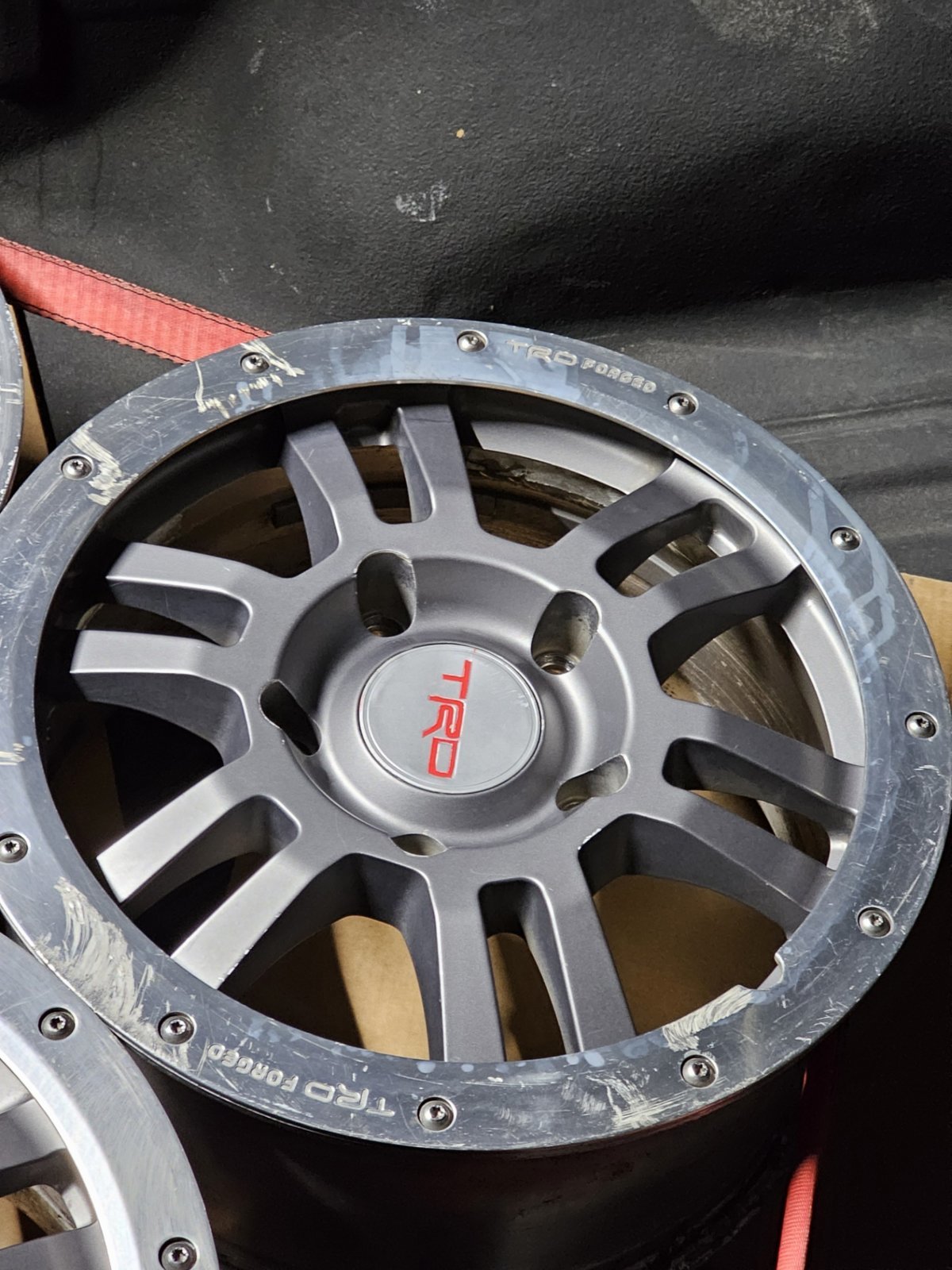

    Just picked them up yesterday so i'm waiting to install them until my new suspension comes in. But here's a look at them, spokes are in pretty solid condition!

    Look great. Get those outer rings powder coated and that set will look like new

    Won’t look like new really. Those are gouged and the powder won’t fill it in. That being said, these have character!! Someone definitely took an angle grinder to one of them though lol, bolts are rusted in there good.

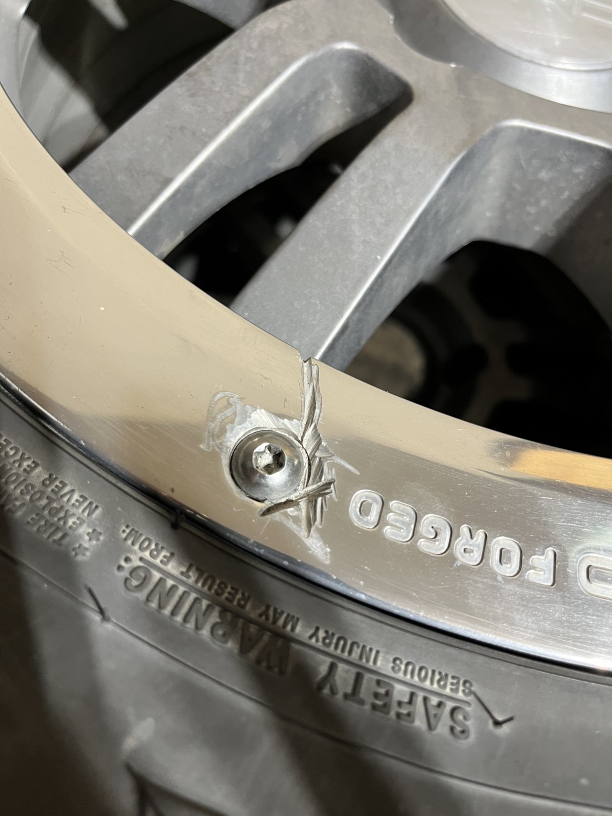

    I too got one with some with some “tool” marks. I was able to source a replacement tho. They can be a nightmare to get off!

    Wiha Blue Terminator T30 and torching 90 seconds behind each bolt (from the inside of the wheel) and it’ll come right off!
    After soaking a week in PB blaster! Lol.

    Any tips to get a broken extractor bit out lol…some ppl :anonymous:

    Drill it out haha! I feel your pain.

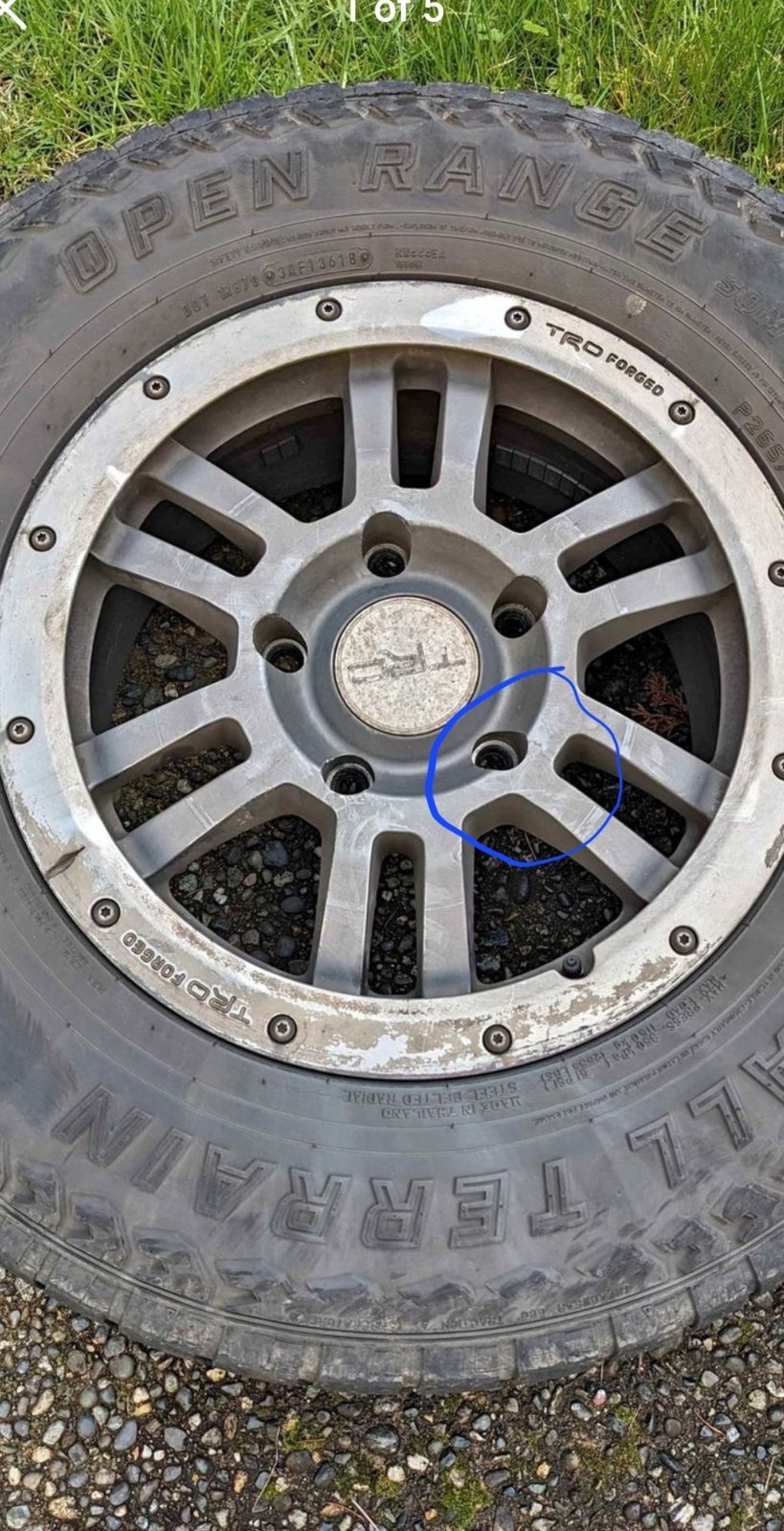

    The rings can be repaired by a good shop. Will need to be powder coated after repair because the repair will not match the color of the rest of the ring. Disregard the blue circle, that was a different concern when I bought the wheels. The damage on this ring is in the lower left of the picture.
