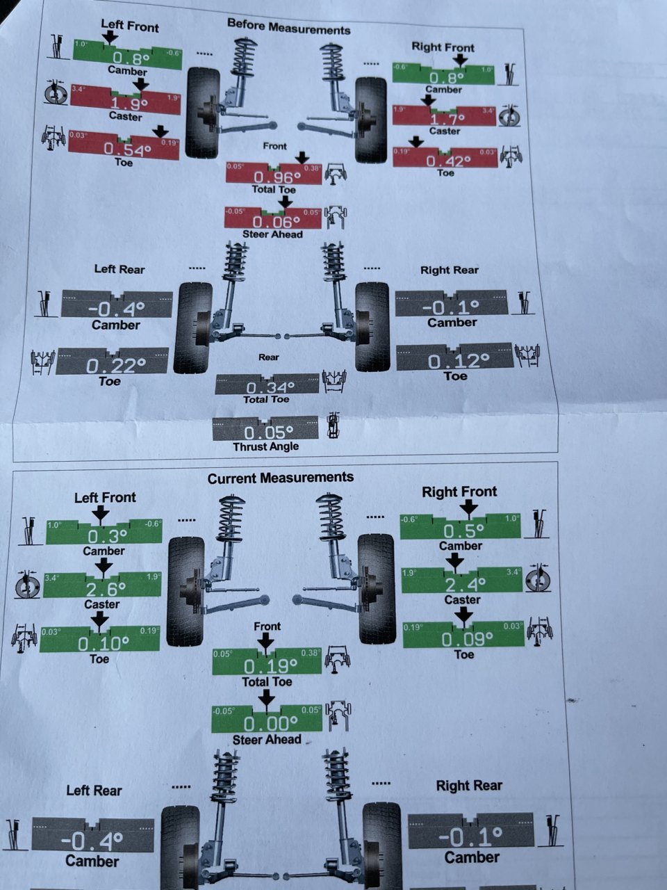

    Installed 6112’s at 1.9, driver side shim, 5160 rear and coach builder +2 shackles this past Saturday. Took to Toyota for alignment. Do my numbers look ok or can I do better? Drives fine and tracked straight. Just want to get alignment nailed down before new tires. Thanks for the help. CE2EF73E-9FFC-4AD7-AF6D-D316432AE5F8.jpg

    Camber 0
    Toe closer to .12 cross

    Looking good. Is your steering wheel straight?

    It is straight and drives fine. Just wondering if I need to continue down the road of finding a tech or place that can do better. Is it worth it is what I’m wondering.

    Since the truck drives straight and steering wheel is straight, the tech did a great job. Your numbers are great.

    Sound good, thanks, I will just on top of rotations and watch tread wear. Now the question is 285/60/20 or 275/65/20.
