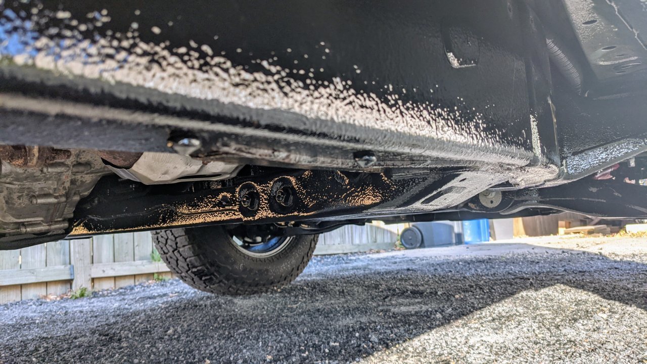

    2022 Tundra Limited TRD
    What product is that? It looks really thick, wouldn’t mind having that on the frame opposed to a fluid film.
  11. Sep 4, 2022 at 4:28 PM
    BravoDeltaRomeo
    BravoDeltaRomeo Old Man Little Blue Finger
    Sep 3, 2019
    #35569
    3,746
    Bruce
    MB Canada
    2019 Cavalry Blue Tundra CM
    Corrosion Free.
    This was right after applied but it is quite thick. Nothing dripped after I applied.
