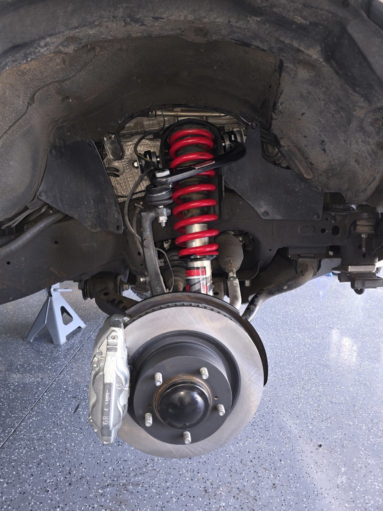

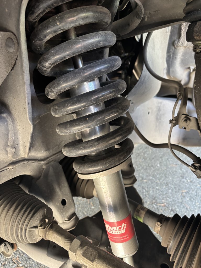

    Yes, replace them. Got a 2018 in Sept 2024 with the same mileage. It made a big difference in ride quality for the better. Went with Eibach stage 1 shocks front and rear and kept factory springs. You will be happy.
    KNABORES and EmergencyMaximum like this.

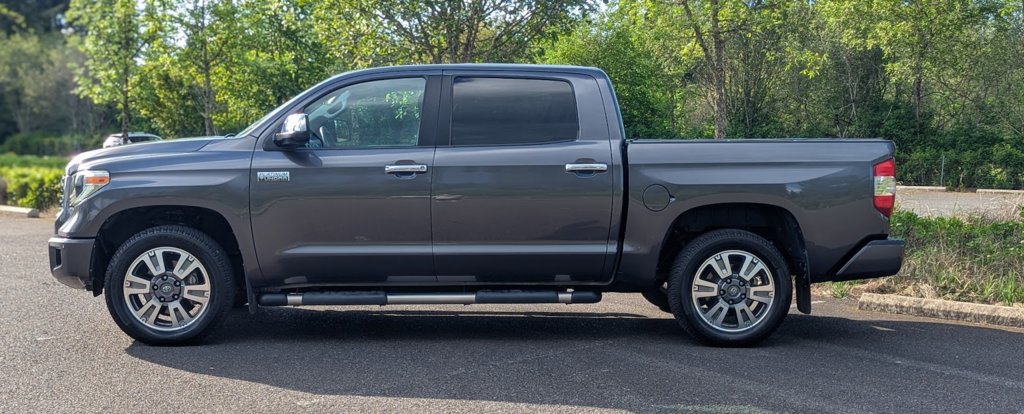

    There's no sag at all. The previous owner was a firefighter and he took care of the vehicle as far as i can tell, no towing, no heavy load, the bed is in excellent condition, no scraps or dents. Here's a side view photo.
