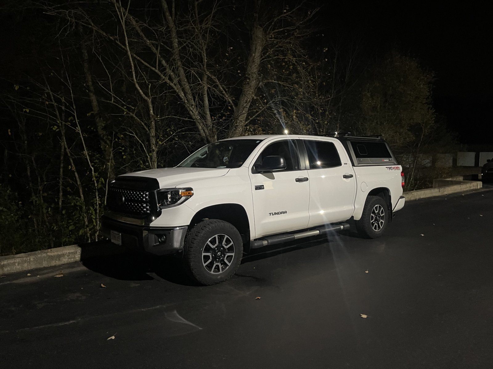

    Do I need an alignment after installing an AAL in the rear? Installed 6112’s + 5160’s today but could not get to installing the 1.5” ICON AAL sadly (just didn’t have the time. Planning on installing Monday). I already have an appointment to have an alignment done tomorrow, and I’m unable to reschedule. Will I be okay installing the rear lift and not getting it aligned again, at least for a few weeks? I’ve heard I’ll be okay, but I appreciate the input. Thanks guys
