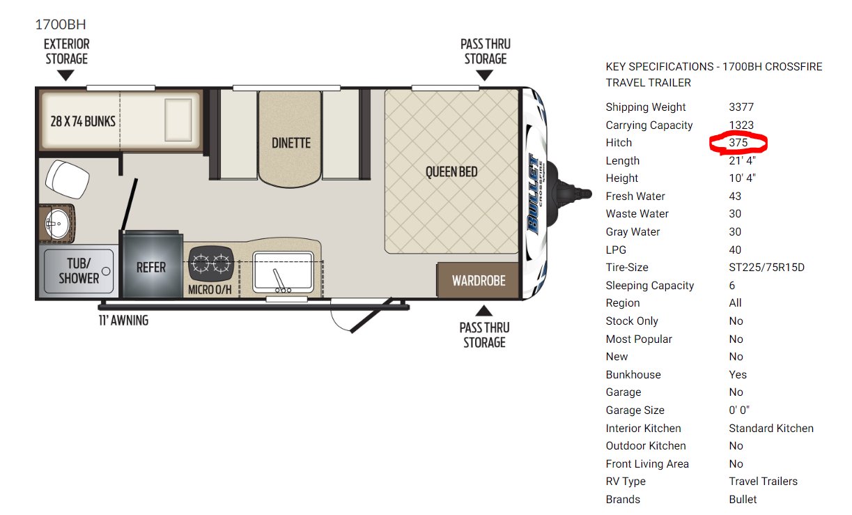

    https://www.tprv.com/bullet-ultra-lite-travel-trailer-floor-plans

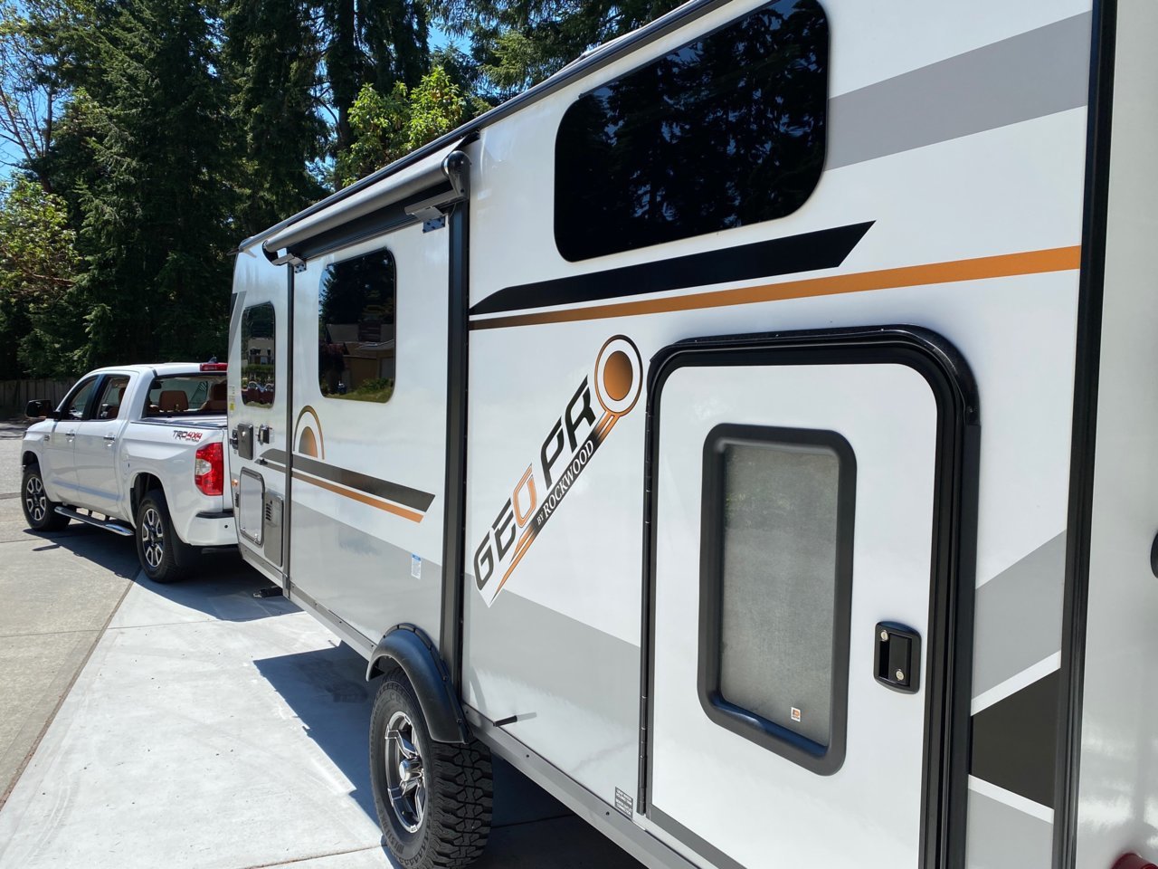

    JDR76
    JDR76 New Member
    Jun 22, 2021
    #64642
    557
    WA
    2021 1794 TRD OFF ROAD
    What is the length of the trailer you are looking at? To me, that is more important than the total weight.
    My trailer is only about 4500lbs loaded and 21' long, but it has the aerodynamics of a brick. I think I could go up another 1-2k lbs and not feel a noticeable difference in pulling, but a longer trailer becomes more of a wind sail.
    Tongue weight is of course the issue. My trailer has an advertised hitch weight of about 450 lbs. I have a hitch scale and if I have more than a half a tank of fresh water and am not careful in my loading, I can easily top 850 lbs on the hitch. I can get it down to 750 when I load carefully.
    I have been considering bumping up a size in a trailer. Looking at about 25' and a loaded weight of about 6000 lbs. I don't think I want to go any larger than that with the Tundra, and it may even be pushing my comfort level a bit, but that has more to do with backing it into tight spots than anything else.
    So to take too long to answer your question, I think I'd be comfortable with the setup you propose, as long as it's not too long, and as long as you load it carefully.
    Cpl_Punishment likes this.
