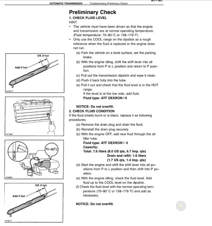

    Check that transmission fluid. The level and freshness of the fluid is critical to shifts.

    Not stupid at all. It's something a lot of people over look. No need to google it, it's stupid simple. Drive it till the truck till you feel the trans fluid is at operating temp and then check the level. I've always been a fan of measuring what comes out of the trans and putting that back in for a starting point. If it measures within the good lines, put in the same amount you removed. If it was over/under, adjust as needed. It's one bolt (14mm?) right on the trans pan you'll need to remove.
