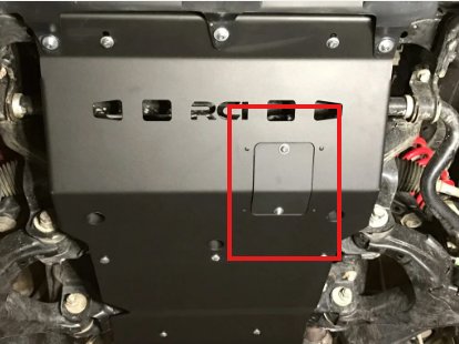

    Oil changes do not have conflict with your cat shield. The front skid plate will need to be removed if it does not have an access door/cover like to RCI or TRD Skid have incorporated.
    Cat shield however, will need to be removed to service transmission and front diff.

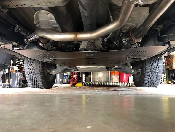

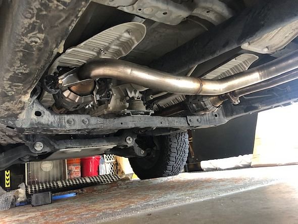

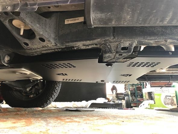

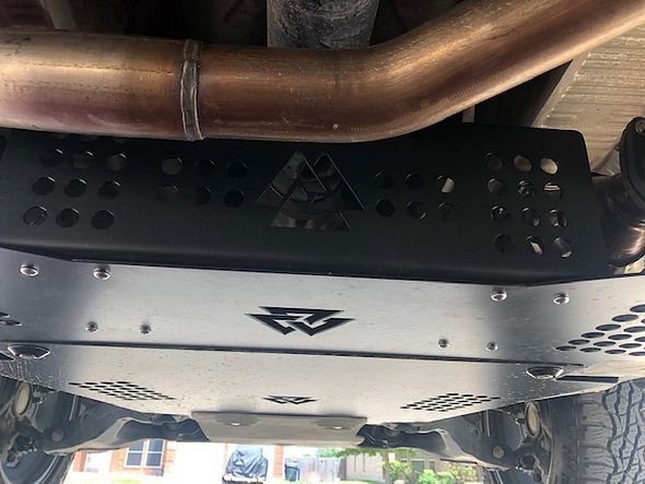

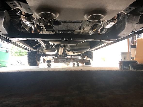

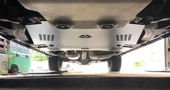

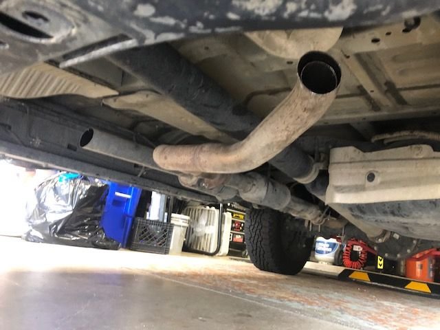

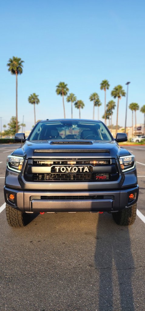

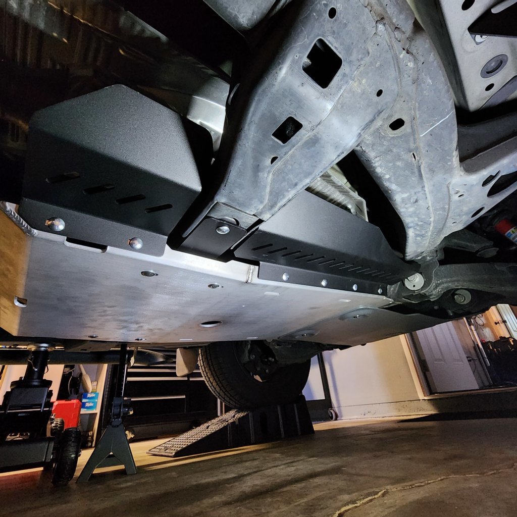

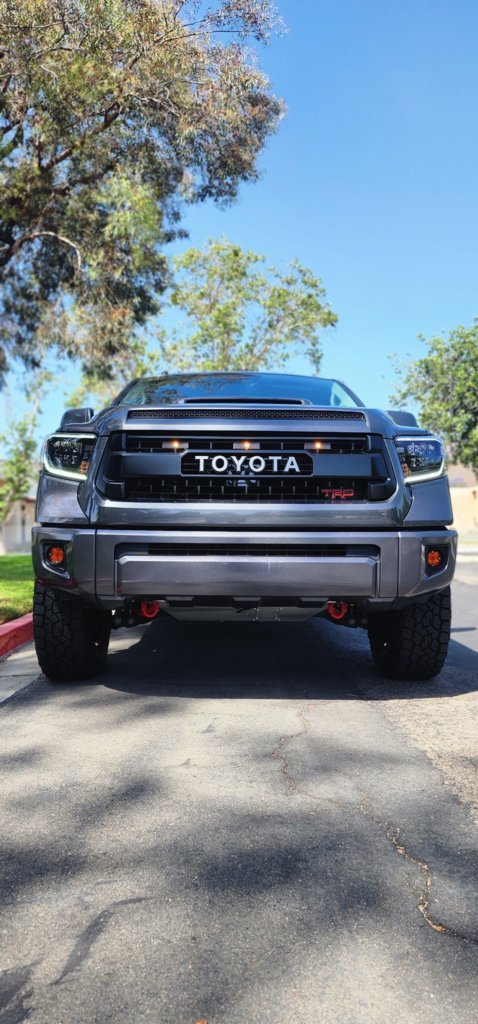

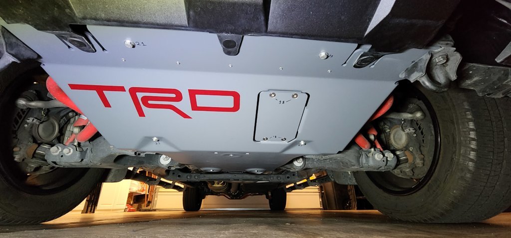

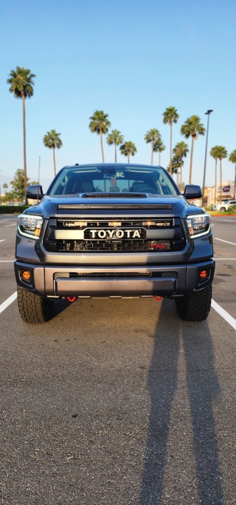

    Oil changes, no.
    Trans stuff, like @Leo's first stated, just drop the shields.
    I'm a strong supporter of cat shields since mine were stolen in November of 2021.
    If I needed them now, I'd get them from @Talon2006
    I have a TRD skid plate with the oil change door, but this is the difference between shields and no shields.
    765f2c2a-09d8-406c-a051-762eb8847e11_25b0036b12a755627be3c4aed2b7cb64d9d9fd34.jpg c8363646-3dc7-4b02-b1d7-86062ab44777_00a7e88e297d21573577f53d5b794cfc141de2e4.jpg

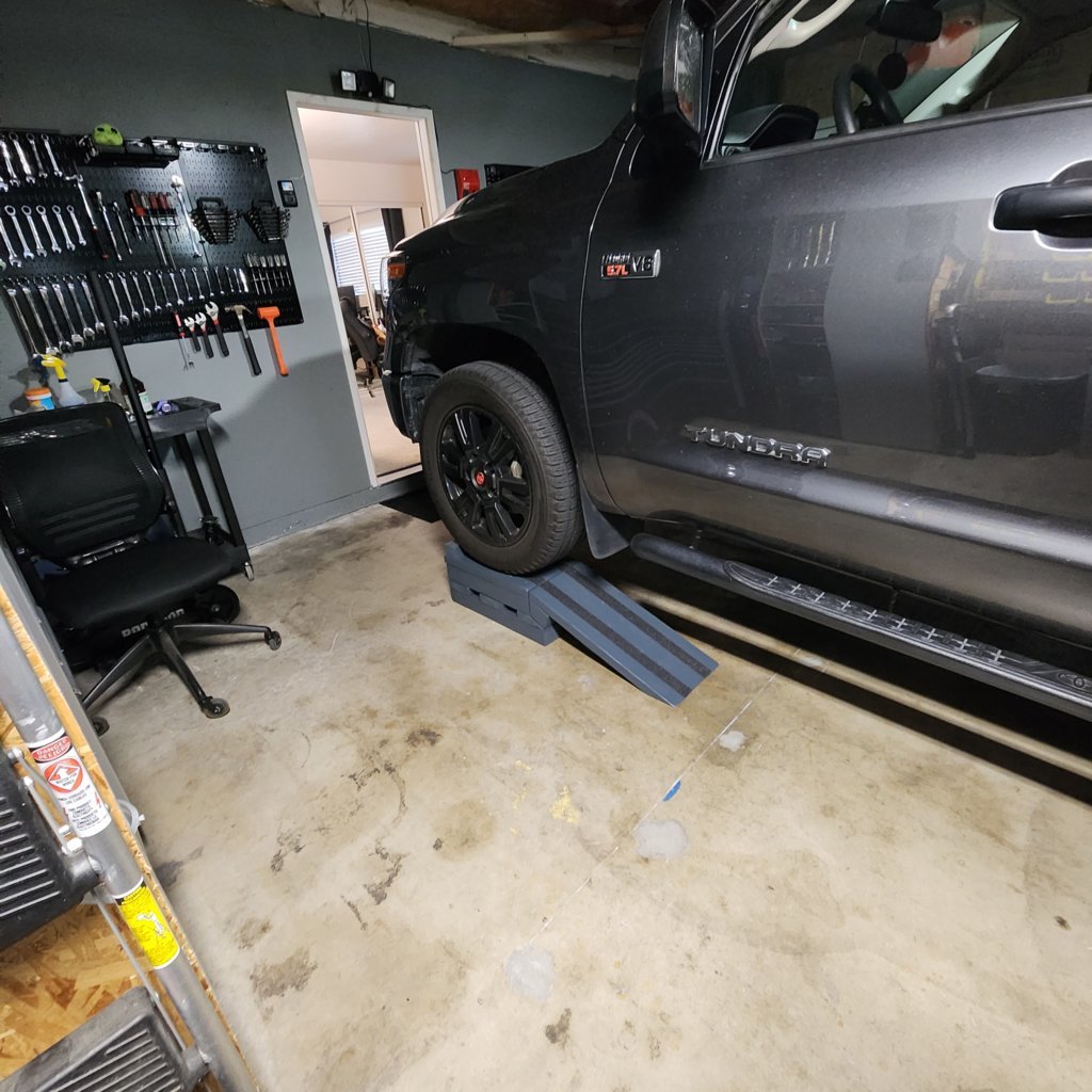

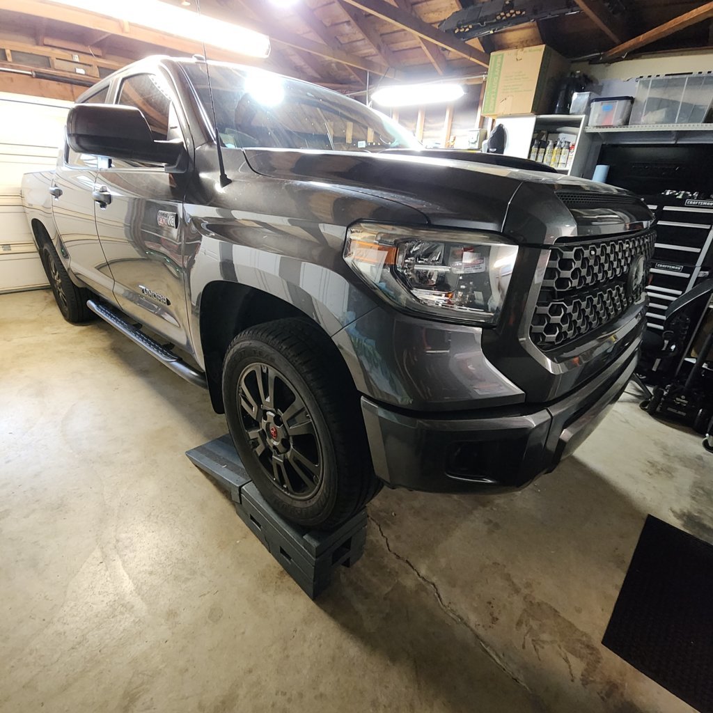

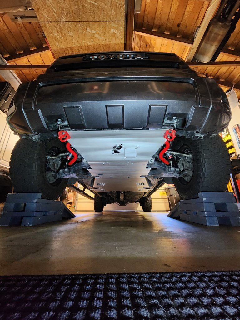

    Dude those ramps remind of something my grandfather would’ve built. Stout
    How do you move them around?
    sorry op:threadjacked:
  7. Jun 26, 2025 at 8:00 AM
    TacomaTRD4x402
    TacomaTRD4x402 New Member
    Nov 26, 2023
    #107483
    1,582
    Southern California
    '18 Tundra TRD Sport 2WD 5.7 Crew Cab MGM
    Haha, my bro actually built em for me. They're extremely well built. Definitely heavy duty and heavy AF but they're also modular like my skids :rofl:
    The ramp part separates from the block
    Also, they stay mostly stay in the garage where I work so not a whole lot of moving them around. Mostly just sliding em in position.
