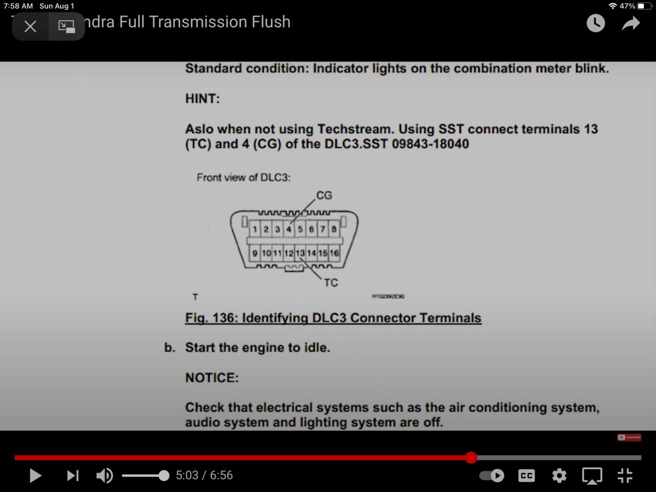

      1. Good Morning, I was wondering if it is possible to run a jumper wire between the DLC3 terminals to detect trans fluid temp like the previous gen did ?345C87D7-A58E-419F-8DE9-E5B28CBDD6B8.jpg
      2. I’m doing a fluid change and don’t have a techstream

    Looks correct.
    Someone just posted a "Car Care Nut" Video on how to do this without tech stream. Its the "Fluid Check" method but at the 8 min mark:
    https://youtu.be/NUAuGmDGntY

    Thank you, I was curious what light comes on with the newer style gauges, I just go try and see what happens…
    I just found a video with the same dash as my 17’ , It is the D light that is used,
    Thanks
