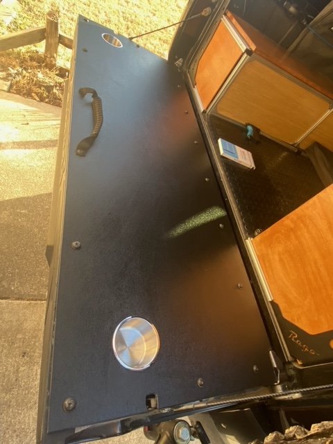

    I made my own tailgate table and save $$$. Below is the list and price.
    - 1/4 inch abs plastic sheet from local plastic store ($80). Bought mine from TAP Plastics
    - x2 stainless steel cup holders from Amazon ($15) https://www.amazon.com/dp/B0772TCX5L?ref=ppx_yo2ov_dt_b_fed_asin_title
    - Deburring kit to round off edges from Amazon ($7) https://www.amazon.com/dp/B0BF48C65D?ref=ppx_yo2ov_dt_b_fed_asin_title&th=1
    I removed the oem tailgate, used it as template and made the necessary cut outs and pilot holes.
    Here is the video
    https://www.instagram.com/reel/DKQwQwGxCHi/
