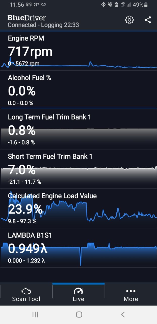

    I was able to update to the latest software and relearn the alcohol density with no issues and it was actually pretty easy to do.
    While I was I'm there I went through the customizable options, and changed things to my preferences.
    I do still plan on upgrading the fuel pump in the near future, as that seems part of the root cause of the problem to begin with.
    Before: Screenshot_20230121-080843_BlueDriver.jpg
