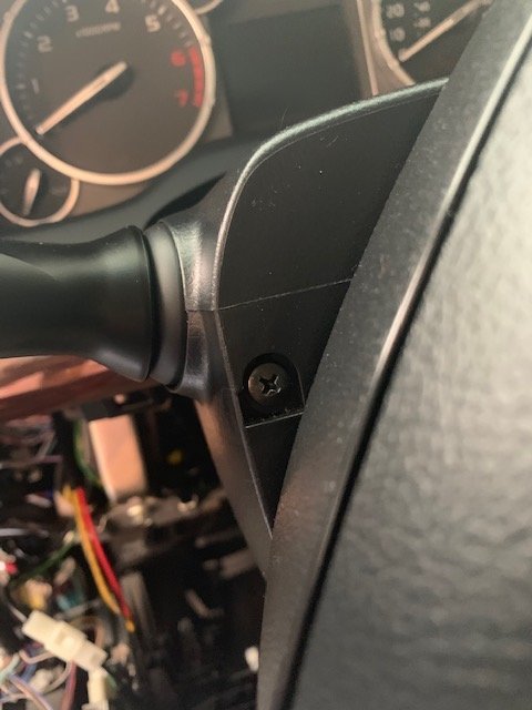

    Remove both Philips screws with a screwdriver on each side of the steering wheel. It's best to start your truck so the wheel can easily turn from left, to right.
    Step 5:
    Gently pull down the steering column at the seam.

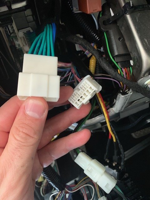

    Unplug factory ignition harness:
    Step 7:
    Plug the male part ignition of the remote start unit into the female factory harness. Then plug the female part of the harness, into the male ignition plug.

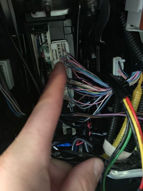

    Remove the OBD II connector from the mount. This is located under the panel, on the left hand side. It pops out rather easily with a flat head to press the release.
    Step 9:
    Replace it with the male 26 pin plug from the remote start harness. (Factory plug pictured first) Then connect the open two together.

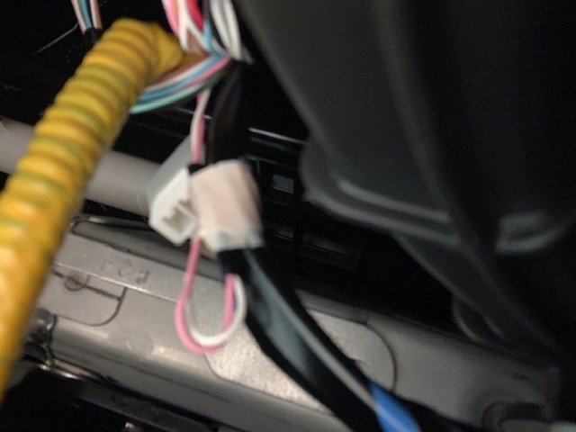

    Unplug the factory TPMS connection. (follow the yellow tube; the connection is up, at an angle and comes out easily)
    Step 13:
    Take a long zip tie (or wire hanger) and feed the TPMS connection that came with the kit, behind the center console and to the passenger side.
    Step 14:
    Plug the TPMS connector from the harness into the TPMS female connection. Then, plug the female part of the harness into the the factory TPMS connection.

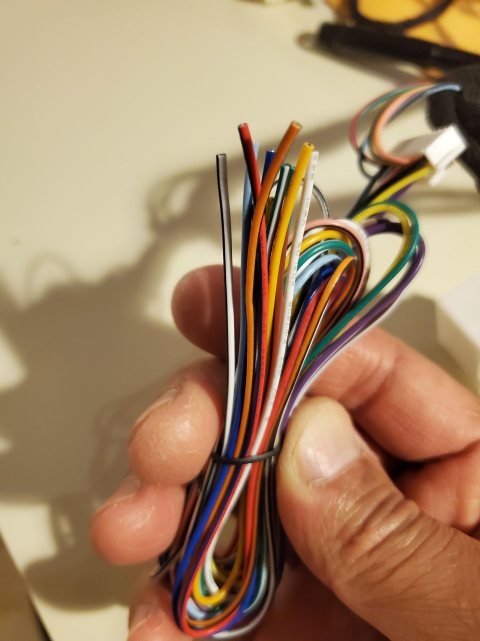

    Anyone know where these go lol this was supposed to be plug n play
