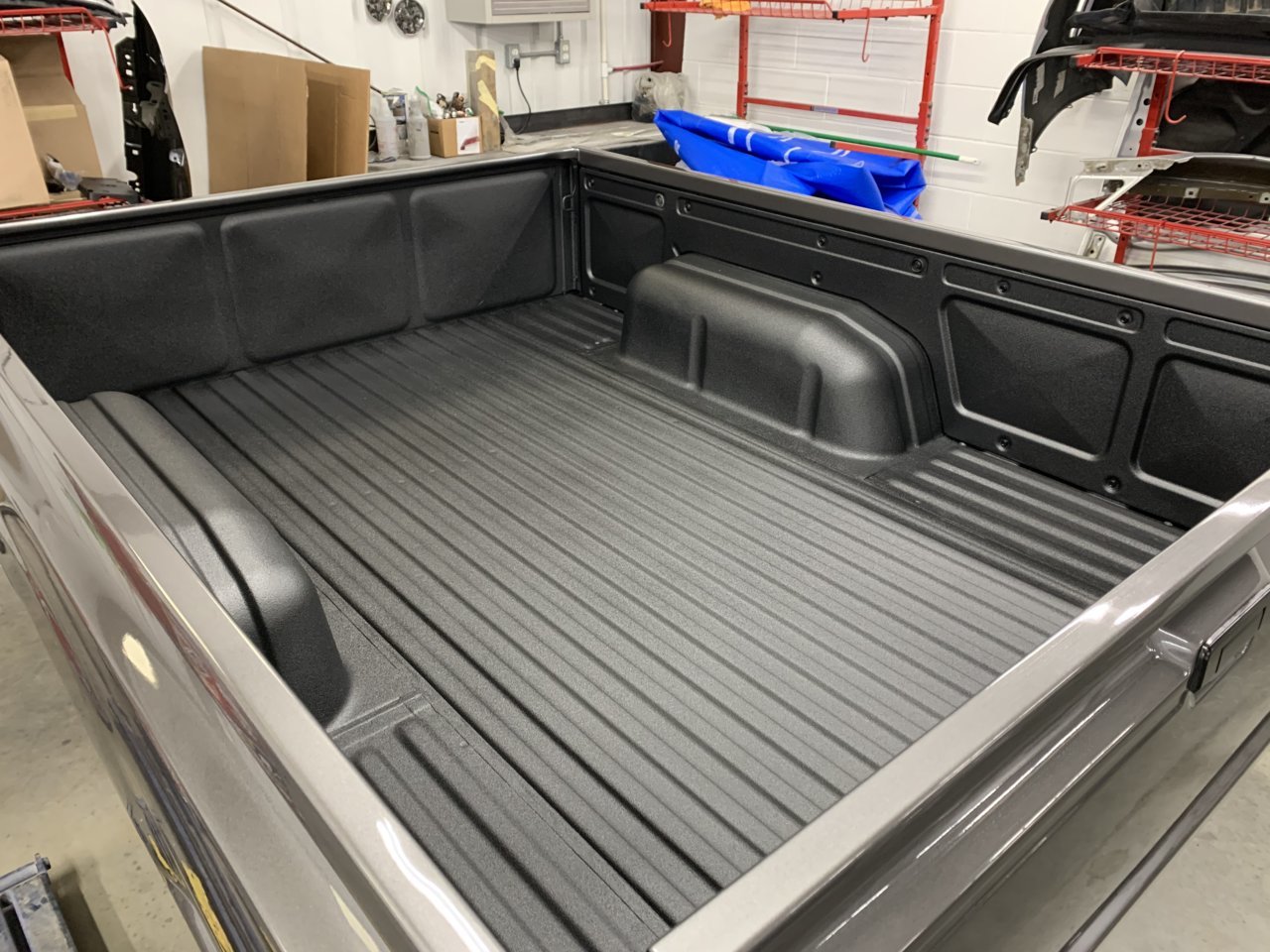

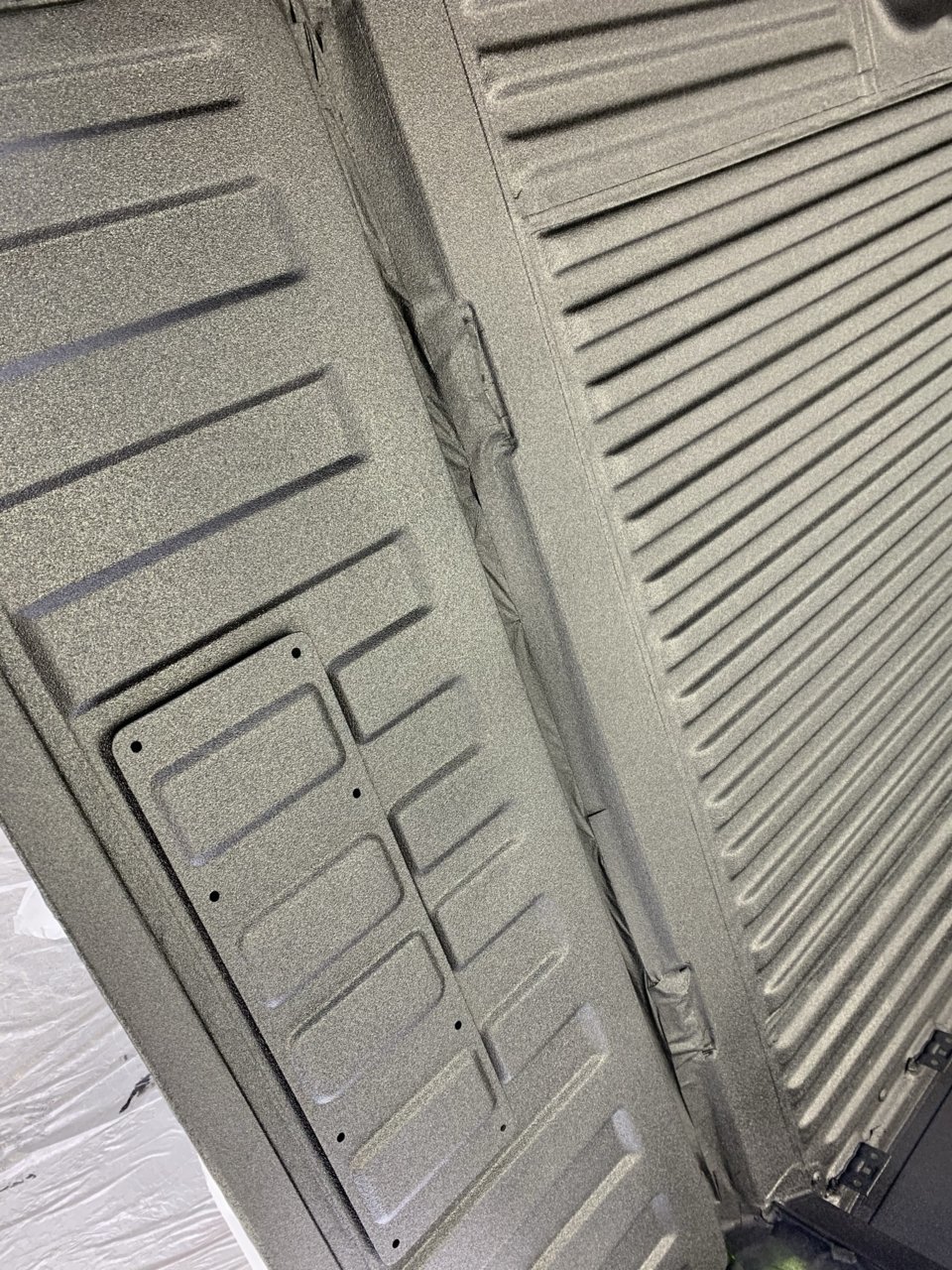

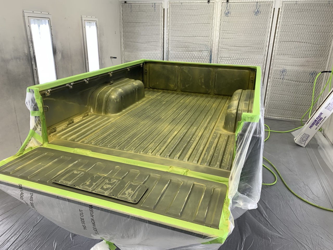

    I did the Raptor liner, sprayed in with their gun.
    14C525C7-D40B-4B78-9C2F-27B88D393AF6.jpg EB44D5A0-A7D1-44EA-BDA3-77221ECE5A55.jpg B4C1EB86-0D0E-41B5-8056-A3ECE3F52DB8.jpg

    Where the hell is the rest of the truck?!

    Lol, it’s a work in progress

    Nice job on the bed off ,DIY raptor liner. I will be doing mine this spring along with running boards and other odds and ends. Looks like you had big psi to atomize the coating maybe 40-60?. And an even overlap pattern with a 24 to 30” distance from the surface. possibly a drop coat to finish it off? Please give a tip or two.

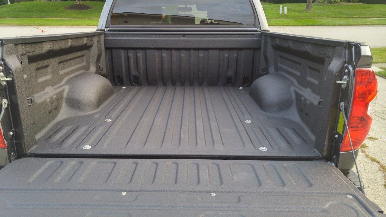

    MY BIL did his own with Raptor Liner and it came out pretty nice.
    Also - see if there is a Bullet Liner dealer near you. Same guy that invented Line-X developed Bullet.
    I had Bullet on my 2011 CM and have same on my 2016. Same look and feel as Line-X and the cost is not as much.
    Pic of my 2016 with BL.

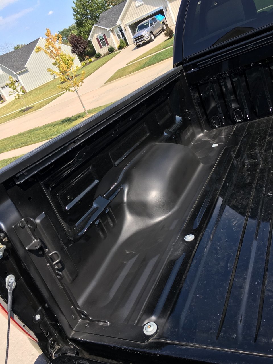

    I did my bed in Herculiner last summer. So far it’s holding up good. Like was said, prep is everything and a little time consuming. Make sure you wear rubber/latex gloves and old clothes when brushing and roller the coating on. That stuff is hard to get off your skin. This is the only pic I got of the bed liner job. The floor has a rubber Matt.080AC225-A207-4396-A669-4AC709940EC7.jpg

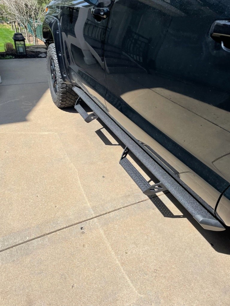

    Just had my predator steps that had failing paint after 3 years sprayed with bullet liner. Love them...

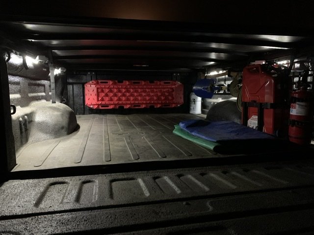

    My bed came lined from the factory, but I used Raptor liner cans to touch up the rhino lining that I scrapped off my sliders during offroading, the prep is important but it came out really well. Not quite as gritty as the rhino lining but I didnt mind since my scrapes were on the bottom of the sliders. I would definitely use it in my bed if it didnt come from the factory with the liner.
    If you are going to apply it to your bed, I would use a spray gun or roller, the cans are pretty messy, you have to hold it pretty far back and it gets everywhere. Luckily I used a bunch of old cardboard to sheild the white paint lol.
