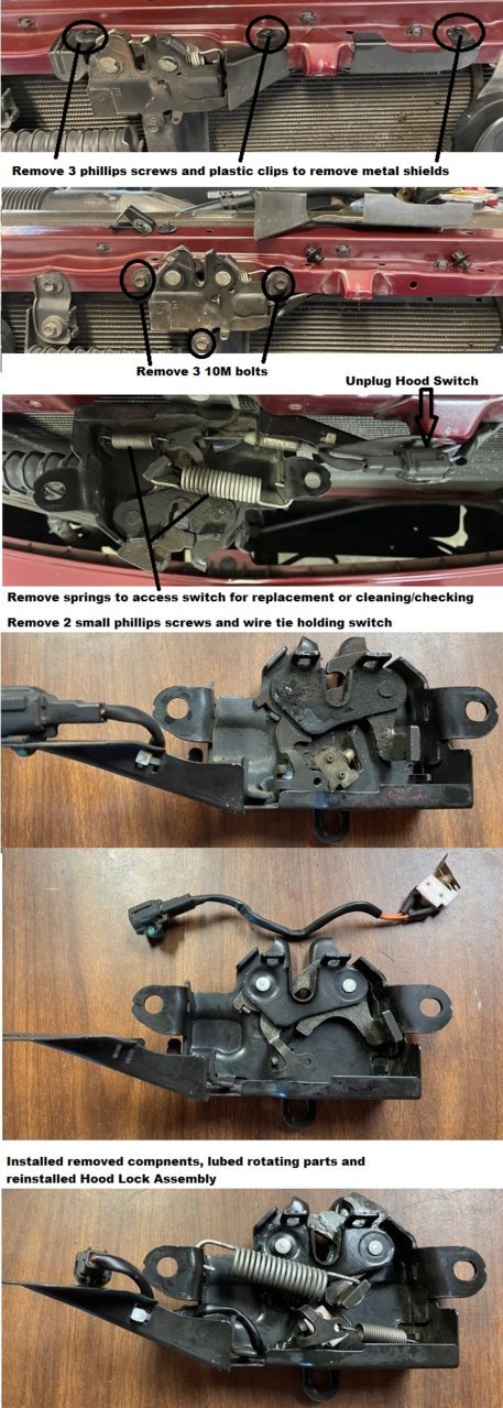

    What follows is the removal of the Theft Deterrent(TD) Hood Lock switch, location of the TD Horn and buzzer chirp maker(Piezo). This is not specific to all 1st Gens but is on my 04 DC Limited that came with Anti-Theft Sys w\Remote Keyless Entry as a Standard install IAW the Veh Specs/Sticker.

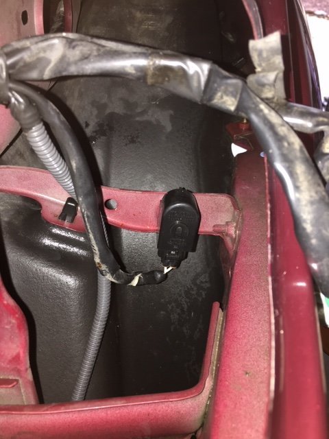

    Piezo Location: remove LH Head Lamp Assy and side marker light, looking straight in toward wheel

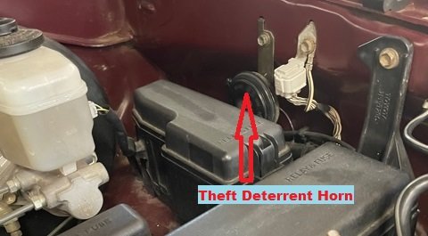

    Theft Deterrent Horn Location
