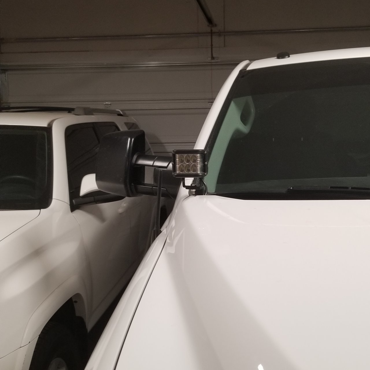

    Currently installing the ditch lights and need some input on most efficient angle to point the ditch lights.
    Should it be angled out or a little more straight? I’ve heard of hood glare, so wanting to see if I can avoid that.

    I suggest adjusting it on the trail to what works best for you.
    My personal opinion: people that have them pointed perfectly forward don't really use them for their intended purpose :)

    Mine are angled out about like that. Started with them straight out but that didn't do much good with headlights. I mainly use mine to light up those ditches to see deer.

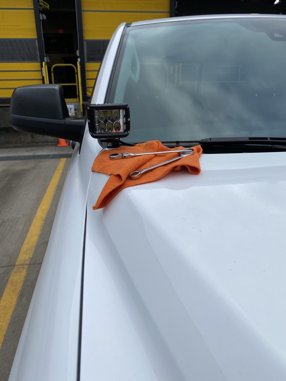

    Here’s the other side facing forward. This side doesn’t seem like it’ll serve its’ purpose though...

    are those the lights with the side projecting leds? Looks like they are installed on the wrong sides. Would explain some hood glare.

    Damn I just realized that.

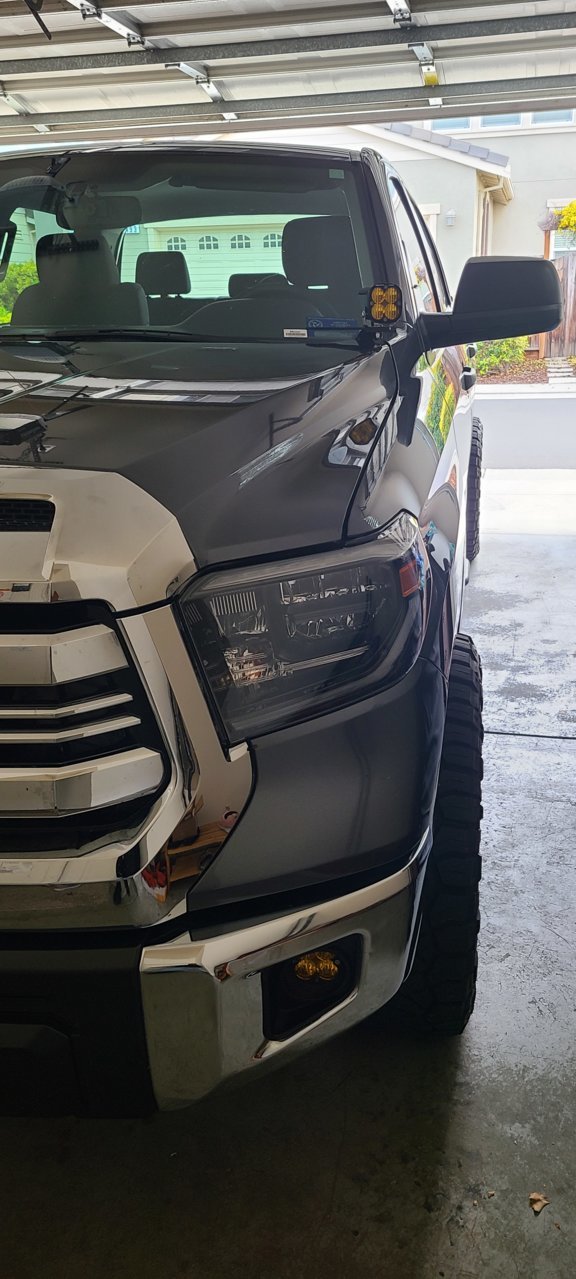

    I have mine set up to be even with my hi beams.20210317_154711.jpg 20210317_154705.jpg

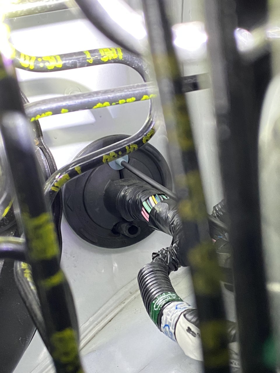

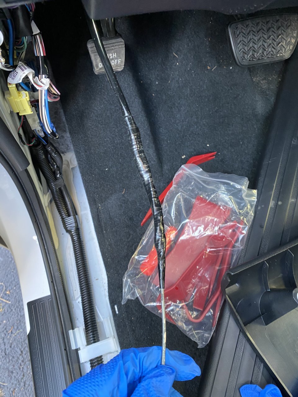

    Ok, how the heck are you guys getting the wiring through the nipple on the firewall? With a clothes hanger?
    I’m having the hardest time pulling it through.
    Any tips would be appreciated!
  11. Mar 17, 2021 at 4:15 PM
    Kanobi13
    Kanobi13 New Member
    Mar 27, 2018
    #13944
    1,258
    Cut tip off
    1UP likes this.
  12. Mar 17, 2021 at 4:24 PM
    APalmTree
    APalmTree Sometimes helpful
    Feb 23, 2020
    #43054
    810
    Brandon
    SW Washington
    2012 TRD Offroad White Crewmax 5.7L
    A few... Definitely more than 2
    Like Kanobi13 said, cut the tip-off and also make sure you are lined up with a hole inside the truck since the gromet is two separate layers of pretty thick rubber. A little drop of dish soap and a drop of water will also go a long way to lube up whatever you are pulling through and it should slide a lot easier.

    Should be in every tool box. Makes punching thru that rubber firewall grommet easy. Be careful to not punch it too far. Simply break the surface enough to feed the wire through. I'm giving myself 3 attaboy's.

    So I used a coat hangar this past week when running power to the 3W auto window module. But I was pushing through the door run, which the tool above won't help you with. For the nippel through the firewall I used a pair of snips couple with some difficult hand contortions.
    I'll have to do it all over again when I put in my VLED puddle lights in my mirrors... not looking forward to it.

    Good idea, but I think it was already tough as it is, with the limited amount of space in that area...
    The tool though.. punches a hole through that rubber grommet is what you’re saying?
    I’m thinking of the coat hanger method too, and to use some Wd-40 or dish soap to make it a little slippery. I was wrapping it around electrical tape, but needed something longer which I didn’t have at the moment. I’ll try again in this weekend since tomorrow is raining in my area ...

    Well, all it took was a little longer piece of metal and some good old WD-40 before it slid easily through the nipple opening.

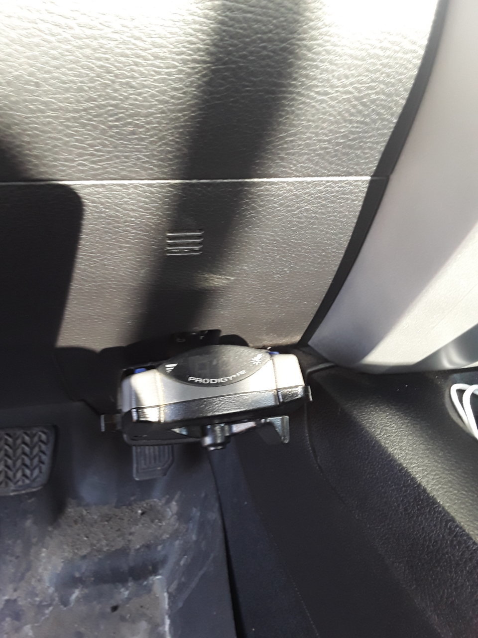

    You know, I also had that thought in mind as well! I ended up routing the switch over to the right side, on top of my trailer brake. Figure that side will possibly soon have some chase lights (for those tailgaters)...

    Post after pics please! I had a Prodigy 2 already installed in my 14 when I bought it.
