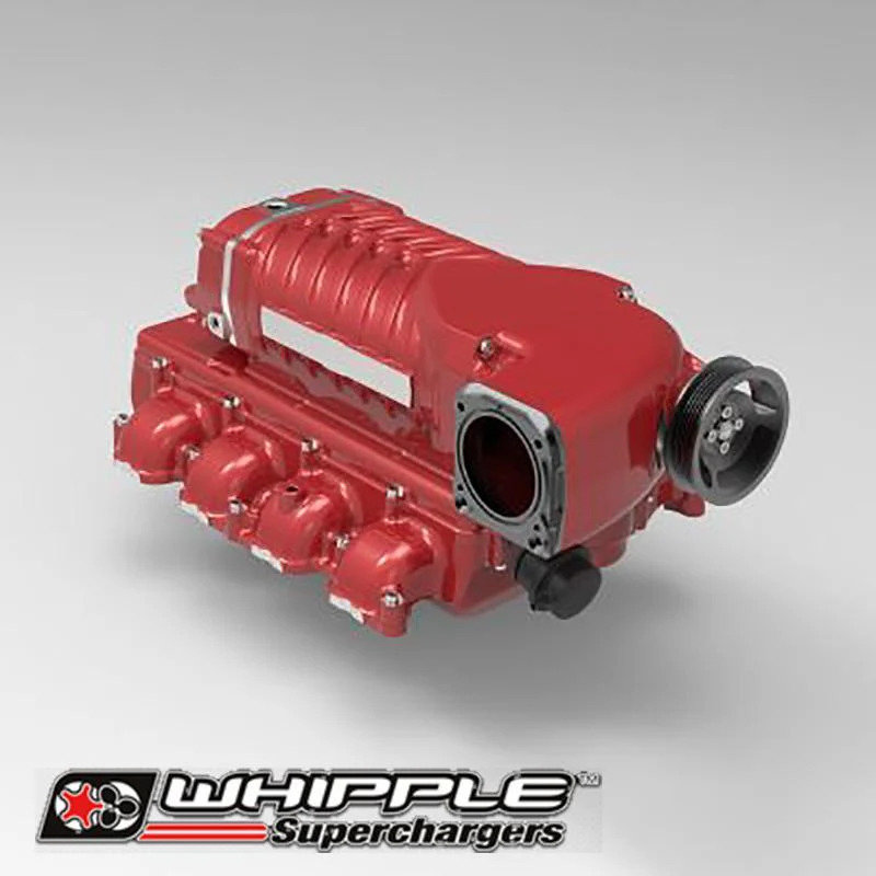

    This will fix it.

    A supercharger would probably solve it and fix a permanent smile on your face.
