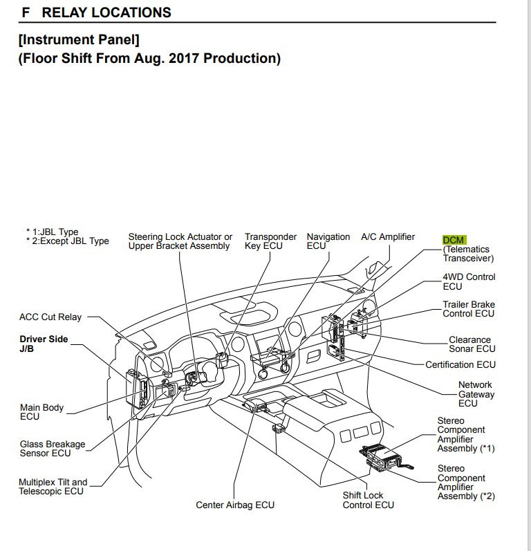

    DCM Location
    The DCM module is located on the right passenger side behind the glove box.
    (credit to @1lowlife from this thread for the image)
    Here is a close up image I took. The DCM is the box with the blue, gray, and white antenna cables running into it.

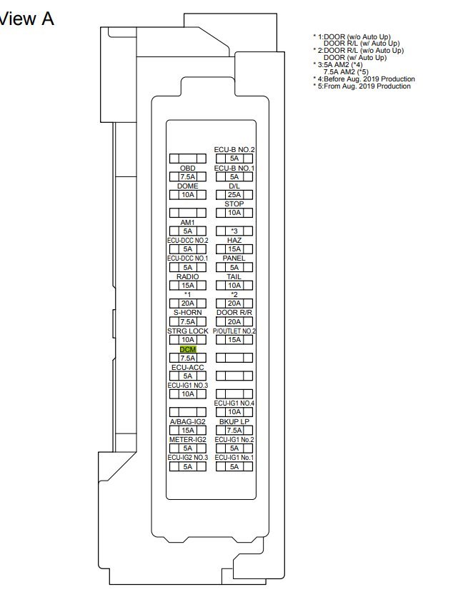

    The easiest and cheapest way to disable the DCM is to pull the DCM fuse and. You can find the appropriate fuse on the driver's side below the steering wheel. Here is a fuse diagram to help you find the correct one.
    (again, credit to @1lowlife from this thread for the image)
    The downside of this method is that if you pull the fuse, you will lose access to the OEM microphone. Yes, that's right. For unknown reasons - and maybe out of spite - Toyota runs your truck's microphone connection through the DCM. A solution might be installing an aftermarket head unit and microphone, but for those of us committed to staying as OEM as possible, see method 2.

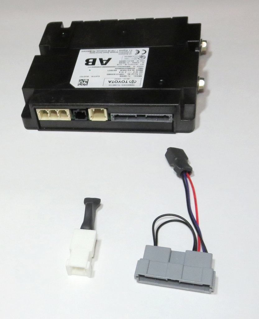

    Method 2: Bypass the microphone and unplug the DCM
    The next method is jumping the microphone connection and unplugging the DCM. This disables the DCM and leaves the OEM microphone intact. Some of your are probably handy enough with electronics to make the jump yourself, but for those of us who prefer something plug and play, AutoHarnessHouse.com has a bypass kit for $90. You can find it here.
    Credit: AutoHarnessHouse.com

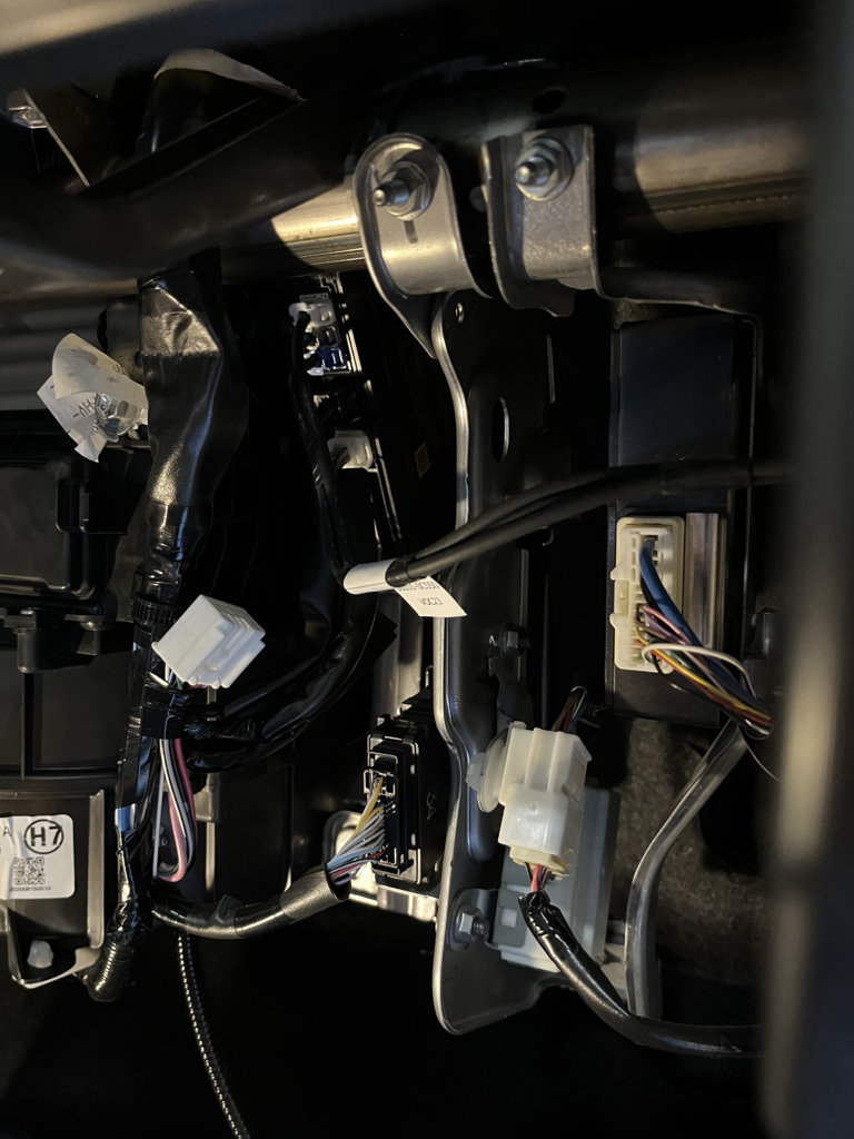

    All you need to do is access your DCM module and unplug the gray and white connections, then add the bypass modules from AutoHarnessHouse.com. Here is a picture of my bypassed cables.

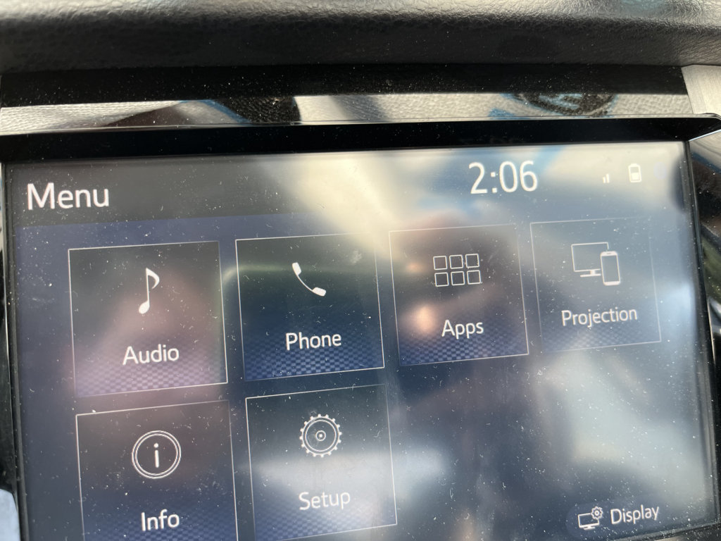

    Zip tie everything down to avoid rattles, reassemble the dash, and you should be good to go. The final tests are to see if your head unit displays the DCM notification or not and and if your microphone still works.
    Look Ma, no DCM!

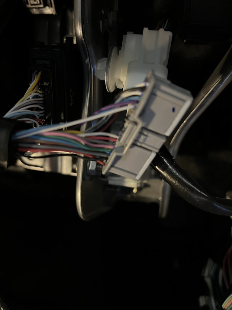

    Do you have any more pics of the grey connector to bypass for the microphone? IE pins and which wires you have to jump?
  3. Sep 1, 2025 at 8:36 PM
    DrRansom
    DrRansom [OP] New Member
    Jun 30, 2024
    #119192
    70
    Utah
    Silver Sky 2021 SR5 Tundra 4WD

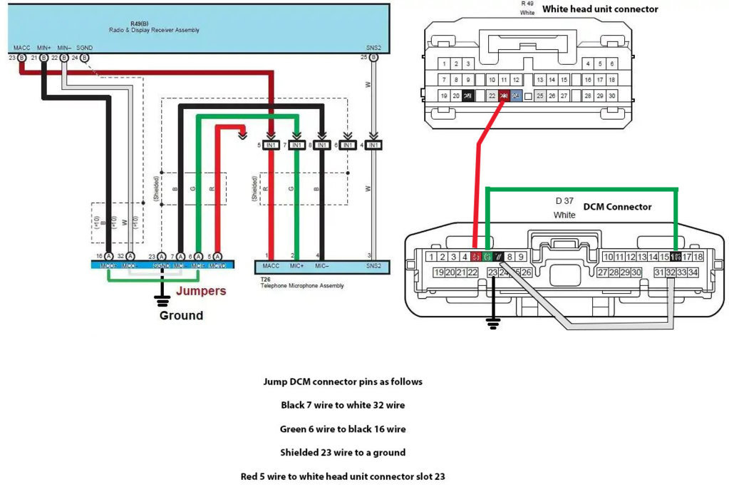

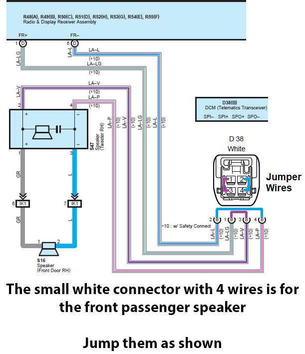

    Apologies, I should have taken more thorough pictures of that before closing everything up, but did not do so. Here is the best close up of the gray connection that I have.
    That said guaco.supreme over at tacomaworld gave instructiosn for how to jump the DCM in 3rd Gen Tacoma. I believe his instructions would be the same for a 2nd Gen Tundra. For your reference, I'm going to drop his diagrams below. That said, see his full write up on beginning on post #7 of this thread linked here.
    Credit: guaco.supreme at Tacomaworld
