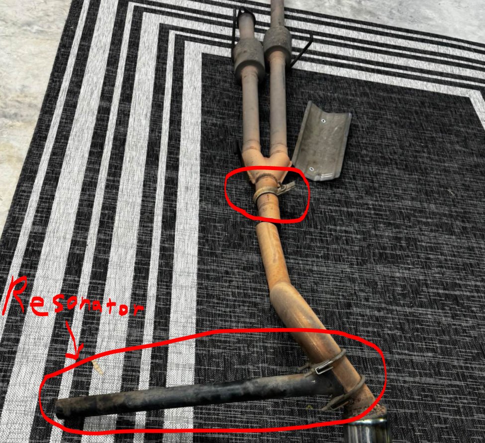

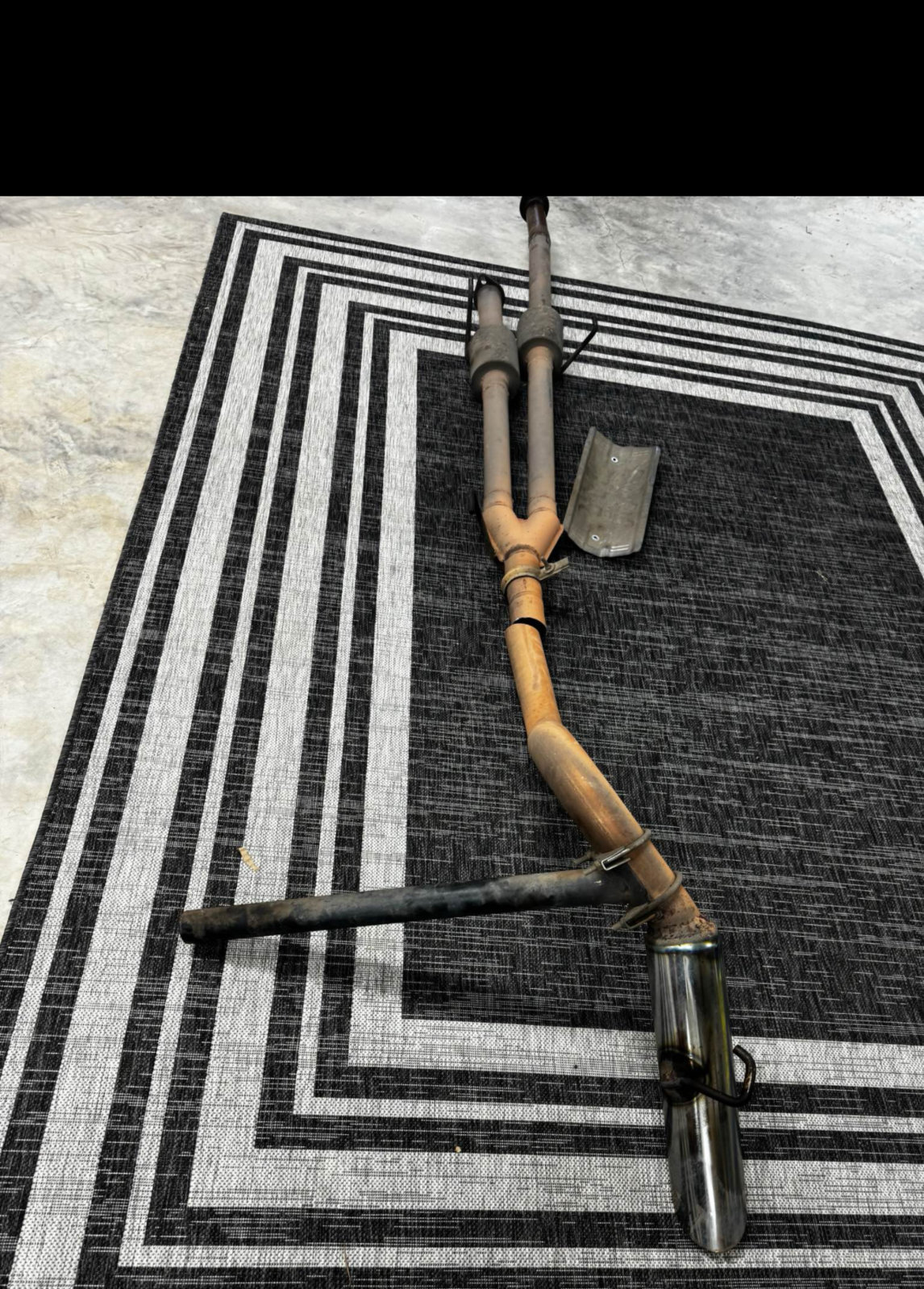

    Here is a picture

    Tell him you'll take it without the tailpipe for half the price then have an exhaust shop dump it.
    To answer your original question, yes that can be welded together. Take that clamp off and all you gotta do is take the tailpipe and small piece after the clamp to an exhaust shop.

    That's the stock pipe that was cut. The DD muffler is intact. This is a pic from DD's website. Notice that it ends right after the two pipes join.
    The little circle is where the DD joins the stock tailpipe with a clamp. You don't need the cut part because it's the same as the stock pipe already on your truck, BUT you do want the resonator.

    Looks like he couldn't get the V-band clamp off and just cut it idk. The stock one does seize up, I had to wrench the bolt and snap it so I could replace the clamp. Shop could weld that back in 5 minutes,

    Yar this one is good to go and it’s not the 07-09 version either. Assuming its not over like 500$ or so.

    OP, this is a perfectly good DD exhaust you came up on. Just negotiate a good deal with the seller and your good to go. You'll just need to get new flange gaskets. I believe Felpro is recommended(found at most auto parts stores).
