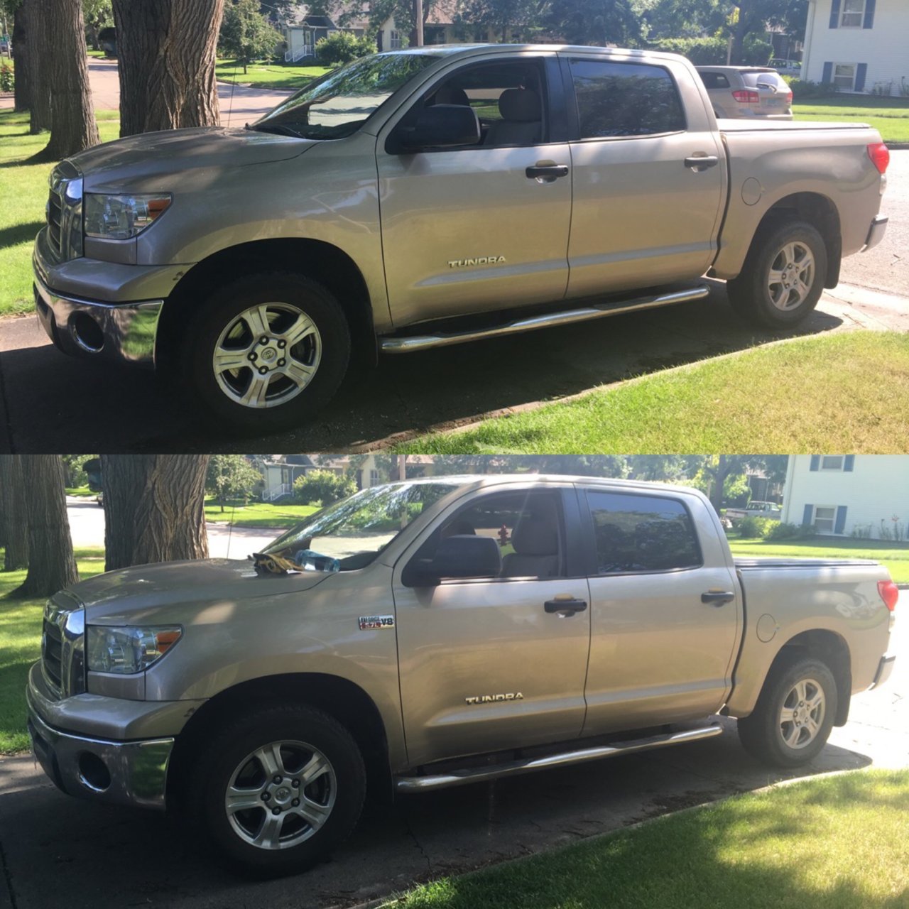

    Any negatives to installing two choachbuilder shims per side (for 1" of lift) and going to get an alignment afterwards?
    Do I need bump stop extensions? I'm thinking no, but considered putting a few washers under the factory stops.
    I am going for an "aggressively stock" look with 275/70/18 installed, and honestly, am on a tight budget with kids in daycare and don't need shocks/can't afford 5100's right now :)
    275/70/18 Nokian studded Hakkapellita LT2
    Debadged 5.7 iForce on summer rims, will upgrade to 275/70/18 duratracs.
