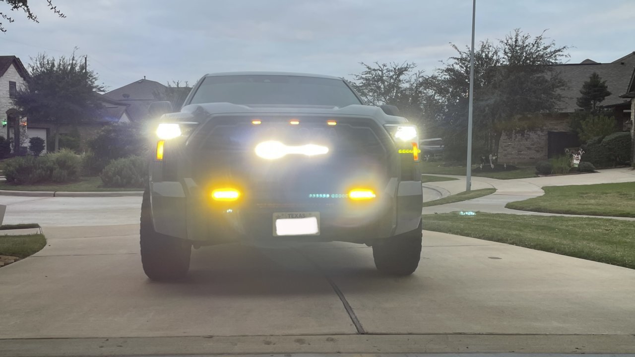

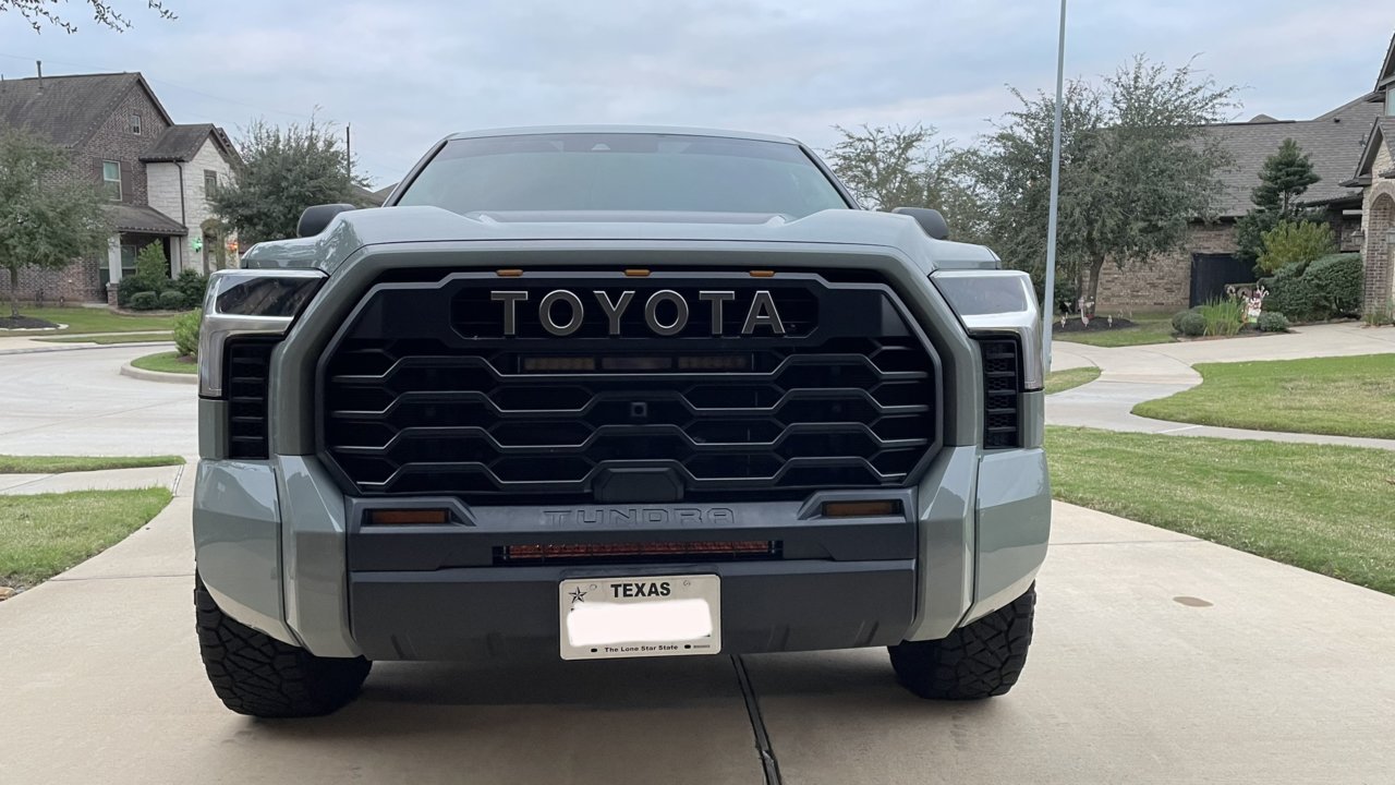

    Finally had time to install it...very straight forward. I was originally going to try to install it without removing the entire bumper but the screws for the bracket used a specific bit, forgot which...more on these screws in just a second
    Everything mounted up great and the light bar is very bright! I bought the Combo White but wanted to look a little more stealth with it off so I tinted the light bar.
    So the screws for the brackets....I'm not sure if I was doing something wrong but it did not work out for me. 3 out of the 4, did not feel like it "locked" in. Where I can let go of the bracket and it would just fall out so I had to scramble to find something that would fit...luckily I have a stash of some screws/bolts and was also able to utilize some that weren't used that came with the light bar

    Wiring is just like wiring up any other light. I already have a switch ready so I just wired it up to that :)
