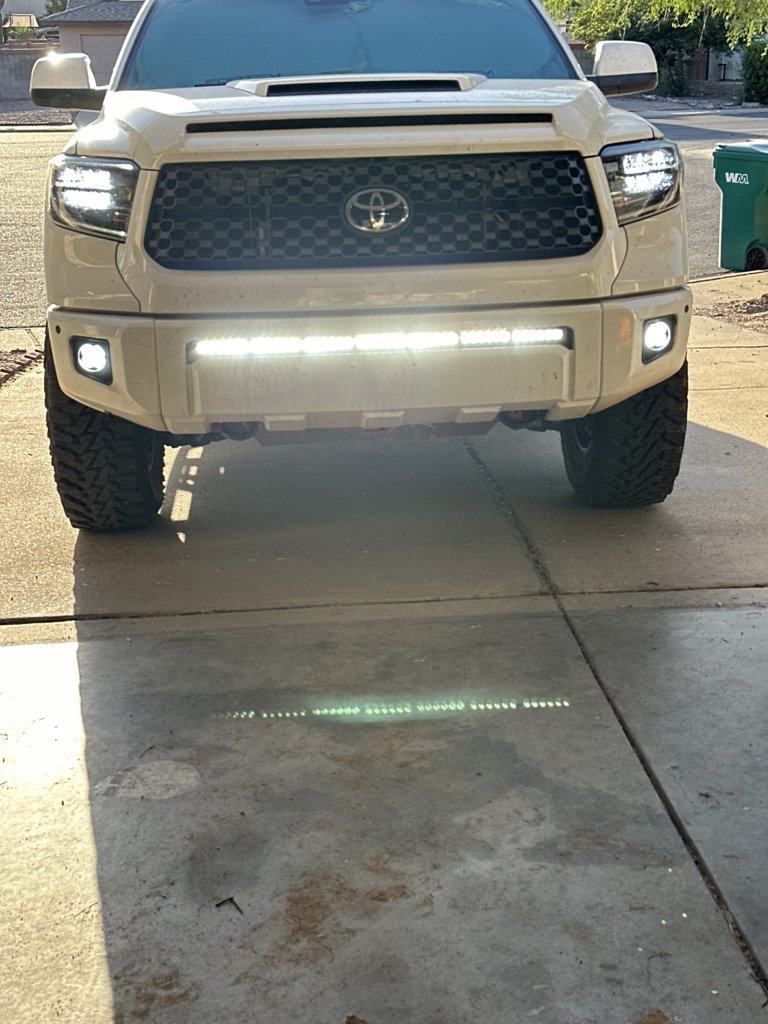

    I'm a little late to the party, but figured I'd add perspective. I have had the DD 42" bar for almost 6 years. I had the bar warrantied once, after I lost a section which then shorted out the entire bar. They stood behind their warranty wonderfully. I just last week finally upgraded to the Hotshot Offroad brackets, and I'm kicking myself for not finding out about them sooner. Night and day difference between the junk Diode brackets and the new Hotshots. I also just did the SS3 Pro fogs about a month ago. No complaints whatsoever, I'm so happy with them that I just ordered the SS3 Max's for my ditch lights, which according to the tracking should have showed up today.
