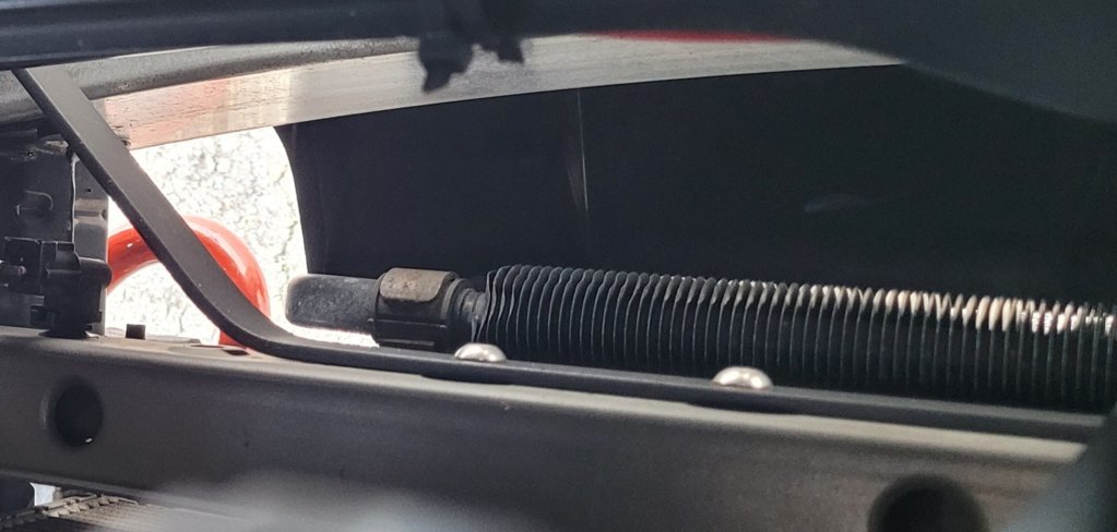

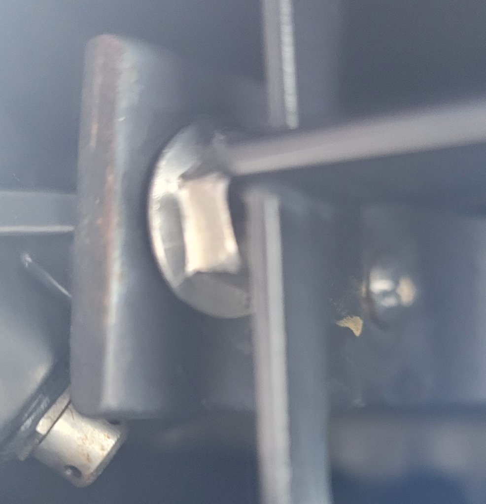

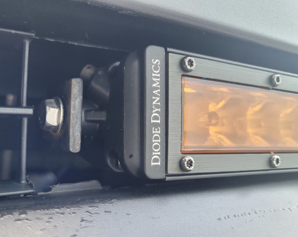

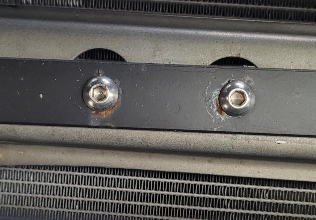

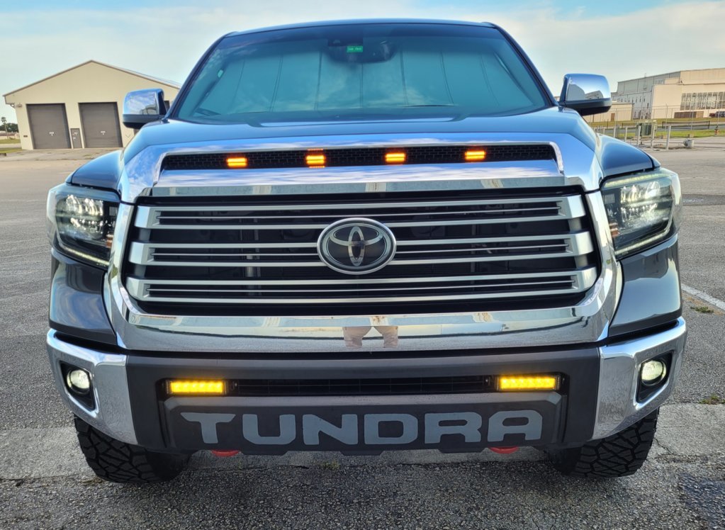

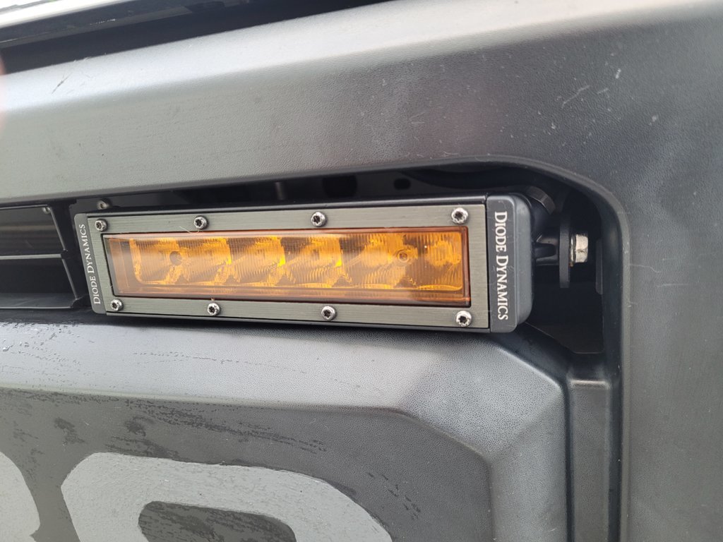

    Wanted Amber lights to fit in lower valance gap and did not want a full light bar. Lights are brighter than low beams (driving version vs. fog version). Parts ordered: Diode Dynamics Stage Series 6" SAE Amber Light Bar (pair), Stealth LED Light Bar Bracket Kit, and Light Duty Dual-Output 2-Pin Offroad Wiring Harness. I used the Bracket Kit for a full light bar for the outside mounts. I manufactured inside mounts from 1" flat bar from Lowes. The flat bar was easy as I all I had to do was bend them in a vise to form the shape I wanted, drill some bolt holes, and paint them. The bought brackets use existing frame bolts and the flat bar is simply bolted through existing holes in the frame with a flat bar on the backside so the bar is "clamped" to the frame. Did not have to drill any holes in the frame.
