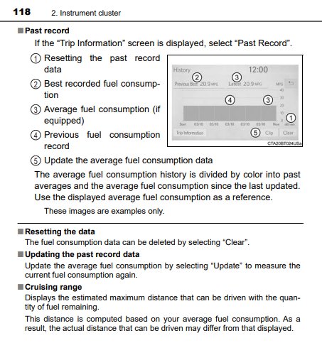

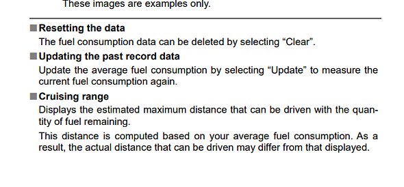

    The fact they disconnected the battery when they replaced it is why you have the issue as previously stated.
    Give a it few tanks of gas to recalculate everything..
    You don't have to disconnect the battery to reset it, just RTFM..
    Screenshot_2024-03-21_132908_6110e0f270c85ac3ca146bb10f00900f19181c19.pngScreenshot_2024-03-21_132918_a8d6e255ea61108f8b28330b8b21d5bed7d86b57.png

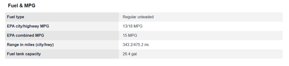

    Your fuel tank is 26.4 gallons, not 28..:eek2::thumbsup:
    Used 2014 Toyota Tundra Specs & Features | Edmunds
