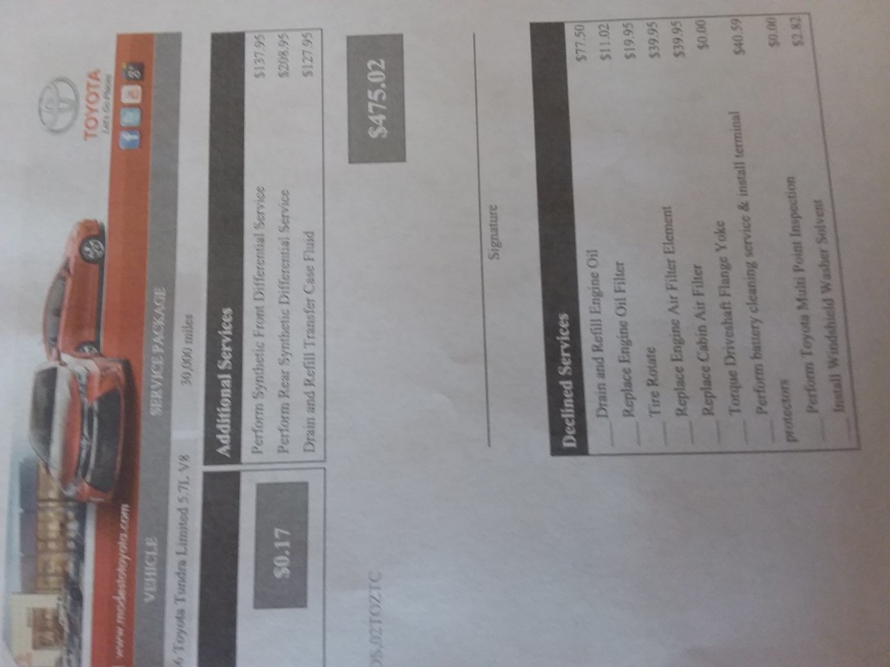

    FYI.. Dealership said 30k is severe service not standard. Quoted me $475*
    Told me to do it at 60k. Couldn't find anywhere in maintenance book where 30k is listed.
    Am I missing something?
    2016 CM/5.7/4.30/TRD ORP 4WD20180808_162843.jpg

    I just had mine done today at 40k. My truck is the same as yours minus the TRD.
    Front Diff $ 104.44
    Rear Diff $83.57
    Transfer Case $85.07
    Total $273.08

    For $475 they are putting the synthetic lube in the wrong rear end. :eek2:
    Yes, the transfer case oil for 3rd gens is a bit expensive, but
    Did they laugh an evil laugh when they gave you the quote?

    Anyone care to chime in on the change interval? 30k seems like gospel here, but Toyota says 60k and mine doesn't even remotely meet the severe use criteria (26k on a 2016, 15 lifetime 4wd miles, maybe same for dirt roads, 9-10k miles per year, garaged and washed religiously.

    Which oil do they show they used for the t-case? Ill bet 75w-xx

    Front and rear are too high IMHO
    T-case seems on point due to the 75w fluid.

    Page 41* in the maintenance and warranty guide

    I've seen INSPECT all the way to the end of the book. Change is a offroad/towing/HD application only.
    Am I nuts? Am I reading this correctly ?
