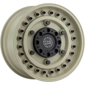

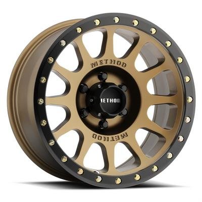

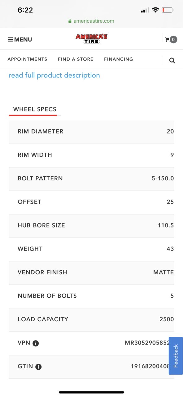

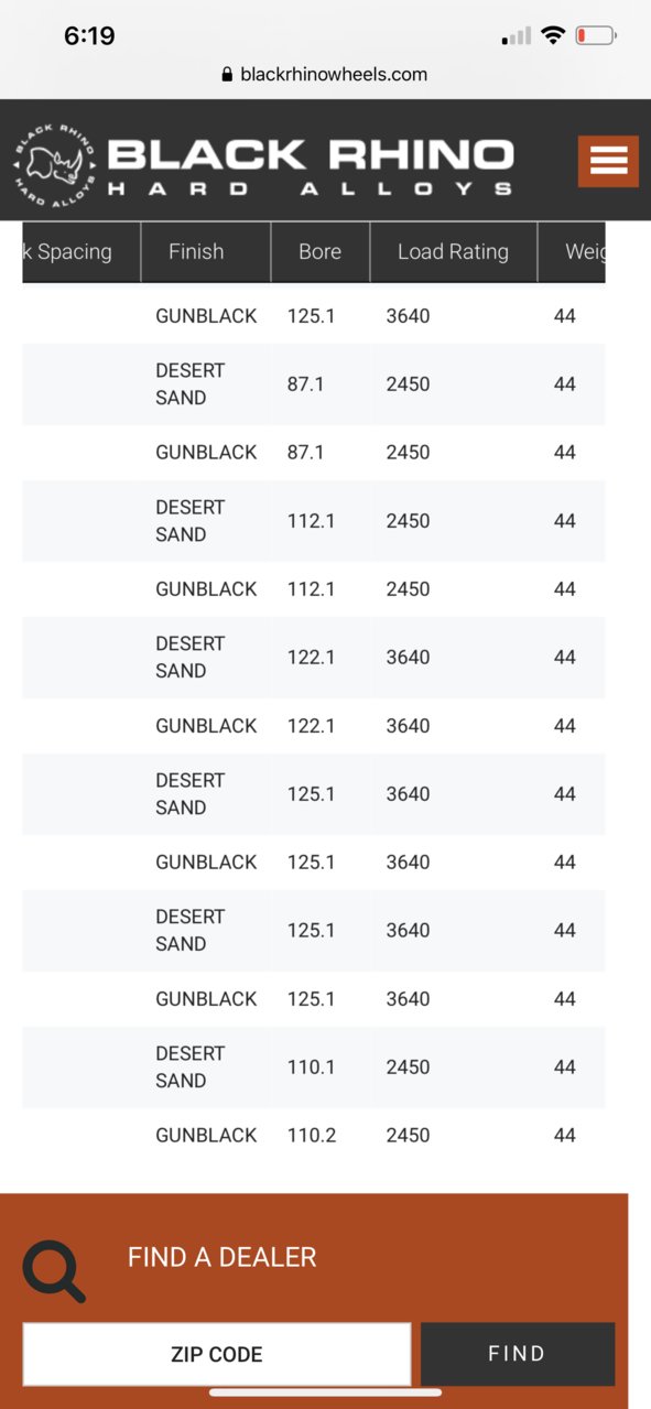

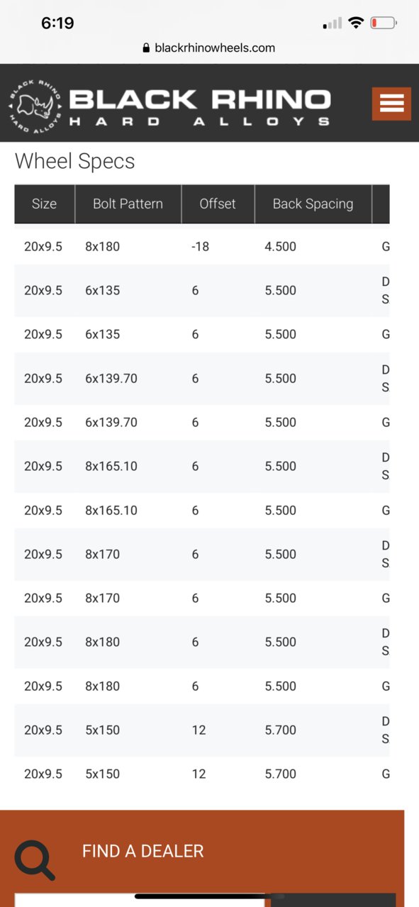

    So I have the method NV 305 in a 20x9. I’m looking at black rhino armory wheels. I see 2 differences. The black rhino are 20x9.5 and offset is 12. Offset for the method are 25. My question is what would the difference do on my truck. Will the wheel stick out further or so on?
    Pictures and specs included. Also let me know what would look better on my truck.

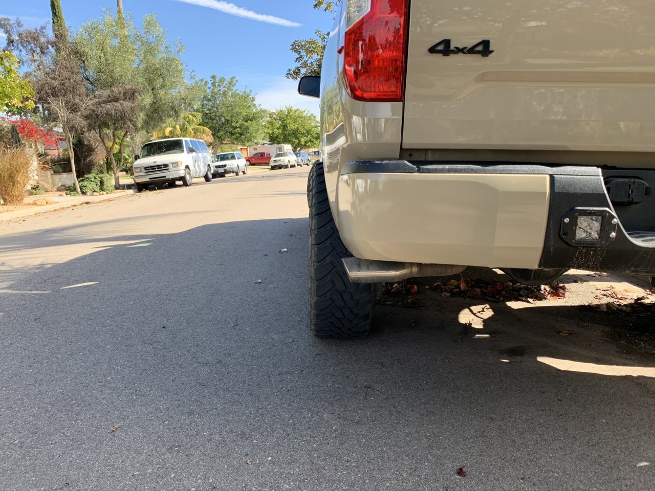

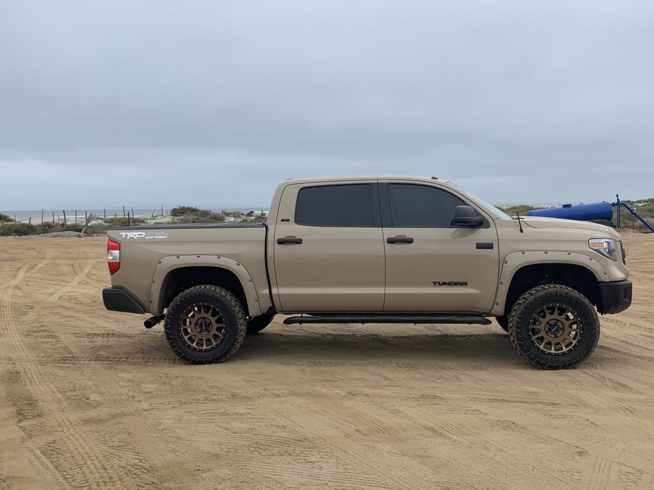

    What it looks like now.

    This says that the outside lip of the wheel will be 3/4” further out.

    P.S. I have a + 18 offset right now: nothing wrong with it, but I'd prefer the +12.

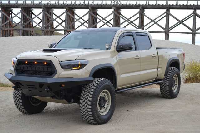

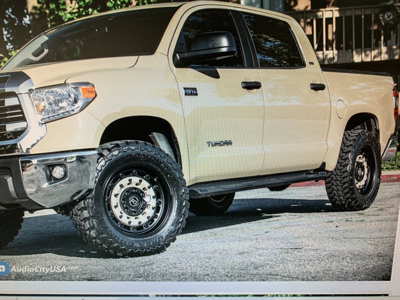

    I think the black rhinos would look great on your QS truck

    I think so would look like a military tank lol. But I’m not 100

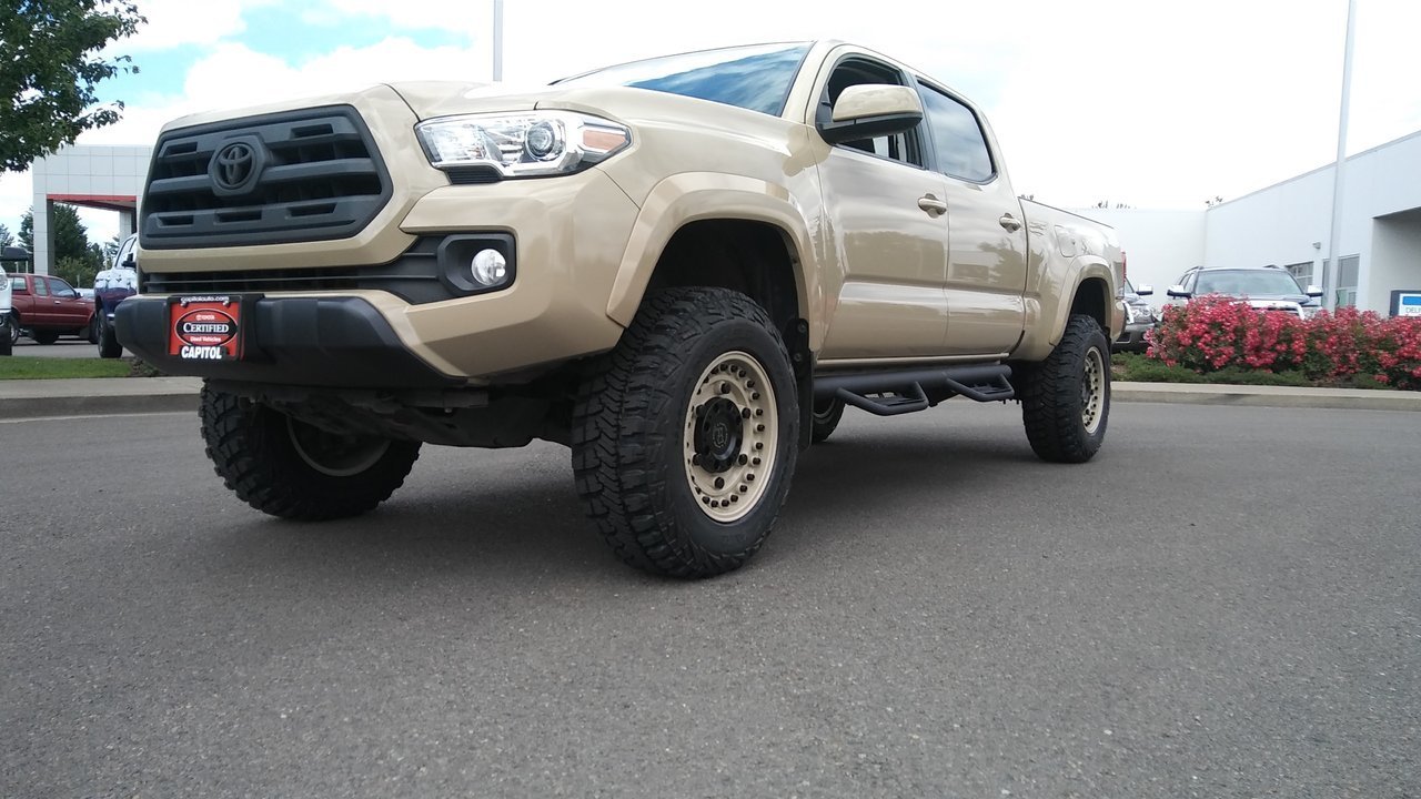

    I have seen someone run them on their QS, don't remember if it was a Tacoma or Tundra

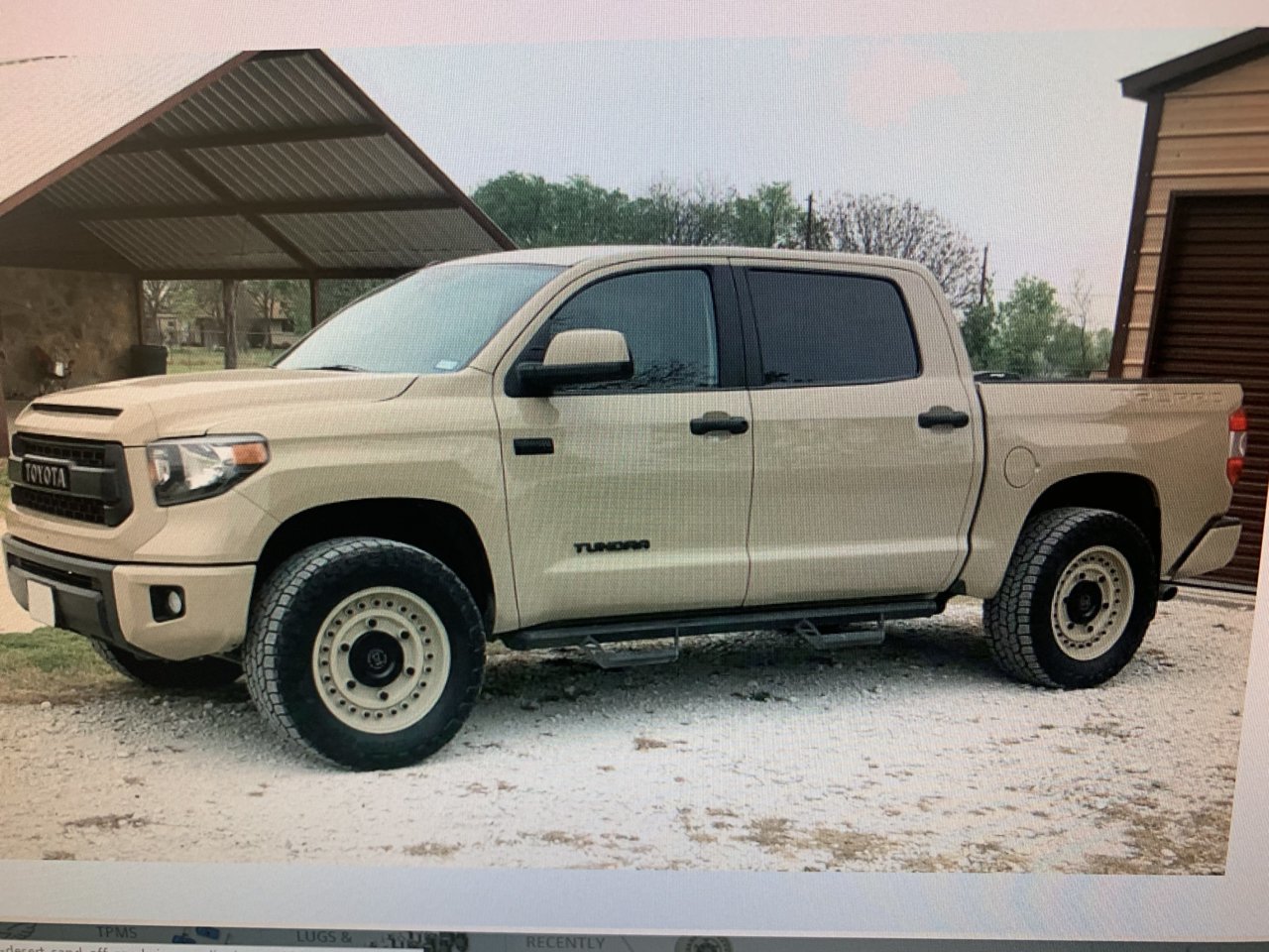

    I know @Grendel is running the Arsenal but his are more black then sand.

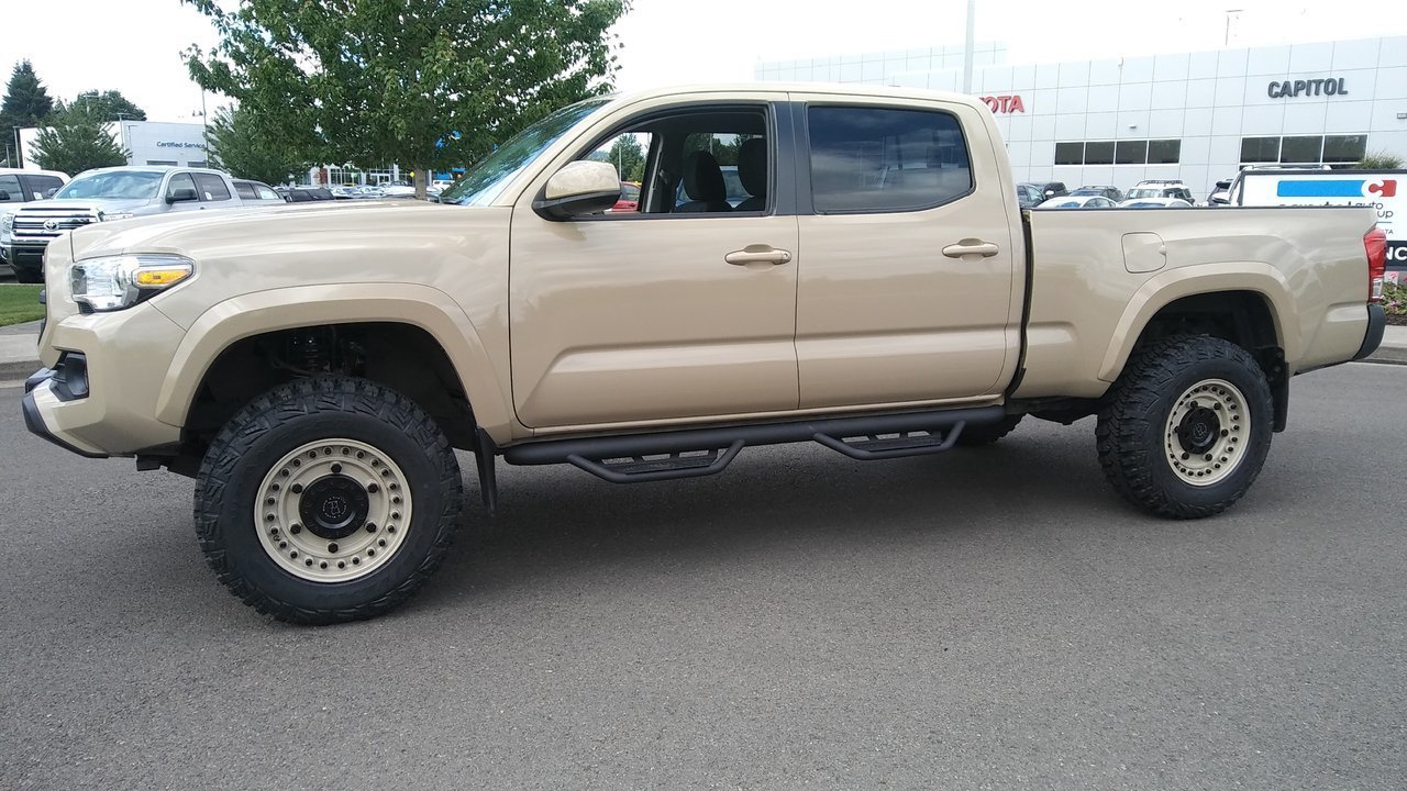

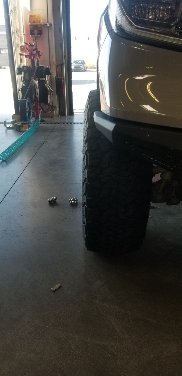

    Pic for reference on what 18x9 +12s look like without flares on 35s.20181120_151536.jpg

    The reality is taking 13mm less offset will bring wheel in .5 inch. Accounting for a .5 in wider wheel your "poke" should stay relatively the same.
    Edited to add that, applies if the half inch you gain is all to the outside.

    The Armory wheel is .5" wider and the offset is lower by 13mm compared to your current method wheels.
    Half the .5" will result in .25" sticking out more just on the width alone. Then add in the 13mm from the offset change (13mm is a hair over .5") results in a wheel/tire that'll stick out approximately .75" more than what you have now.
    This is a fun tool to use and visualize the change - A little added imagery to show how offset affects your wheel positioning.
    The lower the offset the further the wheel and tire will stick out.
