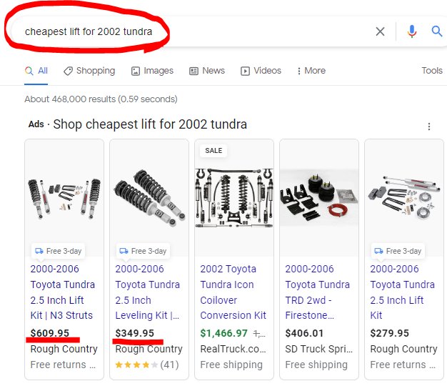

    Even by RC standards that is the cheap kit. See image below. @shifty` wasn't being elitist or trying to belittle your budget. We all understand that everyone doesn't have a huge chunk of expendable income for mods, and there's nothing wrong with that.
    I promise you, his "bashing" of RC was only meant as a good intentioned warning that you may run into problems with that kit, and him telling you that you didn't need the diff drop was because your questions weren't phrased in way that conveyed your intention. It came off as a newbie type question about how much of a drop you needed, so he answered it appropriately for that interpretation.
    You don't need to be defensive, because he was doing his best to help you out. If you had explained a little more I know he would help with any knowledge he has on the situation. Something like "I realize the RC kit isn't the fanciest or best lift, but it fit my budget and I'm having good results so far. To clarify, I know I don't need a diff drop, but I'm thinking that I'd like to try and reduce strain on components if possible."
    The only time any of the first gen guys are going to dog on your build is if you have a 2007+ truck. Ask me how I know. :p
